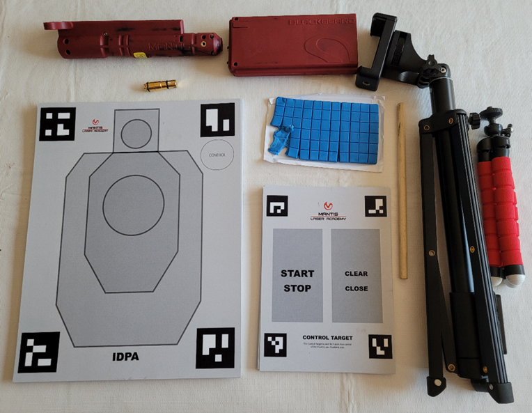

Blackbeard and Laser Academy Kits​
Laser Academy kit gives you everything needed to run your pistol with the phone app. It contains:
  • Full Access code to Mantis Laser Academy
  • Pink Rhino laser in 9x19 (or whatever cartridge you choose)
  • Set of 5"x7" Smart Targets
  • Set of 8"x11 Smart Targets
  • Mini tripod and phone holder
  • Large tripod and phone holder
  • Laser cartridge extraction stick
  • Poster tack
  • A set of target stand holders (not shown)
  • Carrying cases (not shown)
The Laser Academy kit includes a variety of standard target types (IPSC, IDPA, Hostage, Bullseye, etc…). However, each target has a unique image recognition pattern on each of the 4 corners that allows the phone application to automatically detect the target and know where the scoring zones are. The application can do this on multiple targets at the same time. Mantis refers to these targets as “smart targets”. There is also a control target that allows you to clear the shots and starts/stop the shot timer by shooting at one of the two boxes on it. Each target also has a control circle that lets you start and stop the shot timer by shooting it with the laser. The phone app has several lessons and training drills built-into it. These include basic things like bullseye shooting and timed shots from the sound of a buzzer.

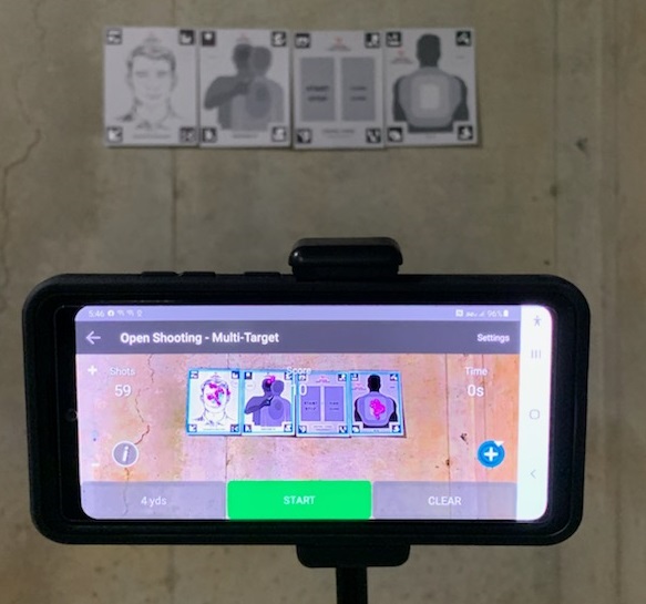

Phone app auto-detecting multiple smart targets​
The application calls out the score after each shot in a normal human voice, so the user isn’t required to continuously look at the phone to know if they’re making good hits. This is nice when practicing from across the room or down a long hallway as the phone needs to be relatively close to the target(s), so you can’t always see it from your firing point.
Sound effects include both gun shots and brass hitting the ground. I found this made training sessions a lot more fun and engaging. I think this feature would be especially beneficial with younger shooters that would normally find any kind of dry fire practice boring after a few minutes. This makes practicing more like a video game.
Other targets can also be used and the app has the functionality to assign shapes to if for scoring zones. However, unlike the included targets with the patterns in the corners, these scoring zones do not automatically get assigned to the target. You have to move them around on the image of manually. This means that if the target or phone gets moved, the scoring zone is off. Since the applications clearly has the ability to detect shapes, it would be a beneficial feature if the application could auto detect scoring zones on targets and if the user could save the values for the various scoring zones. This is functionality Mantis should really add.

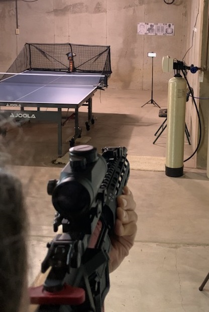

After using both the pistol system and the Blackbeard system for several weeks doing stationary dry fire drills, I felt like the system had a lot of potential that wasn’t being taken advantage of. The advertising and many of the reviews I’d seen seemed focus solely on stationary shooting drills, developing the fundamentals and holster draws. I could see a lot of uses for the system for practicing more advanced things.
The system has many benefits beyond being able to save money on ammunition doing basic practice during the current ammunition shortage. I found that it allowed me to practice things that I couldn’t practice easily on a typical public shooting range (which is all that is available locally). Even when ammunition is inexpensive and plentiful, many ranges don’t allow any kind of dynamic shooting outside of a sanctioned IDPA or IPSC match (for liability reasons). And even when they allow those matches, some will disallow shots to be fires while on the move. Finding a place to practice more advanced drill (in a way that provides hit feedback) is not always easy for many of us.

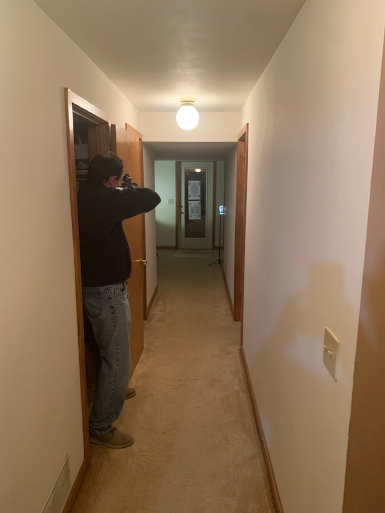

Targets on an interior door at the end of a long hallway​
We also practiced advancing while using the doorways as cover, taking snap shots from them and firing as we transitioned between them. Some of the participants had never practiced shooting weak side with a rifle. However, this was the only way to engage the target from some of the shooting positions without completely exposing one’s self. It’s a skill that many people neglect to practice. Hit feedback is important when developing this skill as eye position can affect the point of impact, particularly when some of the less expensive optics are used.
Another interesting use of the system was room clearing. We took turns setting up the half size IDPA smart target(s) and phone in different rooms and having the others do blind room clearing drills with the pistol and the Blackbeard equipped AR. The app’s ability to automatically calibrate for one or more smart targets in a matter of seconds made repositioning the targets in different rooms and varying the number of targets a snap.
  • Poster tack
In order to further evaluate some of my training use ideas, I performed several training sessions with different groups of friends, with wide variety of shooting skills and experience. In one session, we placed one of my blown-up half size IDPA smart target on an interior door at the end of a long hallway that had several doorways on each side. We then proceeded to practices firing on the move while advancing down the hallway. This was done with both the pistol laser and the Blackbeard system. The Blackbeard’s resetting trigger was better suited for this, but there was still value in practicing with the pistol. It didn’t take long for a buddy with no experience firing on the move to develop the skill. He went from only being able to hit the target 50 percent of the time while moving at a slow walking pace to being able to hold keep his bullets on it while advancing quite rapidly. Holding the half-sized IPSC target was roughly equivalent to holding the C zone in a full sized target. I feel like this application was a much better use of the Blackbeard paired with the Laser Academy application as the hit feedback was really beneficial.
