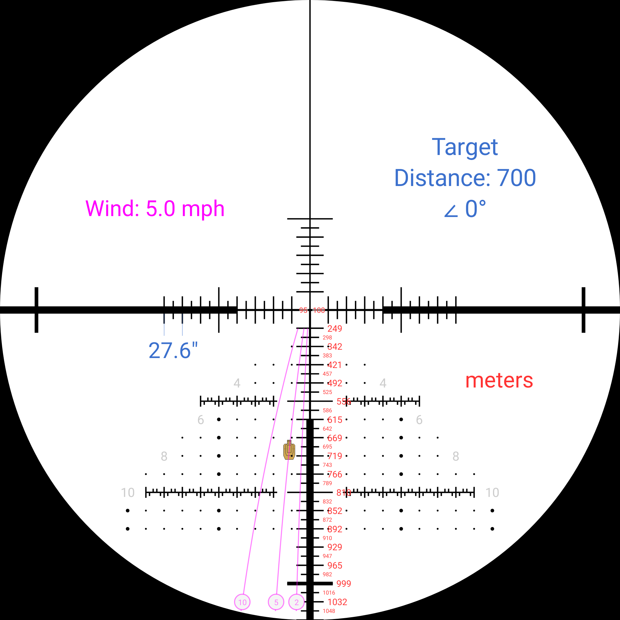

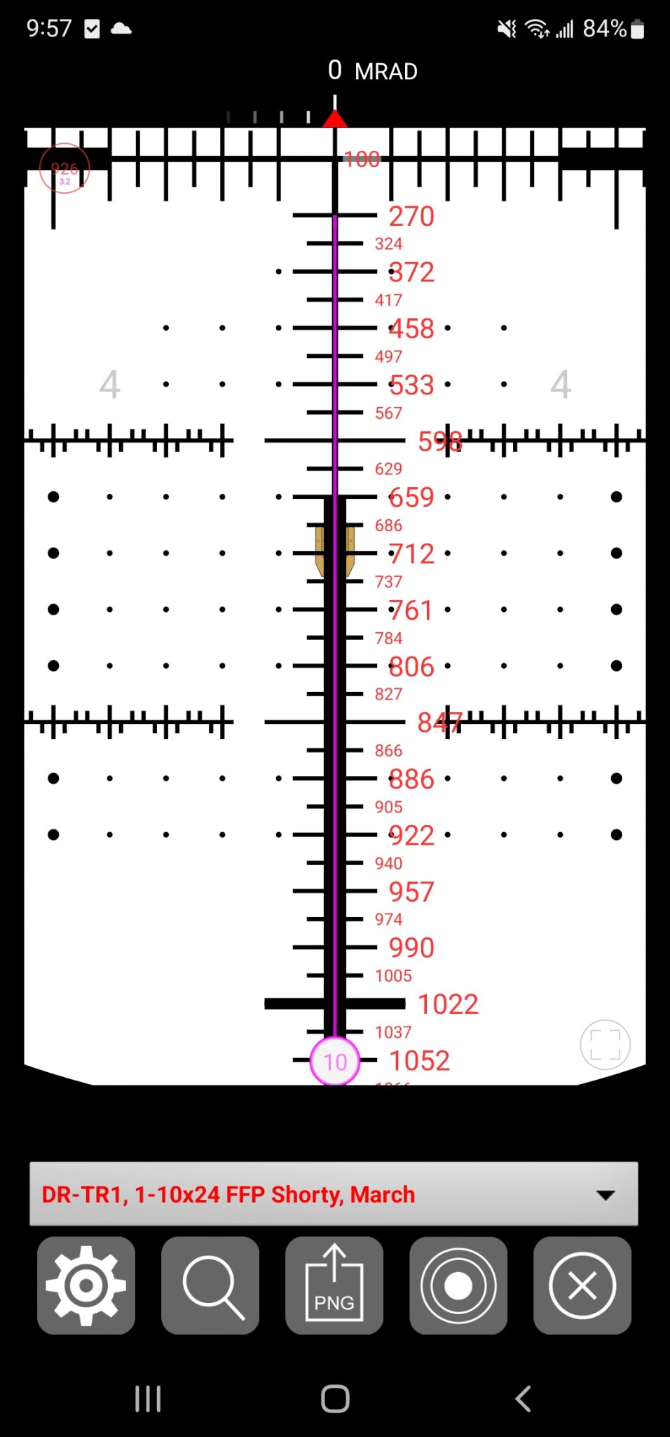

Target at 700
Looks good to me, since you presumably will be holding for wind. This is with just 5mph wind at 700M, high elevation.

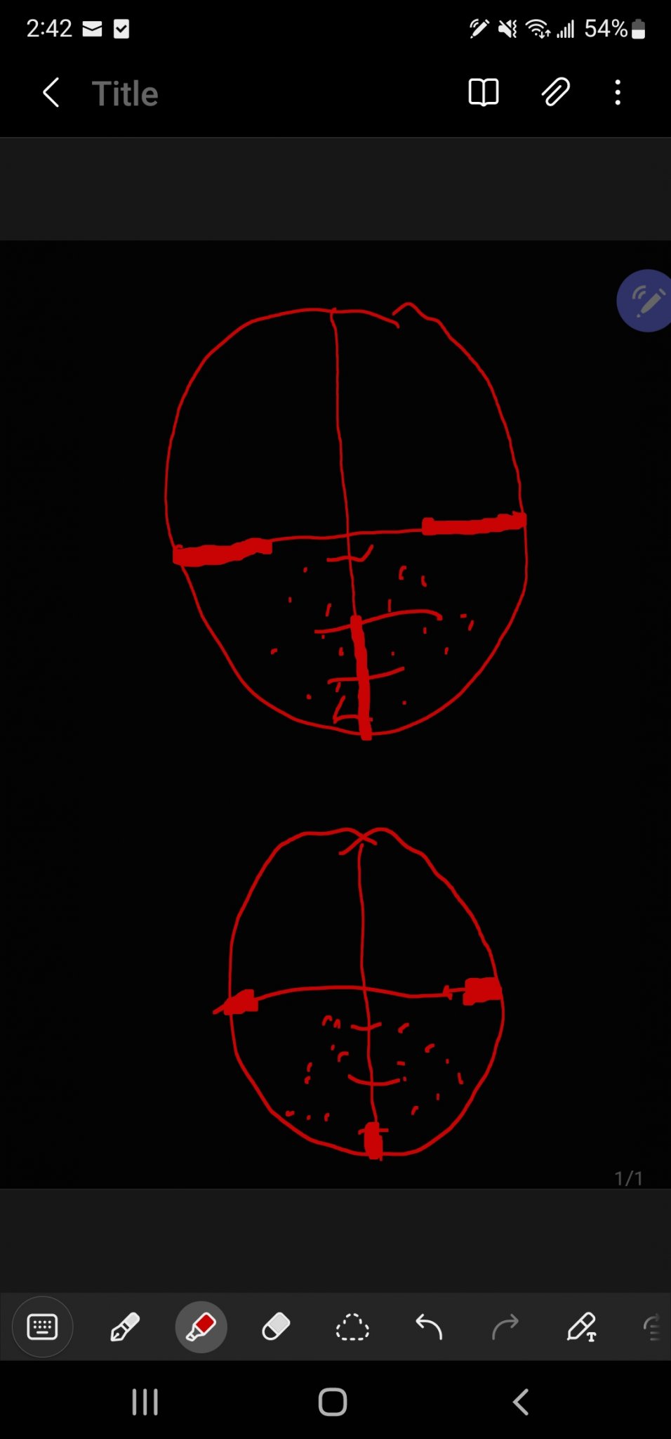

The crosshairs would still be visible at 1x. In fact the 1x sight picture would remain exactly the same. Under mag the thick posts would move away leaving only the thin center line.
Basically this shitty potato drawing. Represents Max mag @Happiness Is A Warm Gun top is current with thiccc lines in second. The bottom is a poor reputation of 1st

I see what you are saying now. As crazy as it sounds for any other company, you could try emailing March with your comments and see what they say back. We know they listen!

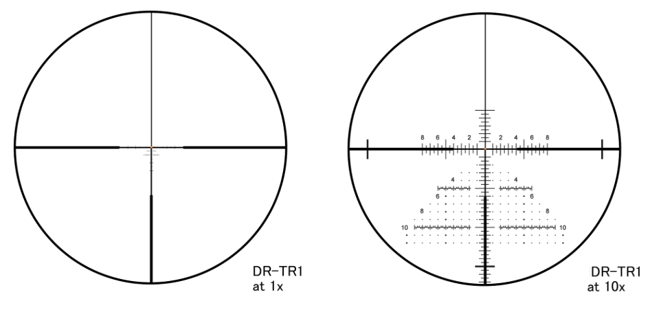

For those that are running one, how does the DR-TR1 reticle look behind the optic?
It looks like it may be a little busy, but possibly not?
The reticle is my only complaint with the optic. It's not bad but I find lpvo to be more suited for the 'hits on target' not 'hits in a specific spot on target' and was quicker with the fc-dmx. The March reticles are a bit too much on the precision side for me.

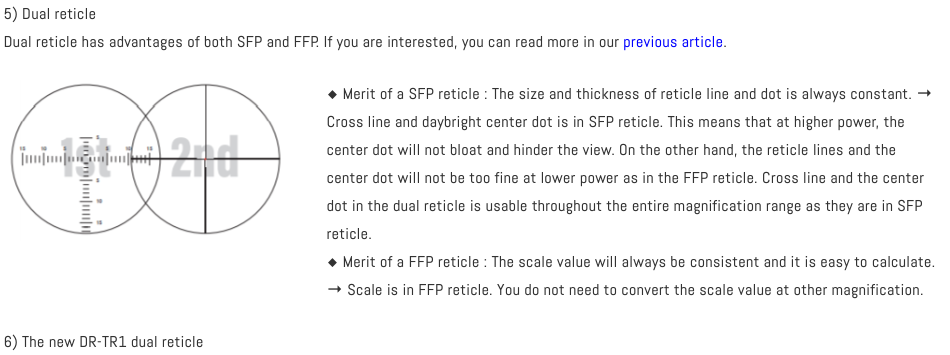

Color me confused about your most recent statement. The dual focal plane (DR-TR1) presents a very simple reticle at 1X . The reticle in the FFP doesn't really become apparent until you reach about 4X and at that magnification, it is not obtrusive at all. It comes into its own at about 6X and grows from there.
I don't use LPVO's. At my age, I don't play those games for which the LPVOs are most suited, so you will have to excuse my ignorance. I would think that for your "hits on target", your LPVO would be set at less than 4X and probably closer to 1X or so, where the Dual Focal Plane only really presents a straight crosshair with the illuminated central dot, in other words, perfect for your stated needs. If you decide to crank up the magnification to obtain "hits in a specific spot on target", that's when the FFP portion of the reticle comes into play to assist you in this endeavor.
In other words, straight crosshair with dot when used for "hits on target" and more precise reticle at higher mags for the "hits in a specific spot on target." This is the inherent concept of the dual reticle and it's what this optics does, and does very well.
I think you're getting hung up on the images above, at 1X and 10X. There's a whole range between those two magnifications.
Reactions: RayDBonz

Ok. I think I'm starting to catch your drift. I'm sure you are aware there are 2 DFP reticles available for this riflescope: The DR-TR1F, which is the one with the tree reticle in the FFP, and the DR-1F, which has a simpler crosshair in the FFP.
Look at the reticles.
I'm aware and have trigger time on the tree. It's an OK reticle. Excellent idea just mediocre execution
"Mediocre execution"? Are you kidding me? There are very few dual plane reticles because they require very high manufacturing standards. Certainly beyond "mediocre execution."
I get it, you have decided you do not like the tree reticle. This is exactly why there are two reticles available for this riflescope. Now if you think the tree reticle could be improved, it would be good to make specific suggestions.
