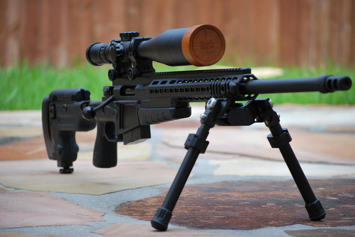

I am not 100% sure but if I'm not mistaken Jim Kelbly(The only March distributor in the US) will not only warranty these scopes past the 5 year Warranty but claims if you are not satisfied with your purchase simply return it, again this was told to me when I was buying my 5-40 and I'm not sure if it is a standard sales procedure. Not sure about the 3-24 but my 5-40's sharpness.....to me and IMO.....is second to none and I was able to compare to PMII and Steiner 5-25. So far out to 500yards did not need to go past 20x. The FML-1 floating dot reticle is for me most comfortable to use. Remember there are no 2 sets of eyes alike so what you or anyone else might see through a scope my not be what I see, and vice versa.
To add I chose the MOA version in which the reticle was 1/4 moa but I had the option to choose 1/8 MOA turrets. Some don't like that, stating it takes too much to dial but I don't see it like that. Turrets are loud, crisp and very easy to read and dial with a very simple operating zero stop. This scope can be easily used for military and comp.
