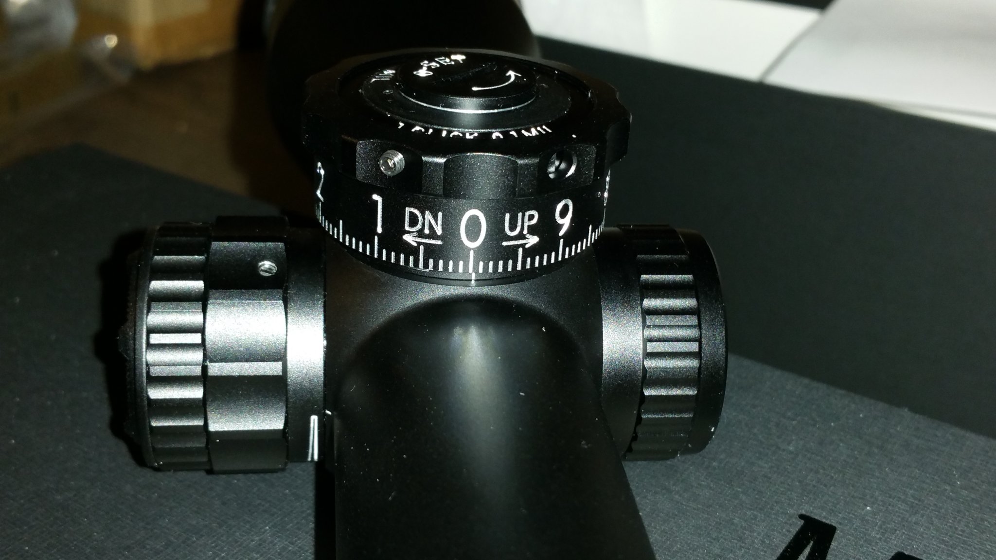

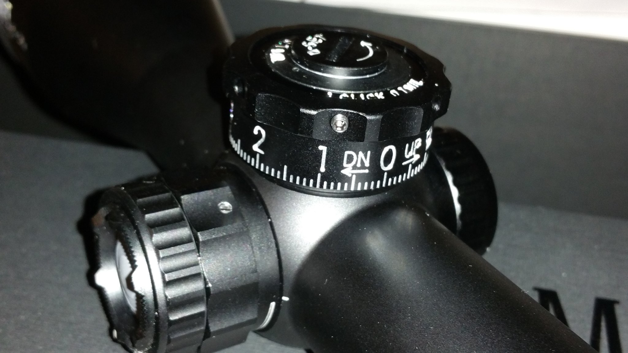

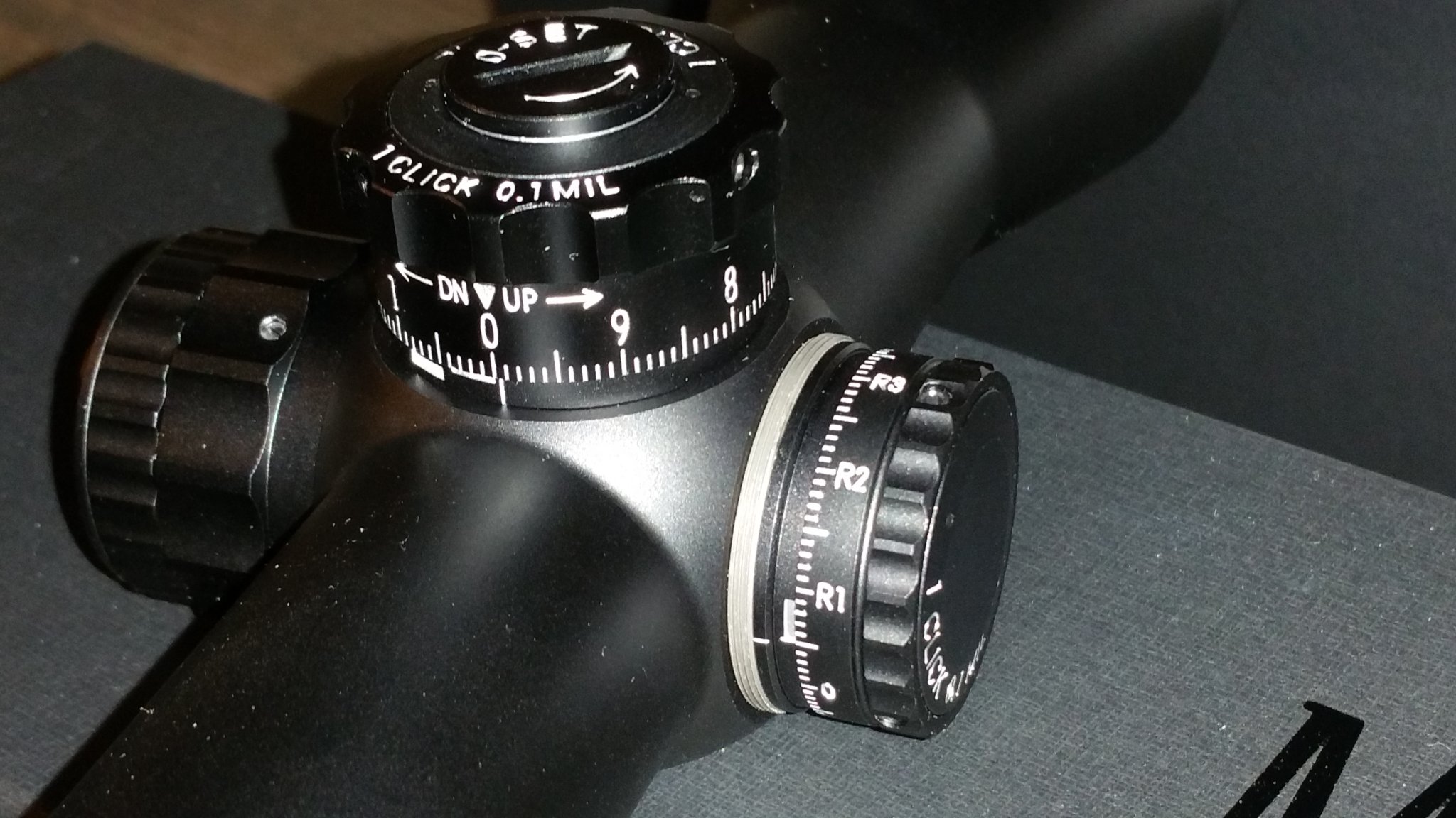

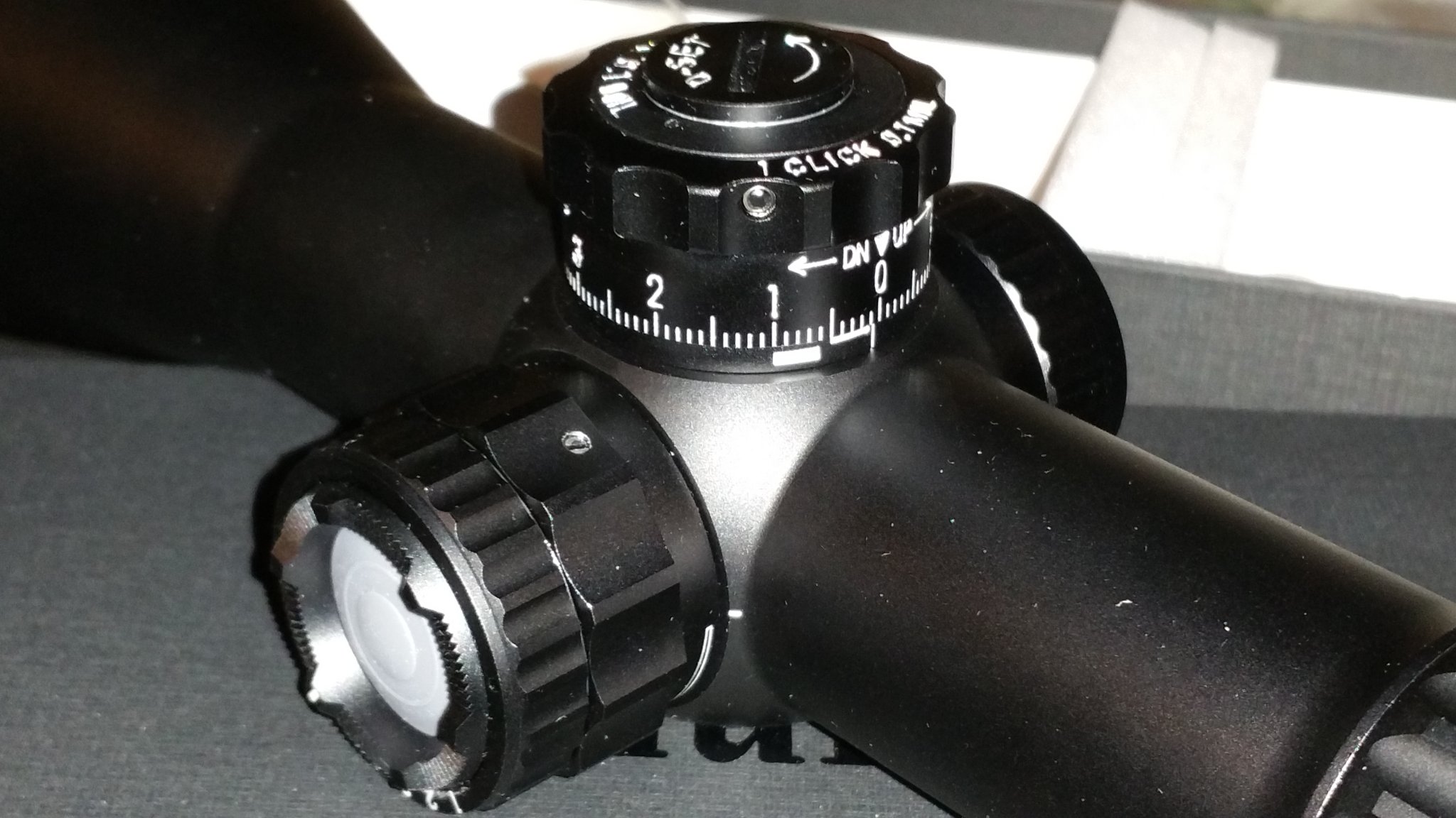

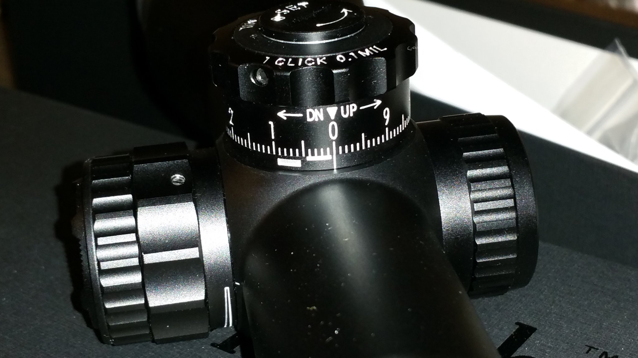

Here ya go... with the optional larger turret installed.
Send a pic of the turrets I’d like to see their new larger turret with bigger numbers
