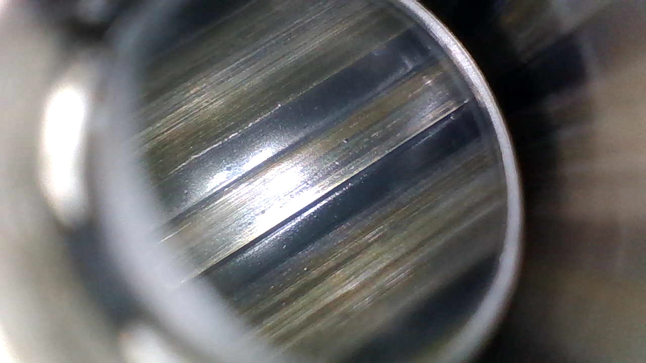

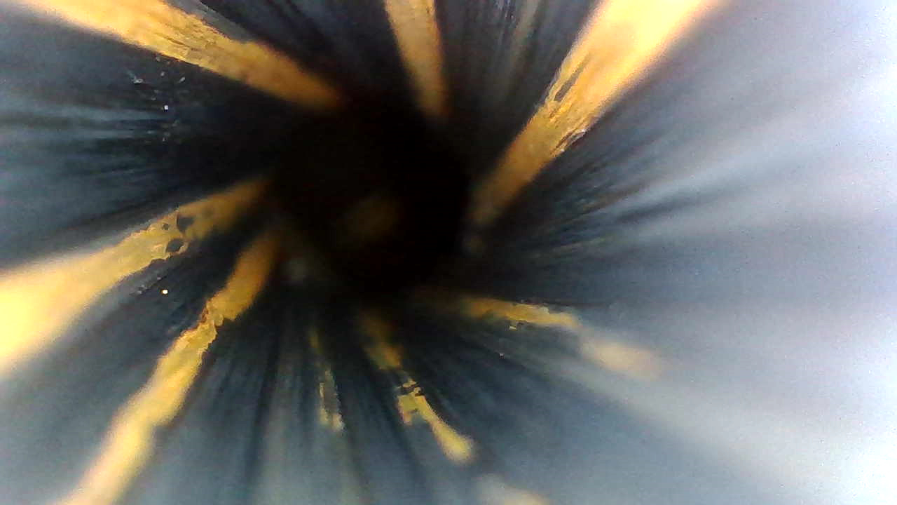

Here is a brand new Kriger:
bandicam 2019-08-22 11-51-25-426.jpgbandicam 2019-08-22 11-51-36-371.jpgbandicam 2019-08-22 11-52-09-962.jpg

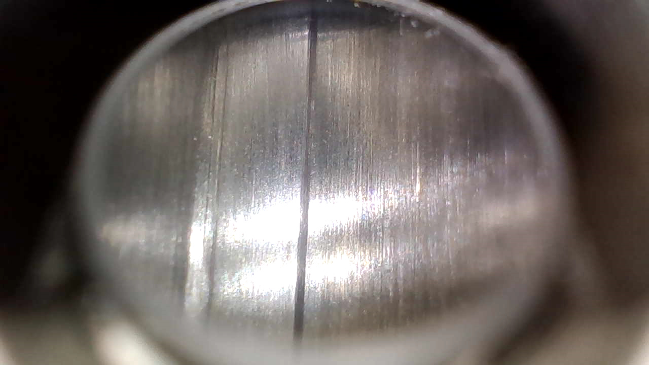

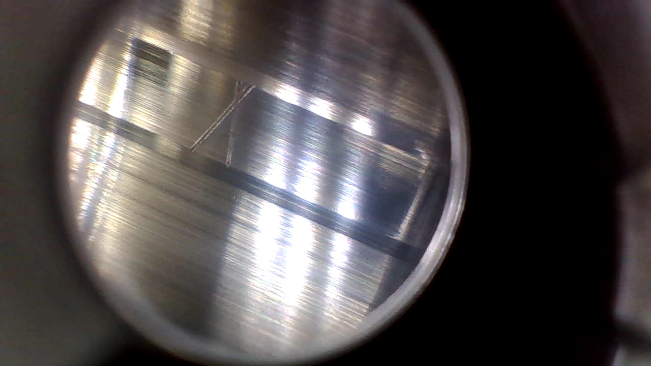

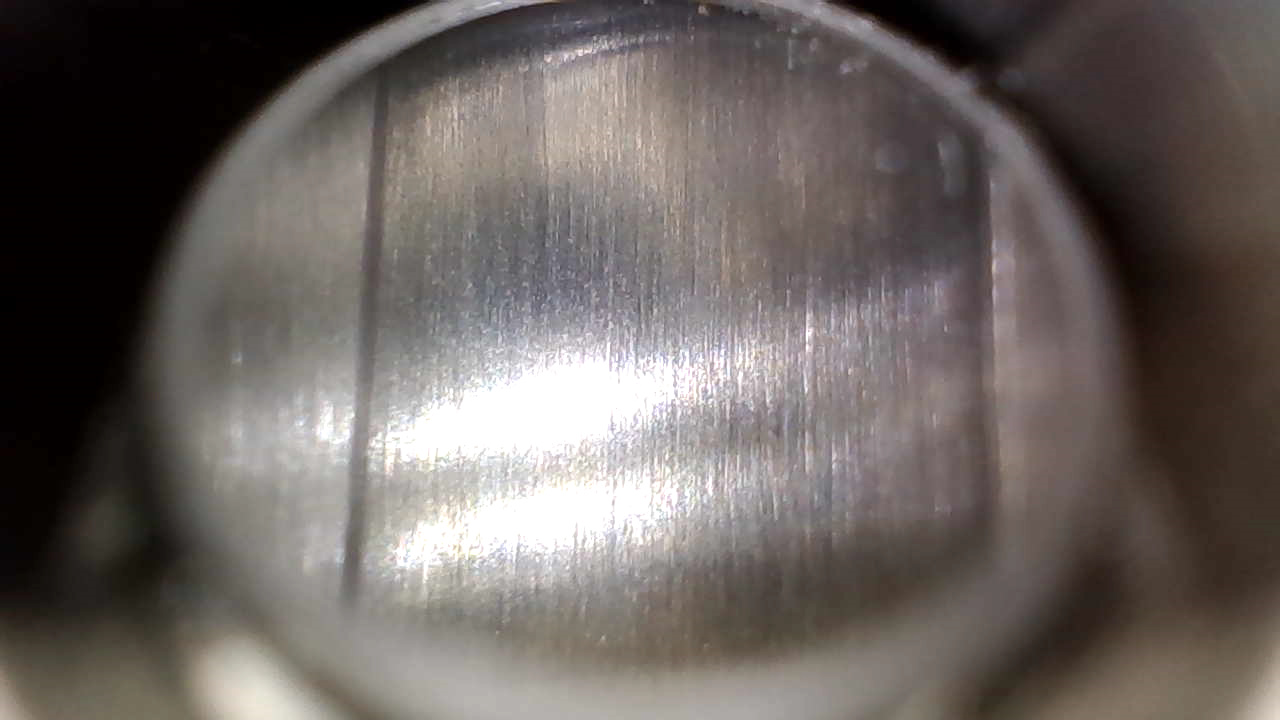

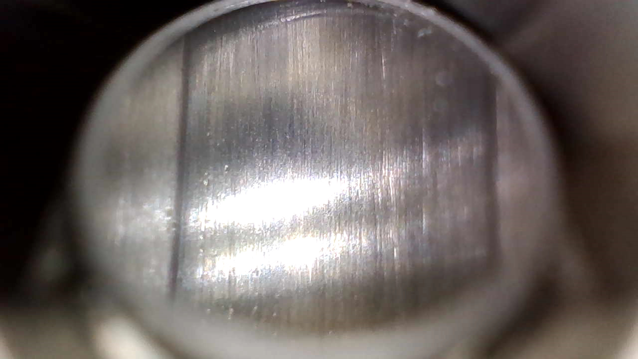

Here is the inside of a new DSG AR barrel. This one shoots extremely well.
bandicam 2020-06-26 08-08-40-543.jpgbandicam 2020-07-22 19-11-47-896.jpgbandicam 2020-07-22 19-12-05-203.jpg

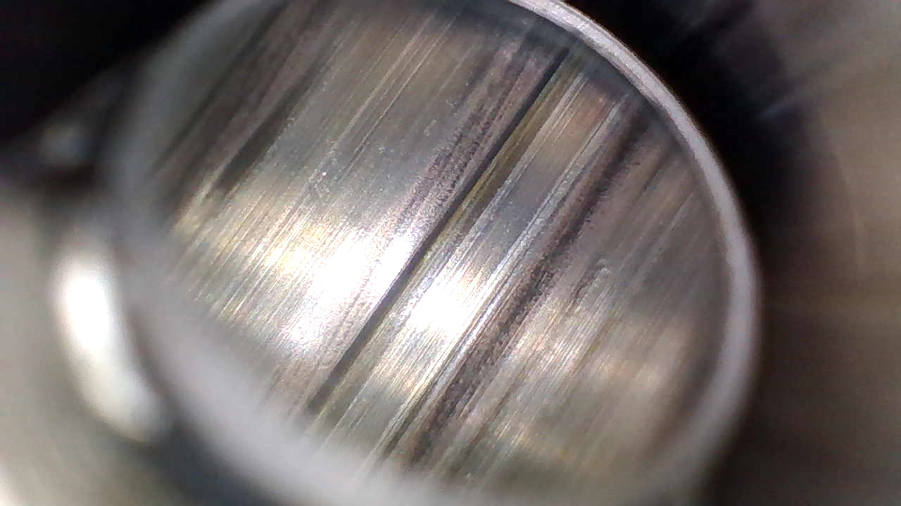

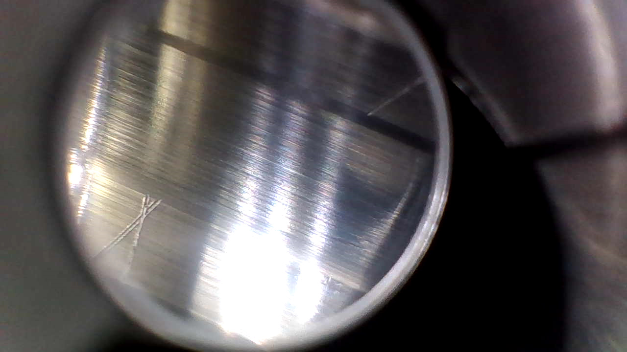

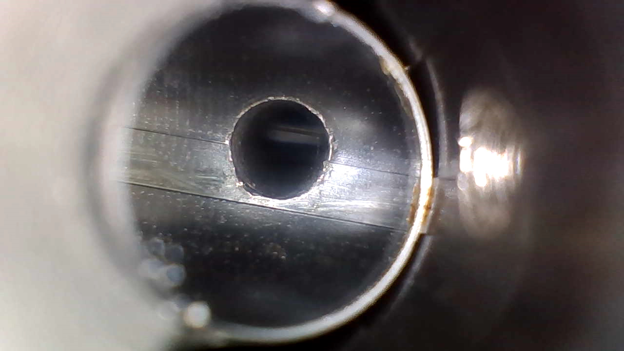

I just bought a "shot out barrel", here is probable why:

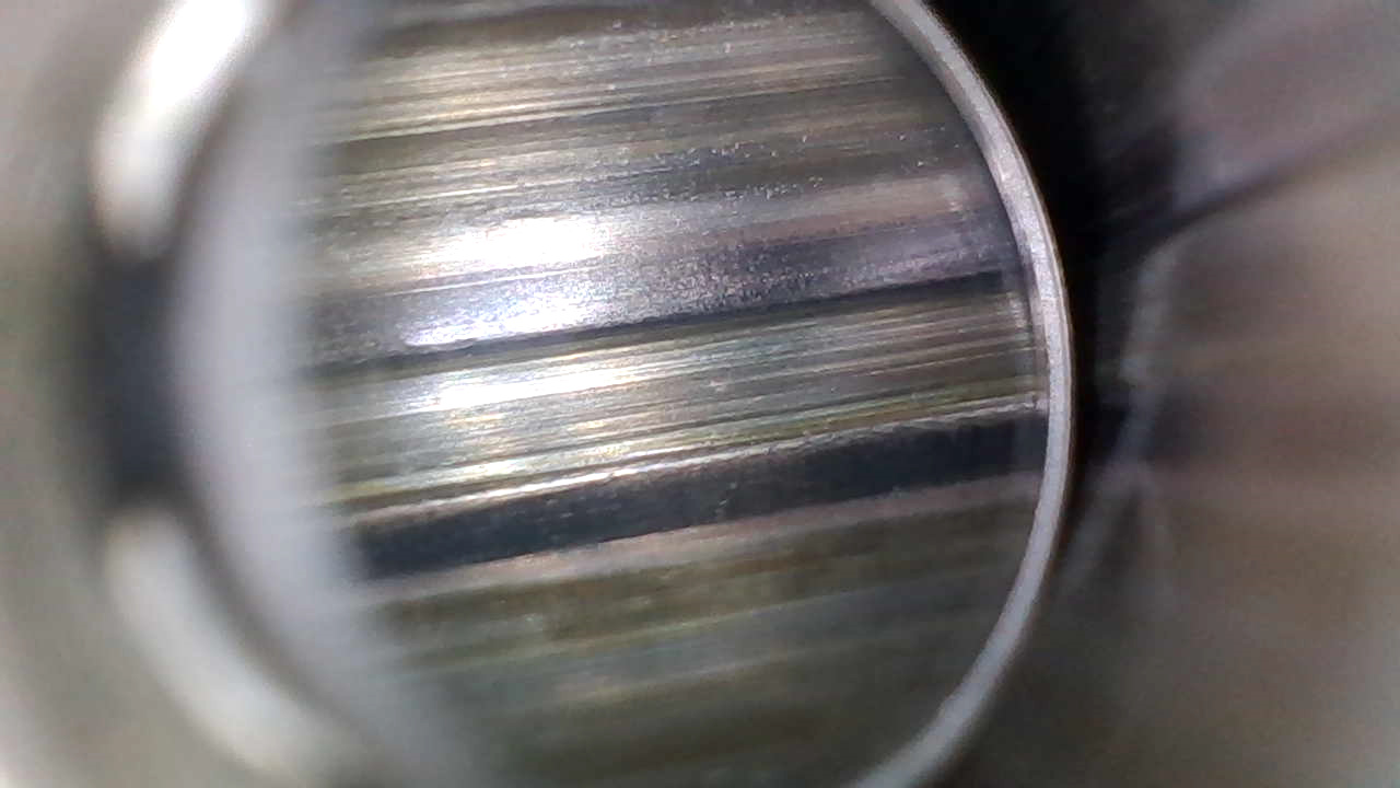

The last 6" of barrel looked like this.

All Savages have massive chatter marks. What makes them a shooter is when they copper evenly. I buy used Savage barrels and scope them. If they have even copper they generally shoot well. If they have patches of copper they generally won't shoot well. First time I looked down one I was dumbfounded that it shot half way decent.
View attachment 7758146View attachment 7758147View attachment 7758148
View attachment 7758149View attachment 7758150View attachment 7758151
I really appreciate the reference pics!
