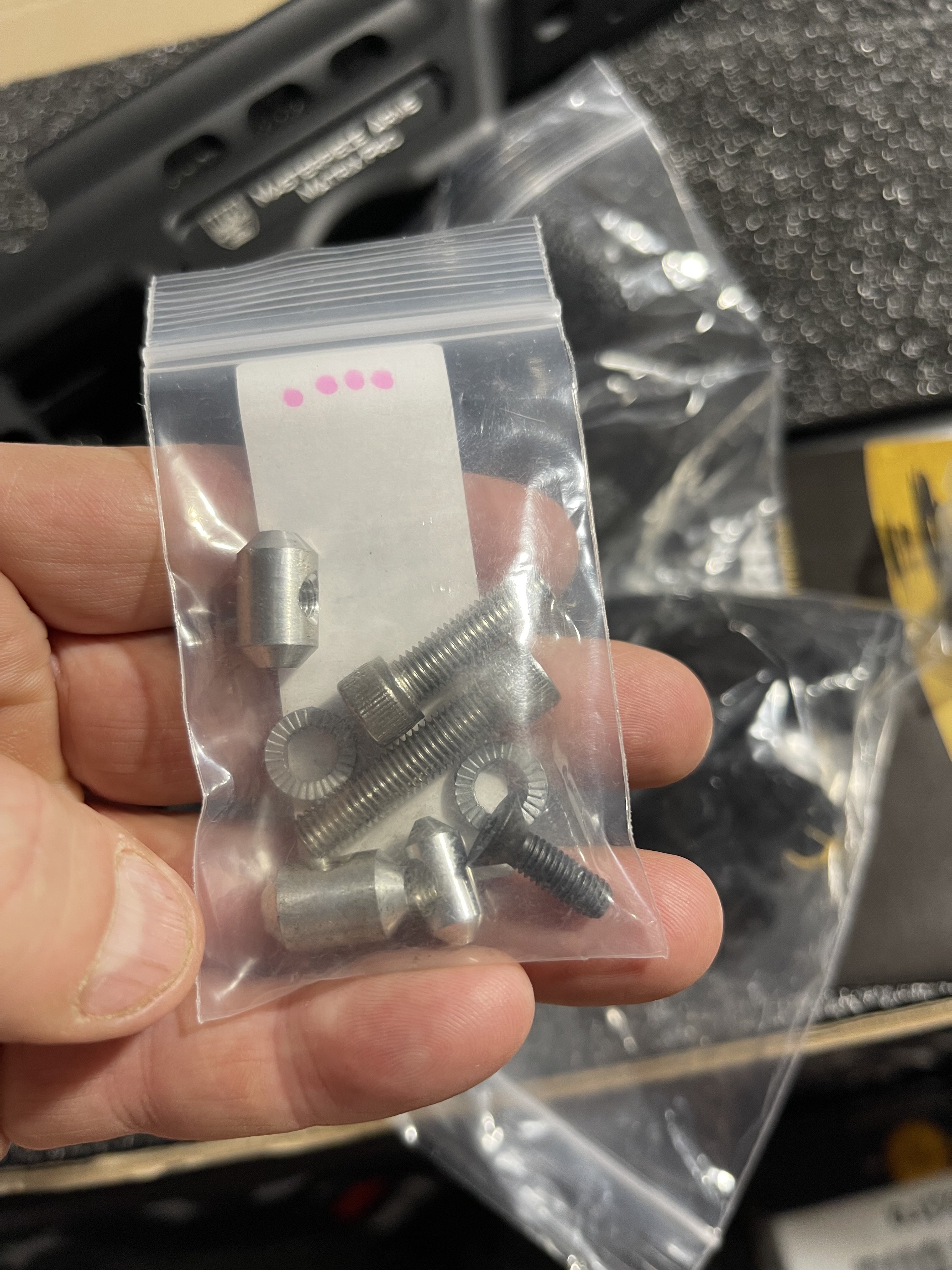

Just tried to install my vudoo 360 action with 1.2 kriegar barrel and had slop in action with mpa action bolts supplied. Any answers? Thanks
Join contest SubscribeSlop as in side to side or up and down?Just tried to install my vudoo 360 action with 1.2 kriegar barrel and had slop in action with mpa action bolts supplied. Any answers? Thanks
Did you put the lug lock in?Up and down

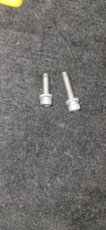

If they’re torqued and it still moves chances are the screws are to longYes I did torque the action screws
needs washers,check your packing again.They didn't include washers
Lug lock doesn't work with a Vudoo action, lug is too short.Did you put the lug lock in?
Is the slop still there after torquing the chassis down?
Huh,Lug lock doesn't work with a Vudoo action, lug is too short.
Most likelySo you think washers will fix issue?
Your issue if you’re torqued down and the action/chassis aren’t tight is going to be the screws bottomed out. Either installing washers which are supposed to be in there (I believe) or shortening the action screws are your optionsSo you think washers will fix issue?
Yeah bought brand new from mpa and they left out washers. So I'm gonna grab some from hardware store tomorrow. Waited for barrel for 6 months from modacam. Can't wait to shoot it. Lol

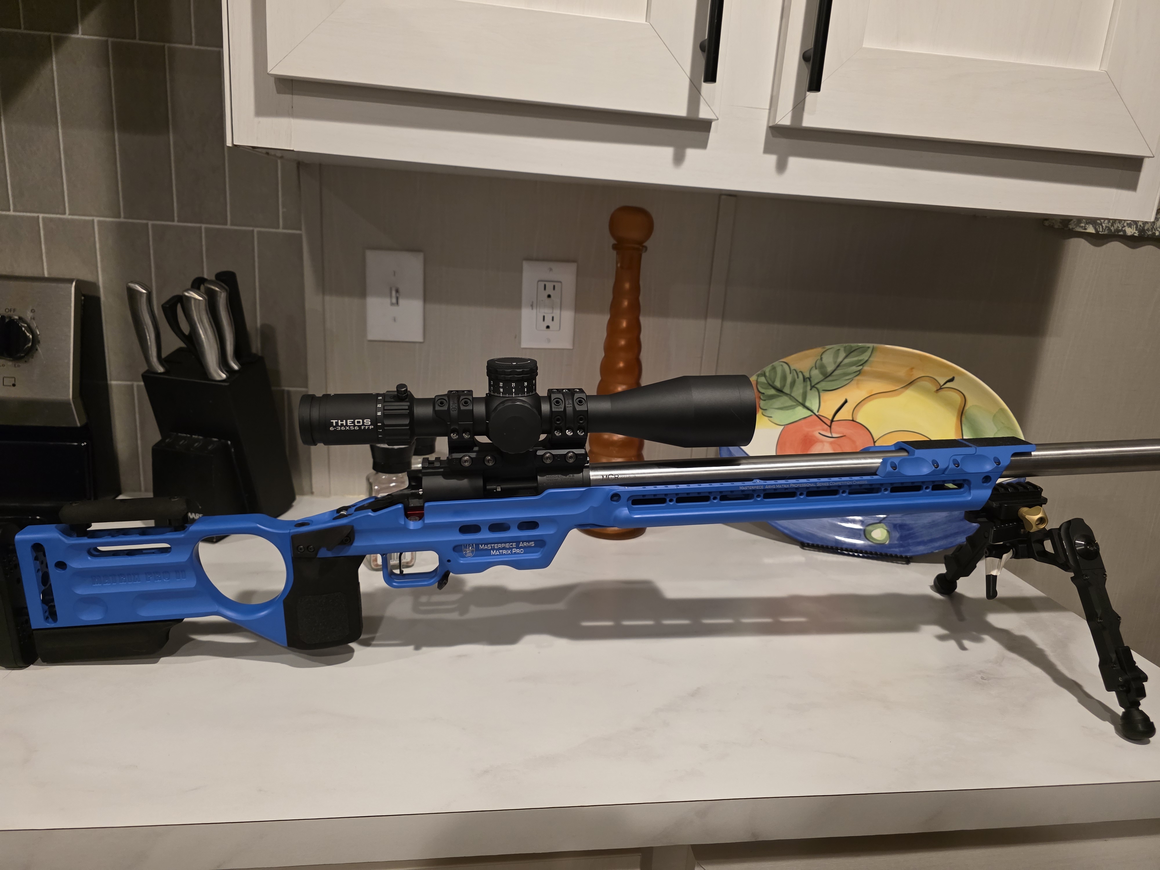

Plan to send a B14R action to him at some point. What you go with?Appreciate all the help she's good to go. Shoots lights out thanks to modacams barrel workView attachment 8699093
I have a pair of B14R I’m building out. Plan to send the least accurate one for a Modacam upgrade. Depending how the other shoots and what the Modacam does I may do bothSent him 25 kriegar shoots great. Took a long time
Yes sir it was worth the wait. Only used one lot of center x and some sk yellow to sight in and was very happy. Can't wait to try some other stuff
