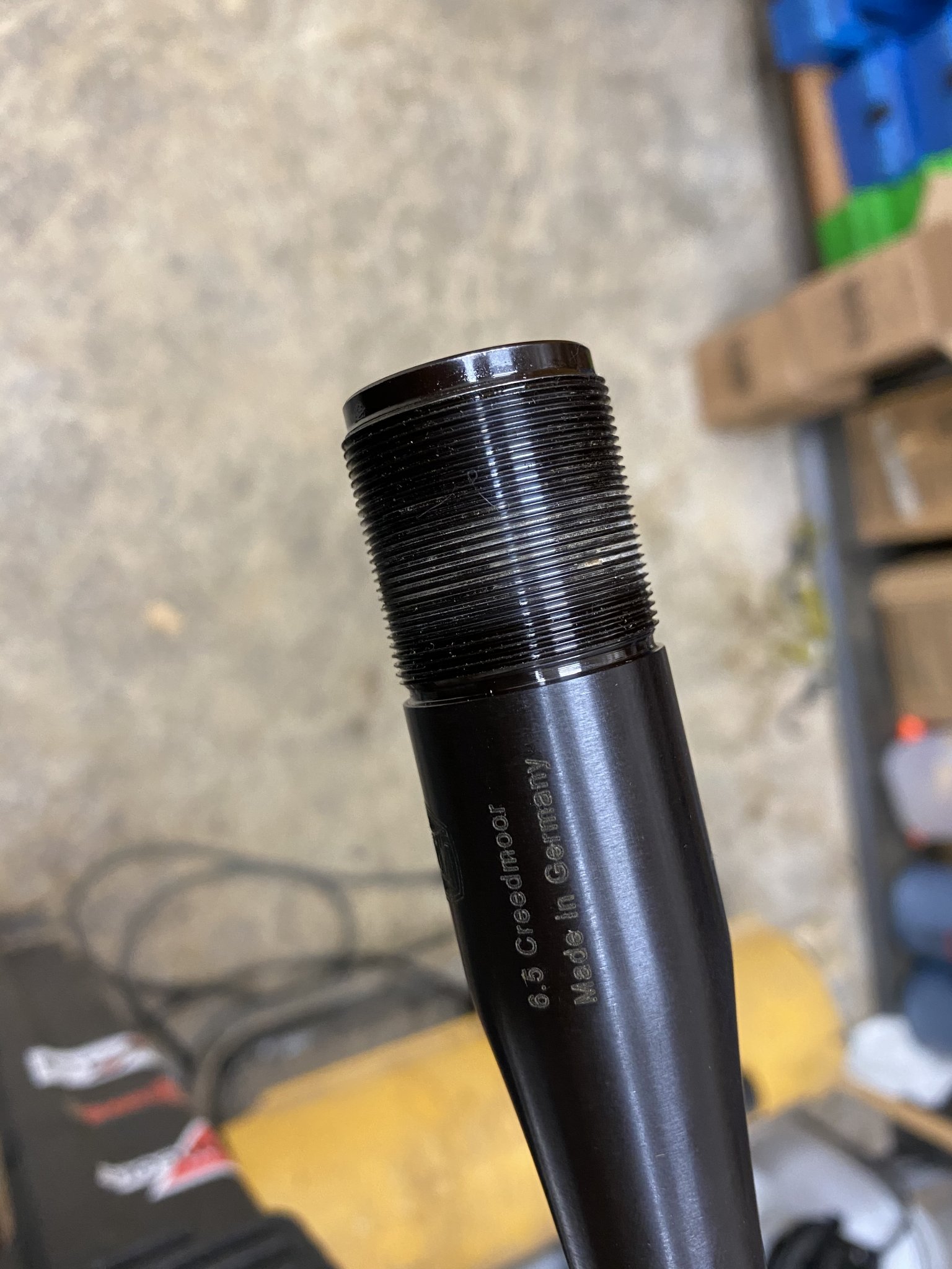

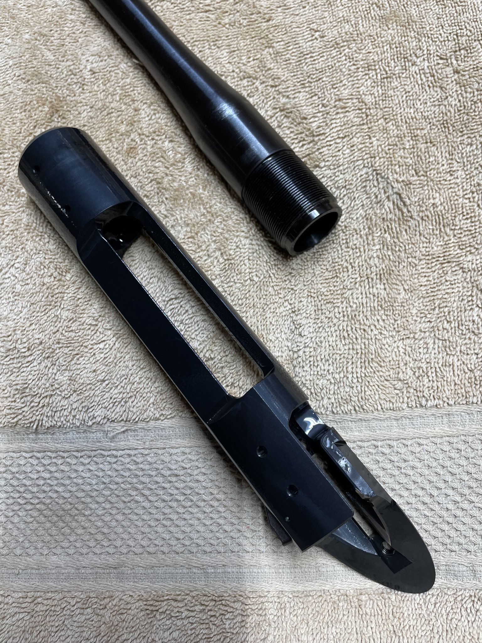

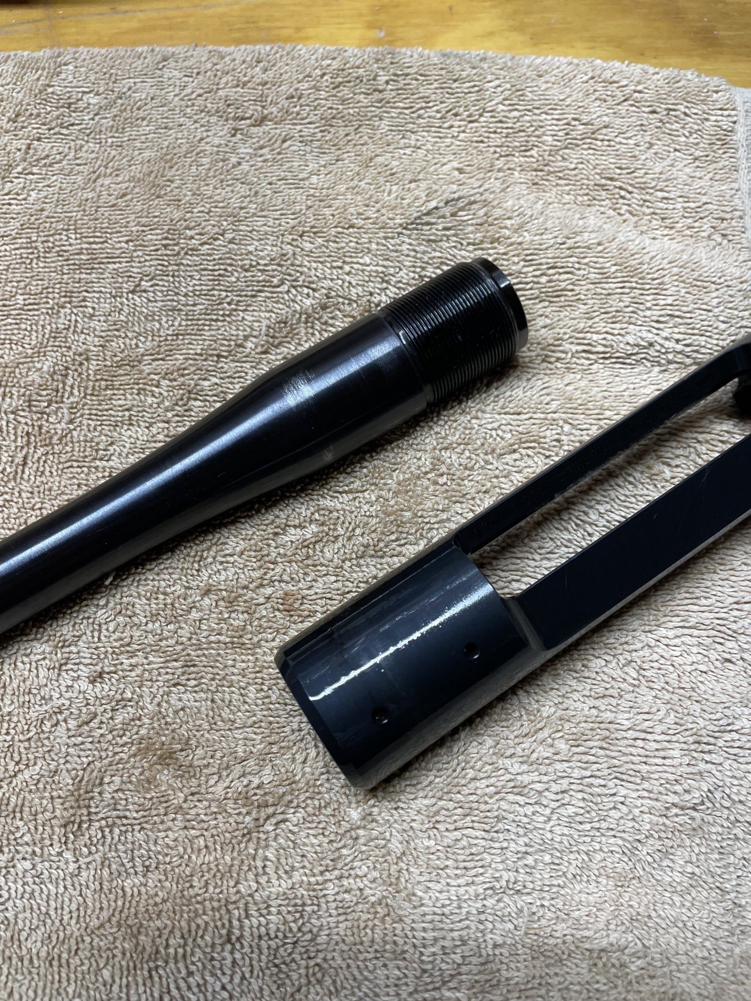

    Just pulled the barrel on my M18. Had to machine special bushings for the action wrench and barrel vise. Needed heat a few times due to an excessive amount of locktite between the barrel and action. Can thread the barrel now for a supressor. If anybody needs dimensions from the barrel or action now’s the time!
