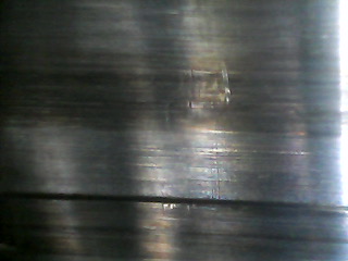

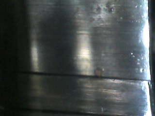

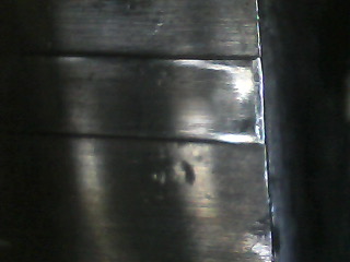

This is an internal look at my McGowen Barrel Chambered in 6XC. I now have 143 rounds down it and have developed two loads that consistently shoot 0.33", 3 shot groups at 100 yds. The first image is several inches down the bore (prior to cleaning) from the chamber, the second (and remaining pictures are all post-cleaning) is Mid-Barrel, and the final two images are at the muzzle. Despite the appearance, the rifle shoots very well (particularly after I've fired a fouling shot).
As a comparison, I borescope two of my "better" barrels and they are definitely cleaner and there are virtually no tooling marks BUT they don't shoot orders of magnitude better.
