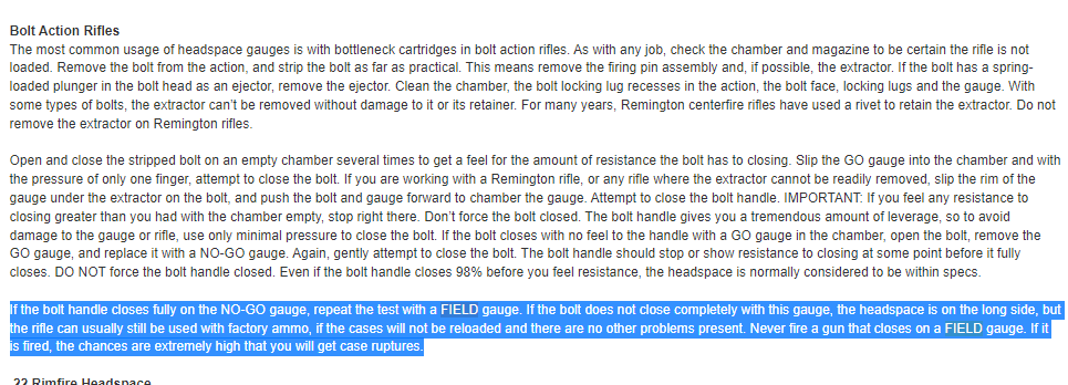

    From Brownells learn section on gunsmithing and how to use headspace gauges. Our chambers may be within tolerance, but look at what Brownells says. I am strictly reloading for this barrel.
    Under normal commercial circumstances, a gun whose bolt closes completely on a NO-GO headspace gauge (even if it does not close on a FIELD gauge) should not be put out for sale or returned to a customer as being suitable for use, until the headspace situation is corrected. Keep in mind that a firearm may have perfect headspace, but may have other chamber problems or action problems that could keep it from being used safely.
    There are normally three types of gauges made; GO, NO-GO and FIELD. The GO gauge corresponds to the SAAMI (Sporting Arms & Ammunition Manufacturer’s Institute) minimum chamber length, while the FIELD gauge usually matches the maximum chamber depth, or slightly less. NO-GO gauges are an intermediate length between minimum and maximum, that, technically, is a voluntary dimension. A firearm that closes on a NO-GO gauge and does not close on a FIELD gauge may not give good accuracy and may have very short cartridge case life from the ammunition re-loader’s standpoint.
    Case head separations are a possibility with a gun that closes on a NO-GO gauge. It may also fail to fire or suffer from misfires, depending on the firing pin dimensions.
    Open and close the stripped bolt on an empty chamber several times to get a feel for the amount of resistance the bolt has to closing. Slip the GO gauge into the chamber and with the pressure of only one finger, attempt to close the bolt. If you are working with a Remington rifle, or any rifle where the extractor cannot be readily removed, slip the rim of the gauge under the extractor on the bolt, and push the bolt and gauge forward to chamber the gauge. Attempt to close the bolt handle. IMPORTANT: If you feel any resistance to closing greater than you had with the chamber empty, stop right there. Don’t force the bolt closed. The bolt handle gives you a tremendous amount of leverage, so to avoid damage to the gauge or rifle, use only minimal pressure to close the bolt. If the bolt closes with no feel to the handle with a GO gauge in the chamber, open the bolt, remove the GO gauge, and replace it with a NO-GO gauge. Again, gently attempt to close the bolt. The bolt handle should stop or show resistance to closing at some point before it fully closes. DO NOT force the bolt handle closed. Even if the bolt handle closes 98% before you feel resistance, the headspace is normally considered to be within specs.

    From the same Brownells link -
    Edit - Yes, I agree about the vendor attitude, it's terrible. However, attitude aside, he's sort of right. Not trying to throw shade your way but too many people probably call him up with incomplete knowledge for the exact same "non-issue." Had you known for sure the chamber spec exceeding SAAMI max, no one (including Dan) would be able to give you shit for it. On a positive note - you're probably learning a bunch about headspacing and SAAMI specs.

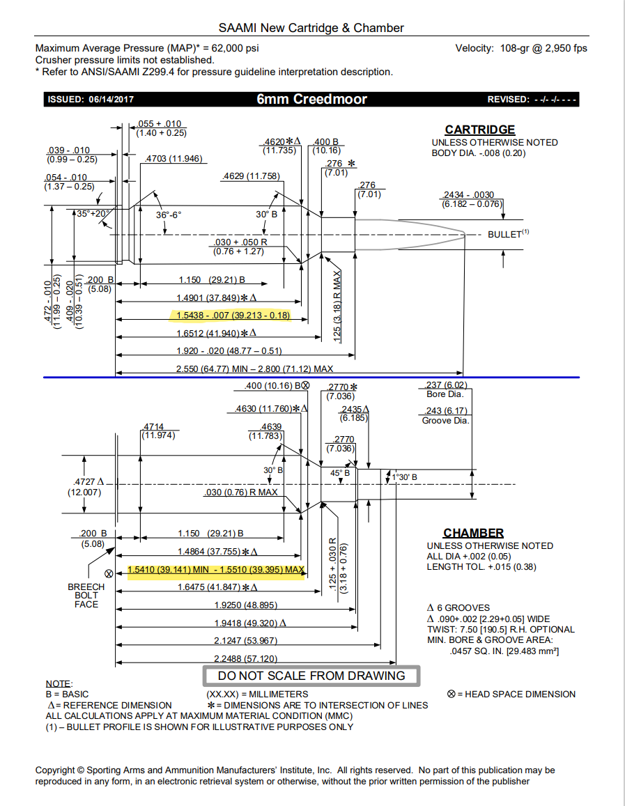

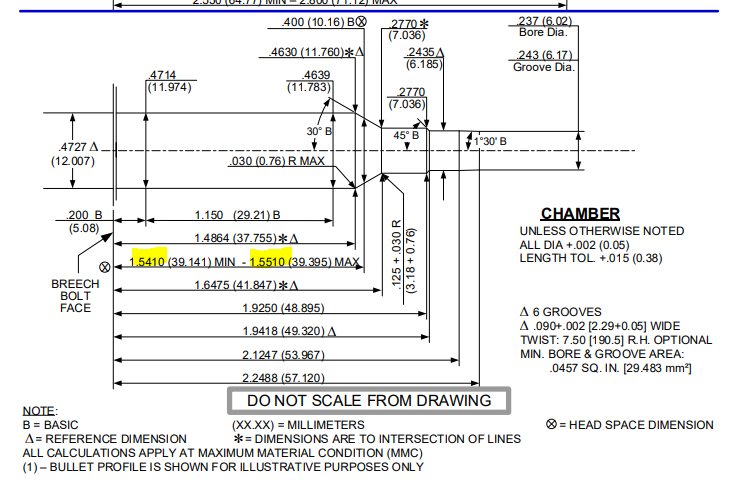

    Go +.002" seems pretty tight for a pre-fit especially considering these actions are .001" different, not to mention maybe they are long in comparison to others.
    https://saami.org/wp-content/uploads/2018/04/6mm-Creedmoor.pdf
    Within SAAMI spec, it's safe for factory loads. Case will be fire formed on first firing and and sizing is controlled by the reloader after first firing. People shooting factory loads in what could possibly be millions of firearms with slightly longer but in spec chambers aren't dying by the millions. Wildcatters ain't dyin by the thousands. Handloaders playing with neck thickness, bullet seating depths, etc. ain't dyin by the thousands.
