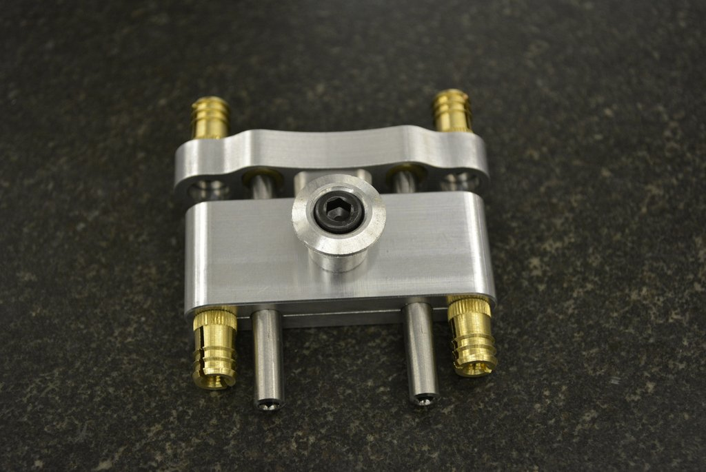

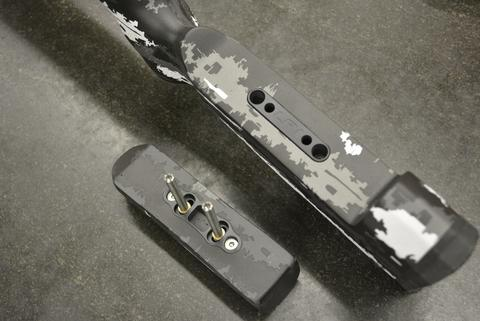

    There's a bit more to just cutting into the stock I'm afraid.
    Manner's stocks in the non "A" configuration typically use a foam type sound deadening material in the back half. They'll pack hard fill in the grip, transition to foam, then cap it with another hard layer for the recoil pad.
    The cheek piece goes right where the "sponge cake" is. There's no getting around it. Can it still be done? Absolutely! It's just more work.
    Rather than regurgitate, just click here:
    https://www.longriflesinc.com/collections/products/products/2-4ultach-cheeck-hardware
    https://www.longriflesinc.com/colle...ducts/gunsmithing-services-2-4-ultach-install
