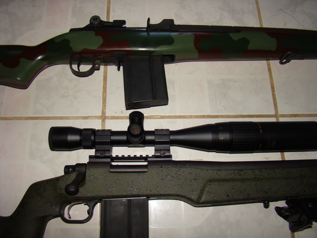

was curious about the finish on the mcmillan stocks. i have a mcmillan on my m1a supermatch with the molded in camo. it's finish feels almost like grippy rubber. my question is, are the a1-a5 stocks have the same finish, or is it more of the somewhat rough somewhat smooth like the b&c stock my 700 currently wears? Tanks!

"Grippy rubber" feel? All of our M1A stocks with molded in camos are simply very hard smooth gelcoat on the ourside, no texture to them at all. And they are not available with the textured panels on the pistol grip and forearm.
Are you sure you don't have some kind of a custom painted finish on the rifle?

I was wondering the same thing. All of the Supermatches with McMillan stocks that I have seen have had a hard and smooth finish.

hard Gelcoat, no rubbery

I appologize for my bad grammer, was just looking for some info after being at work for 36 hours, we can't all be so priveleged to work on submarines. i suppose the phrase "grippy rubber" was a bad choice. i assume this is the hard gel coat finish.

Yes sir, from my vantage point, that appears to be identical (if not a little shiny) to the gelcoat on both of my McMillan's, one of which is on an M1A.
