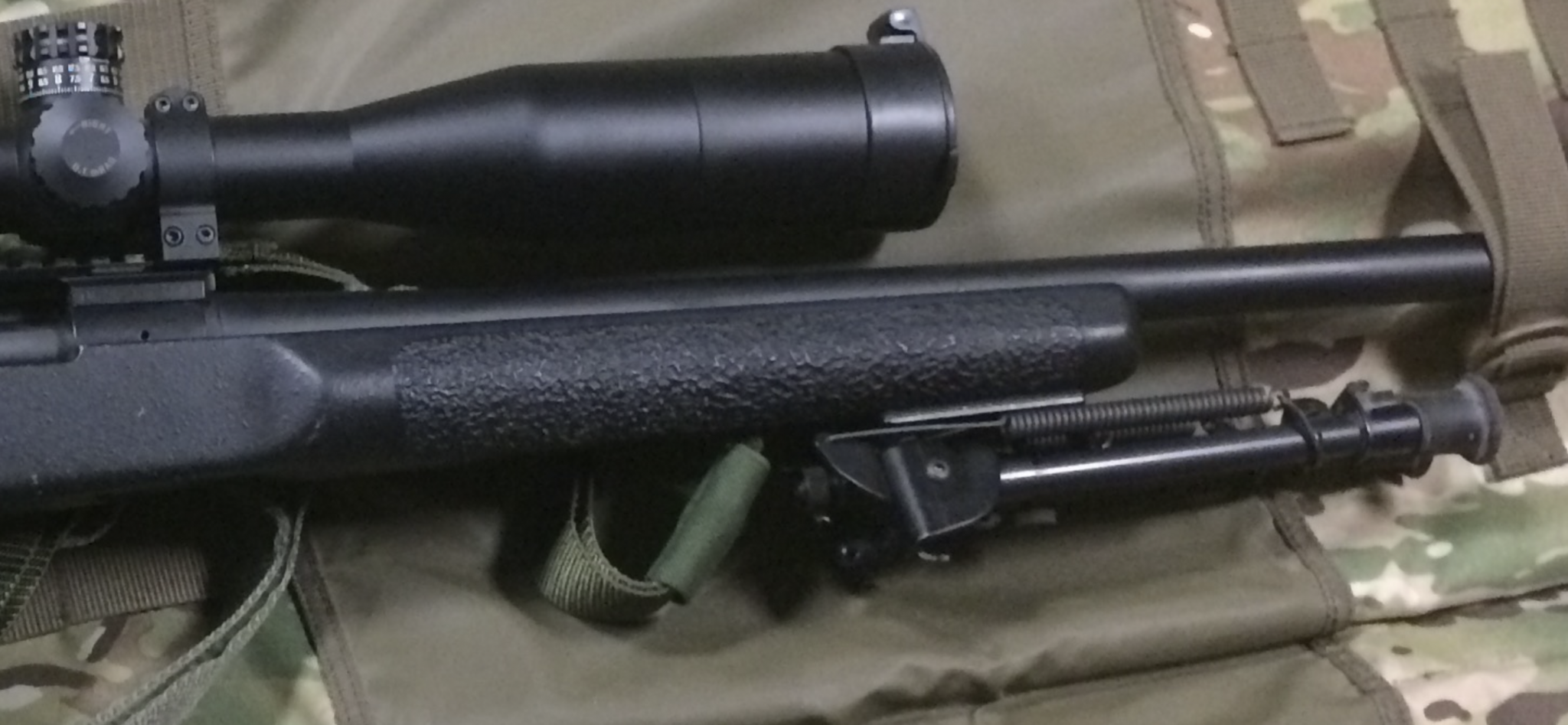

Here is my Harris bipod on my McMillan A5. I used the front stud for the bipod and the second stud (from the muzzle) for the sling.

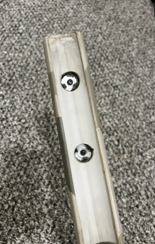

As previously said, they screw out. If you wanted to move the spacing however, that's a bit more involved.
Pic shows the inner workings.
Awesome thanks guys. I haven't had the stock off in awhile so I forgot about the nut plates on top.
