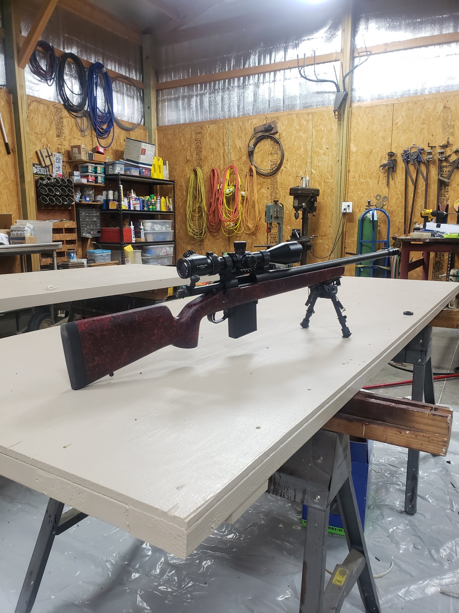

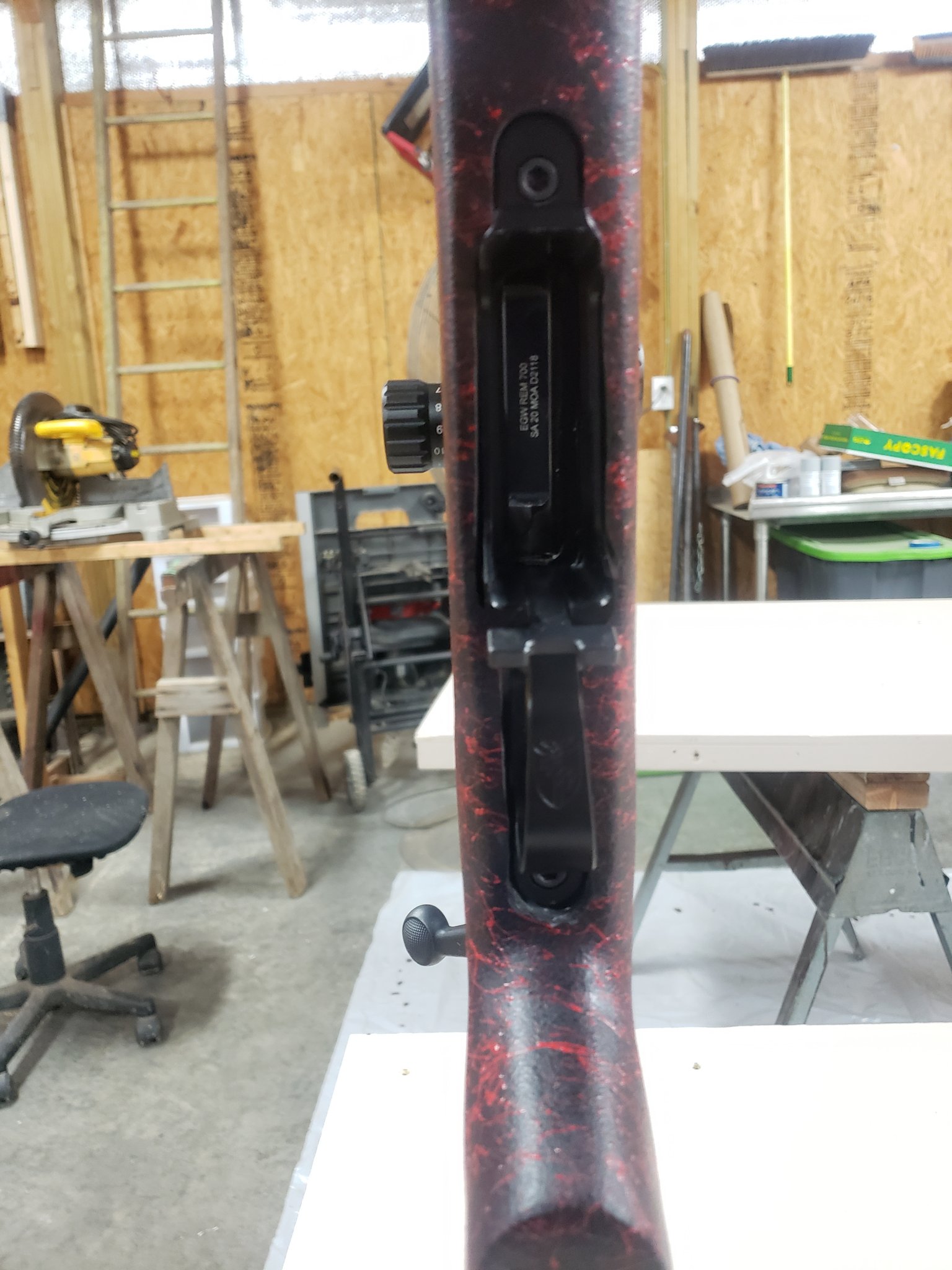

I know this is an old thread but I want to chime in and agree with the folks saying send it off. I installed a hawkins M5 dbm yesterday into my Bell and Carlson long range hunter that was originally a dbm. It took me about 5 hours with a dremmel and a die grinder but I got it feeding flawlessly in the 25 rounds Iv shot it.
