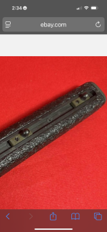

Looking for information about the rail system McMillian stock’s previously used. I recently acquired a M86 and building a 280 Ackley but would like to install a ARCA rail The stock did not come with any hardware that is needed. Any help would be much appreciated! I attached a picture of what I think I need.

It's from a TacOps with Anschutz rail.
You need the nuts from an AFAR kit and the ARCA rail of your choice.
I have some that I sent to Birdsong to get the TacOps colors. Can send photos of what I did if interested.
