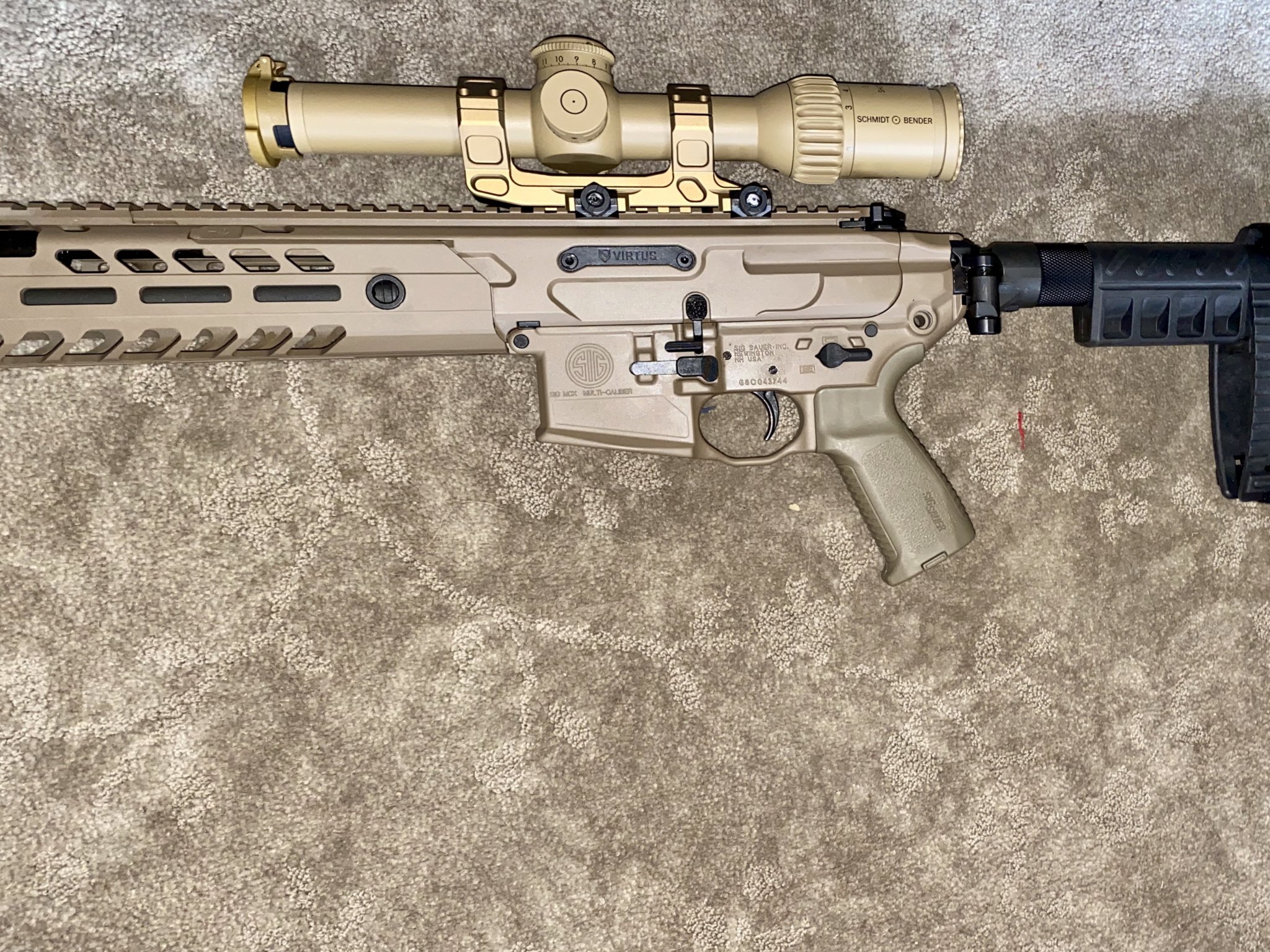

Your Post caused me to look at the folding brace on my MCX pistol and a 14.5 SIG 516 upper with fixed brace.
The buffer tube is knurled on the MCX and quite stable but smotth on the 516 and will rotate.
I am going to ask SIG if they have any knurled tubes.
As to the optic, I put a S&B Dual CC Short Dot on which is out of the price rnage you specified.
I’m going to look into the spin fix from Gearhead.
