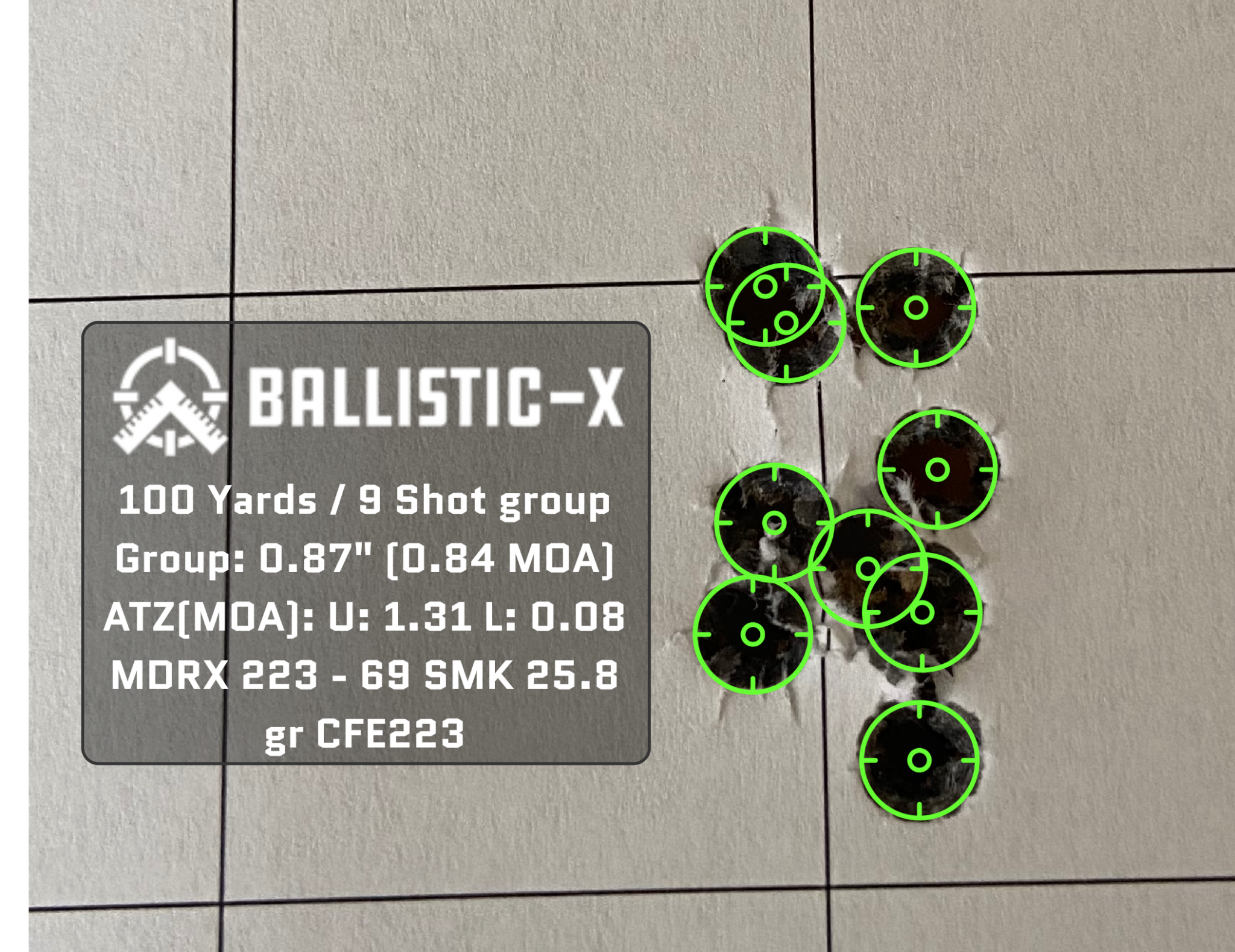

So far I’m pretty happy with my 20” 223 FE, still trying to find a good load for my 20” 6.5. It does mangle the 6.5 brass a fair amount though.

Looks pretty good to me. It would be nice if you could keep me updated in regard to the brass. Have you tried changing the gas system slightly ?

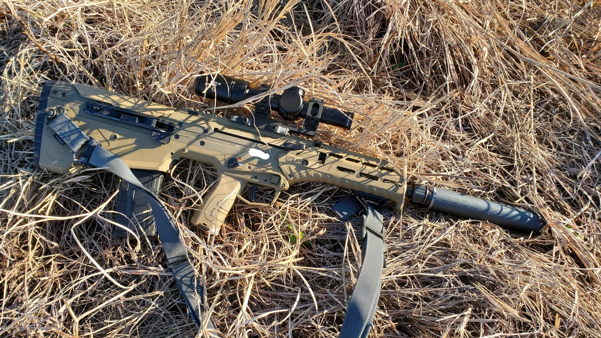

So I bought a lightly used mdrx in 556 from a friend recently who needed some money and finally got to take it out yesterday. I was pretty impressed with its performance so far. I had no malfunctions, ar15 like recoil impulse and was very pleasant to shoot with a silencer. This is only with 100ish rounds so far.
I managed to get one of the last 308 barrels from eurooptic before they increased the price on them and that comes in today.
I shot the last group after sighting it in on a cardboard box target staked in the ground waving in the wind at 100 yards. I am certain with consistent ammo and a better target stand it can do better.
Once I turned down the gas system it stopped mauling my brass, I'll post some pics later @Thoruos . But its definitely harder than a well tuned AR.
Considering all the negative feedback this rifle gets I was expecting a dumpster fire but so far I'm pretty pleased. I am very aware the original mdr was a mess and I've read the glassdoor reviews. But so far the one I have is pretty great and will be my pig hunting rifle for the foreseeable future.

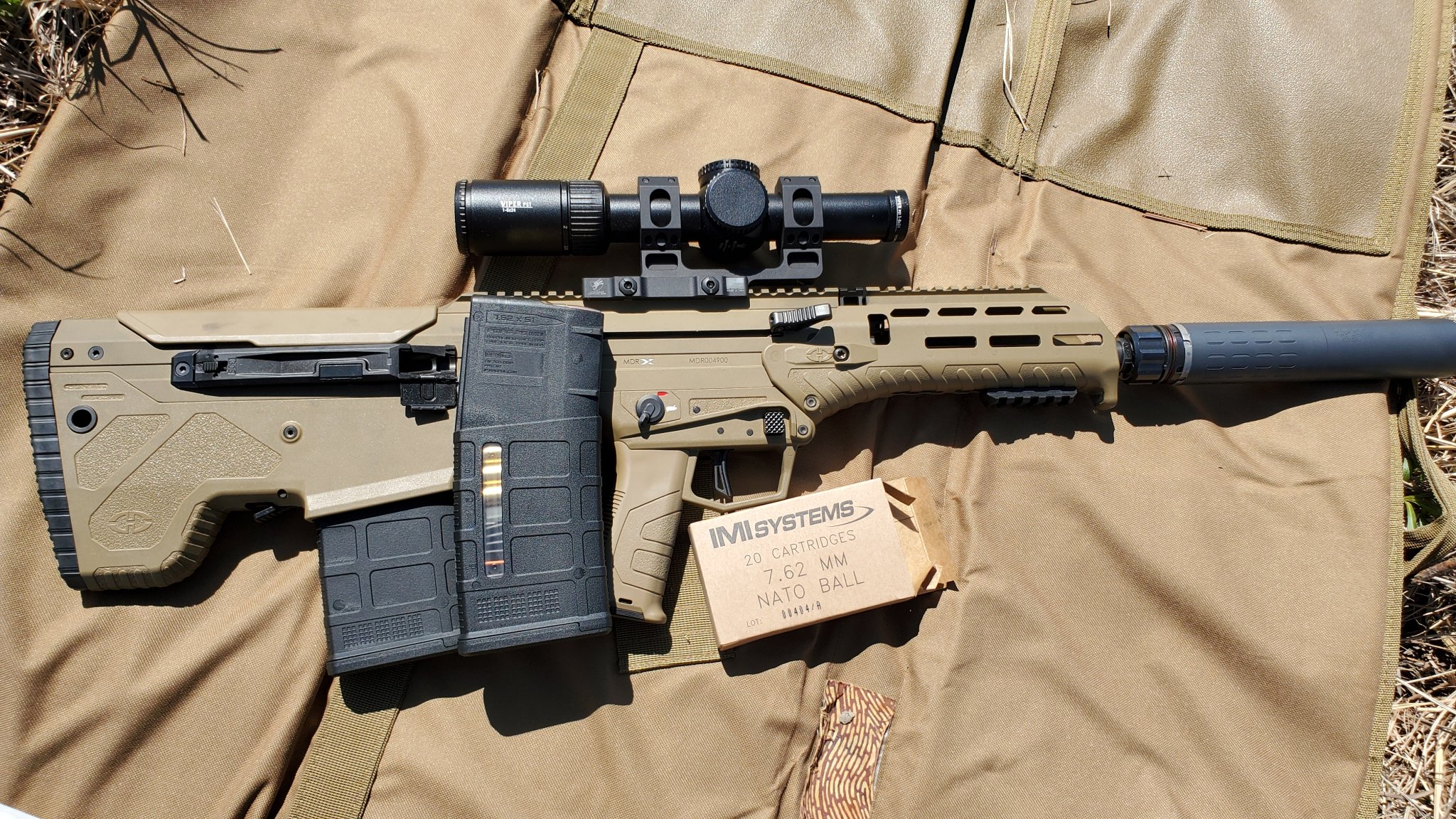

I was able to go out and shoot my MDRX with the 308 barrel (16") today (~80 rounds). The good is: I thought recoil was pretty acceptable and it ran well with my silencerco hybrid/keymo on. My only similar comparison is my dad's Aero ar10 and that thing is very punishing. I have the gas setting on 1 or Silenced 1, or whatever the lowest setting is. Brass is acceptable to reload but has some cosmetic flaws. I did have 3 malfunctions and all 3 were using the 25 round pmag. My theory is the spring tension on the 25 may have something to do with it. I was very happy that the 556 barrel seemed to have a very good return to zero and when switching to the 308 barrel I observed a 1.5 mrad shift to the right. I was originally using a bipod on the rifle, however, I started to see flexing in the handguard in the mlok slot. Probably best to shoot off a backpack and not chance it. I also tried using a Hog Saddle/tripod with it and its doable but awkward. I also swapped calibers in my windy pasture and while it wasn't a big deal its probably inviting you to misplace parts.
