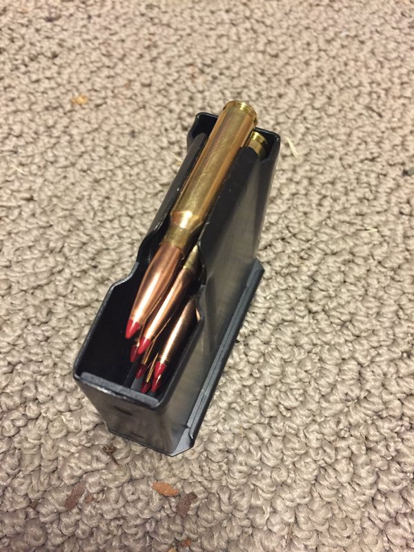

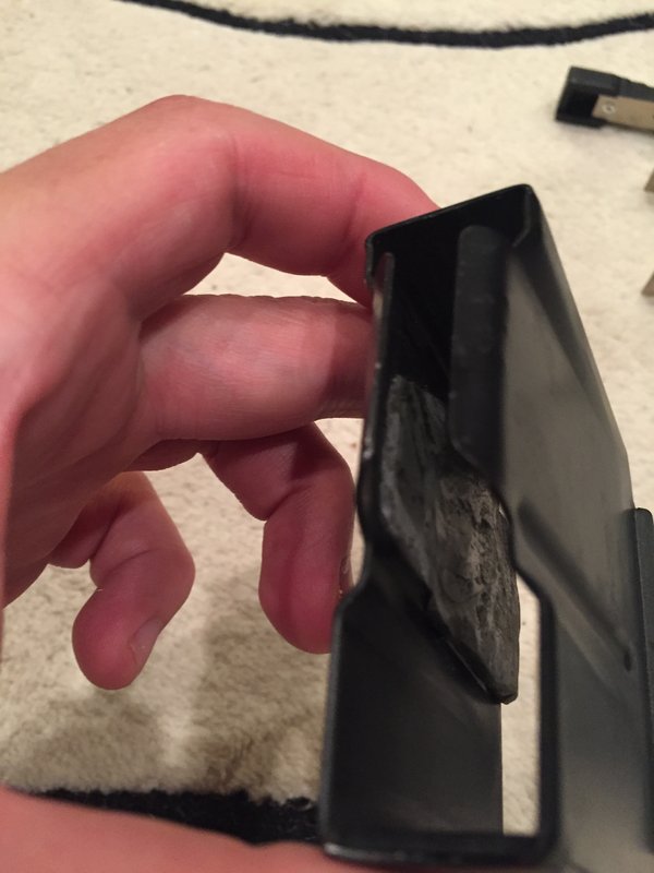

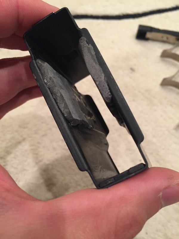

    ​ I'm using a 5 round 308 Win. aics magazine that I modified. Bent the feed lips in and put a little epoxy putty on the mag walls to make it slimmer so it single stacks the rounds. It runs 7 rounds of 223rem and 223AI at a COAL of 2.625" smoothly.

    Whoa. Can we see the inside of the mag or do you have any measurements of how thick the epoxy is?
    I just slopped some JB Weld putty on the mag walls and used a chisel on it till the mag follower fit with a little clearance.

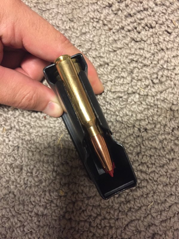

    Okay so I am bumping this thread, hopefully someone can help me improve the feeding of my mags. I'm having issues feeding 223 with both a 10 round polymer MDT mag and a metal 5 round Accurate Mag. Both mags are sitting high enough in the bottom metal and the mag lips are contacting the receiver, and they both fit snugly with no upward play.
    With the MDT magazine, the rounds will feed, but the bullet jackets are getting marked up by the feed ramp of the receiver. You can see from the picture below that as the bolt starts to push the case rim, the tip of the bullet contacts the feed ramp and it takes a solid push to get the round to feed into the chamber. When carefully extracting the round, I can see that the feed ramp has left a mark in the bullet jacket. You can even see in the picture a little brass colored line on the feed ramp from where the bullet jackets are getting marked up. The edge on the feed ramp doesnt seem sharp at all, in fact its pretty smooth. It just feels like the round is sitting too low in the magazine, or the magazine lips are holding the round too long, not allowing it to angle up as it begins to approach the feed ramp. I've also included a few pics of how the loaded round sits in the magazine.
    It seems like I could potentially bend the lips a bit to let the round sit a tiny bit higher in the magazine, or maybe grind the front of the lips away a bit to allow the round to free from the magazine sooner when it starts to contact the feed ramp?
    Now the Accurate Mag is another problem. The bolt face contacts the case rim, and then immediately slides over the case. I'm assuming that on this mag, the round is clearly just sitting too low in the magazine? I've included some pics of this issue as well, and of the round in the magazine.
    So I'm guessing this magazine needs to have the feed lips bent out a bit to allow the round to sit higher? Any ideas on the best method of accomplishing this given the fact that there is a plastic insert within the mag body? Pretty disappointed that a $64 magazine wouldn't even be close to feeding and would need this much modification. I guess I could reach out to AM and see if they would send me a replacement or something.
    Any help is appreciated... I don't necessarily need to get both of these mags operating flawlessly, I'd settle for one or the other. The MDT is nice because it allows the long OAL, but I know the Accurate mag can be modified to take longer lengths as well, so it doesn't matter to me. Right now, it seems like the MDT mag is very close to feeding properly, if I can just get the lips to release the round a bit sooner maybe.

    The MDT plastic one, I'd grind the feed lips back to shorten them, allowing the round to release/rise sooner.

    How a magazine feeds is the product of the relationship between the position of the magazine in relation to the receiver's feed ramp, its position in relation to the bottom of the bolt head, cartridge taper, cartridge OAL, and the overall shape of the feed lips, among probably other factors I either forgot or didn't think about.
    If your mag sat a little higher in the stock, maybe you wouldn't have this problem. If the feed ramp was designed differently in your particular rifle, maybe you wouldn't have this problem......you get the point.
    With all the possible combination of rifle designs, stocks, DBM designs, variations in DBM inletting from one stock maker and/or gunsmith to the next, etc, etc, etc it's not surprising at all that not everyone has the problems you're having. I don't. MDT plastic mags work swell in my 223 (Howa) with my chassis/DBM inlet (KRG), and my ammo (loaded to 2.26 OAL"). If I changed any one of those parameters, I may have a train wreck or it may all still work fine.
    I think you will have to become the sacrificial lamb and donate one of your mags to science (so to speak) to find out if shortening the feed lips from the front will fix the issue, and if so by how much. Before you shorten them, I suggest you try relieving material from the inside front edges of the feed lips with a front to back taper to try to increase the up angle of the bullet.
