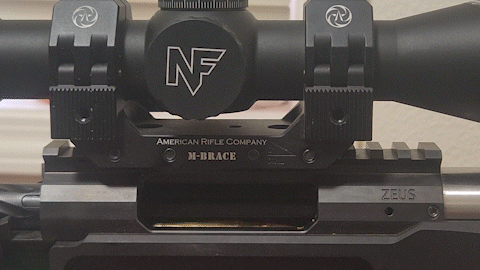

Build is a Terminus Zeus, XLR Envy Pro, and a proof prefit .223 Rem.
The mags are bending at the plastic lip and causing the following issues.
1. When seating the mag the case is slightly released causing a jam or it fully dislodges one or more cartridges
2. The mags release the case early from the polymer "extended feed lips" causing the rear of the case to pop up pointing the tip of
the bullet down and jamming. (See picture with red line indicating last position the mag holds the case)
As far as I can tell with my basement gunsmithing degree these are the causes/fixes
The polymer sleeves have a loose fit between the case and the steel lip that flexes when under pressure releasing the case when seating.
When it comes to the bullet tipping down I can only assume that if the flex was removed along with the extended polymer lips the rim would catch on the case and tip the cartridge up before release rather than pointing it down.
Any help is appreciated. starting every PRS stage with a jam is no fun.

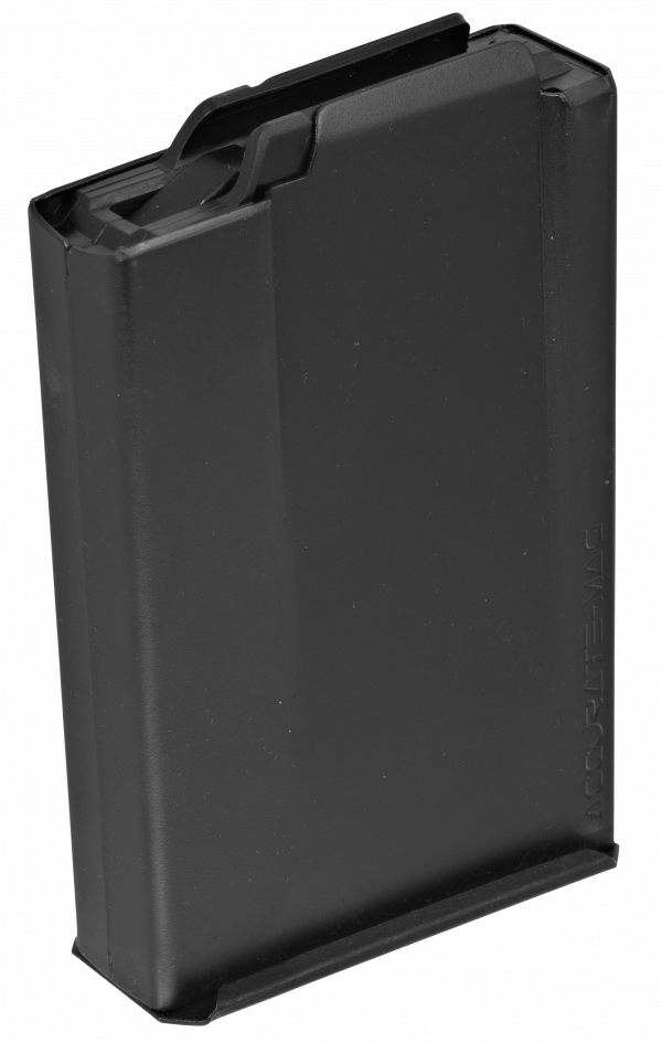

Accurate mag has an extended version too where the polymer goes past the metal.
I would try to find a non extended feed lip mag and see if that works. The extended were only necessary for me to feed 223 into a ruger American where the cartridge becomes otherwise completely free before it starts into the chamber; everything else the nonextended seem to be best.

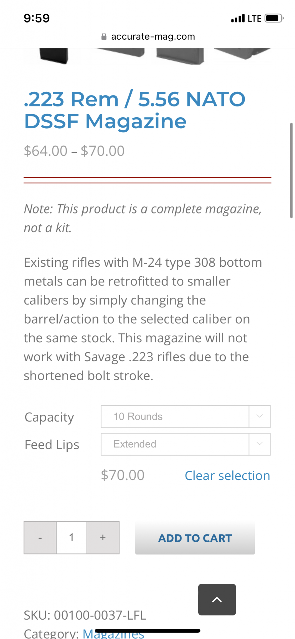

Interesting, that most be a newer offering; those weren't available when I purchased mine several years ago, accurate only had one option. On the accurate mags that I have the metal feed lips are as long as the metal supported and extended unsupported plastic feed lips on the MDT metal mag.
Have any pics of the extended feedlip version next to the regular feedlip version of the accurate 223 magazine? I don't see a pic of both versions on accurate's website.

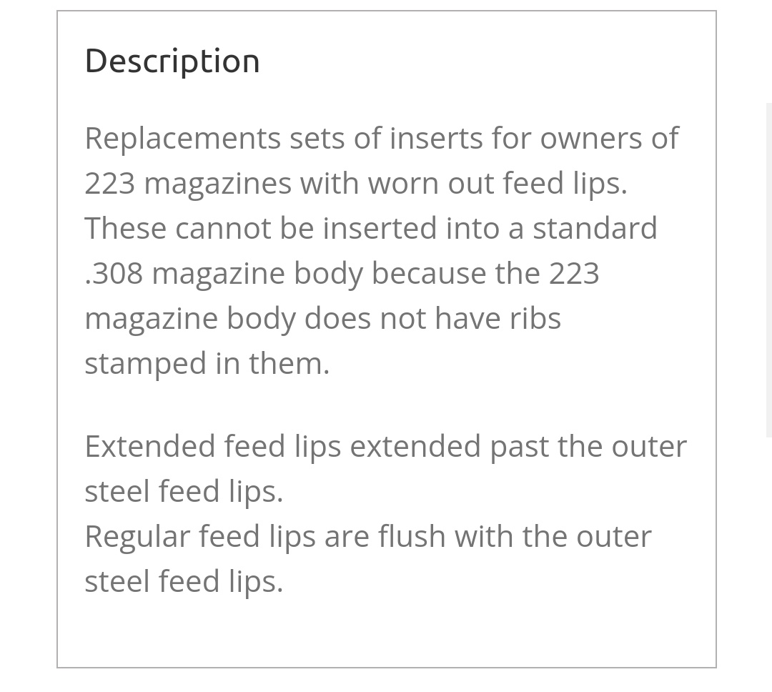

They don't even describe the feedlip differences on the magazine page, you have to look at the replacement insert page to get a description:
A newer offering years ago now.
Thanks for the pic, that's about what I expected. Nice they offer that as an option. Can't say I've ever seen the extended feedlip version offered at a dealer, but I've never looked for them either.
Also nice they now offer replacement liners. Many years ago before any of the 6br mag kits were offered I modded an accurate 223 mag liner for 6br according to a post here, and when I tried to buy a new liner from accurate they wouldn't sell me one saying they could only do warranty replacements and cutting it wasn't covered by the warranty (lol.) At least now you can buy replacement liners right off their website. Guess I'll finally put that one magazine back in service, I'll also buy an extended feedlip liner to test since they're very inexpensive. Not sure it will help with anything but for $10 I'll test one.
