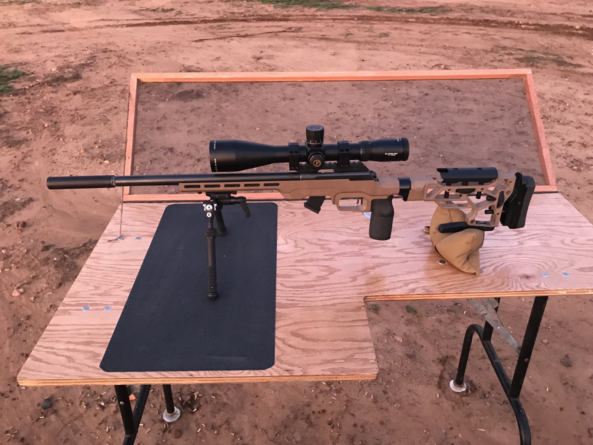

I would. I picked up an ACC not too long ago and I absolutely love it.
I just ordered a VuDoo and it too will reside in the ACC.
The amount of adjustment and the ability to balance it out is a very nice feature.
I love the rail length on it.
One thing I found out is that because of the barrel channel length and running the VuDoo with an 18 inch barrel, the barrel might not make it past the barrel channel.
To fix this, I went with a 20 inch barrel. The barrel will stick out about an inch and a half. Not sure what the CZ barrel lengths are.

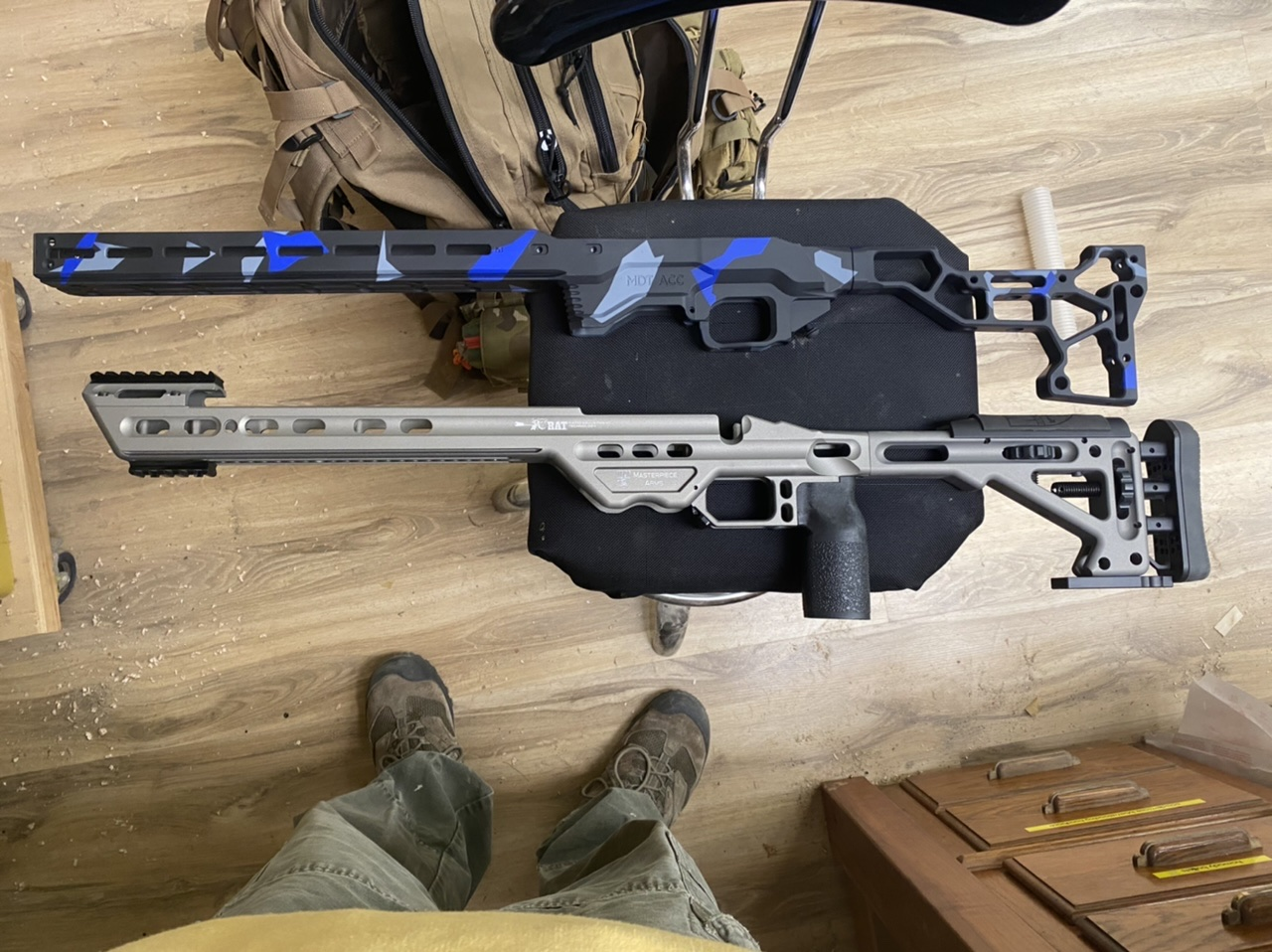

I have a CZ457 in an MDT ACC Chassis, I love it. The whole rifle with chassis is for sale by the way, if you are interested. Only for sale cause I’m considering upgrading to the new Zermatt Rim X.

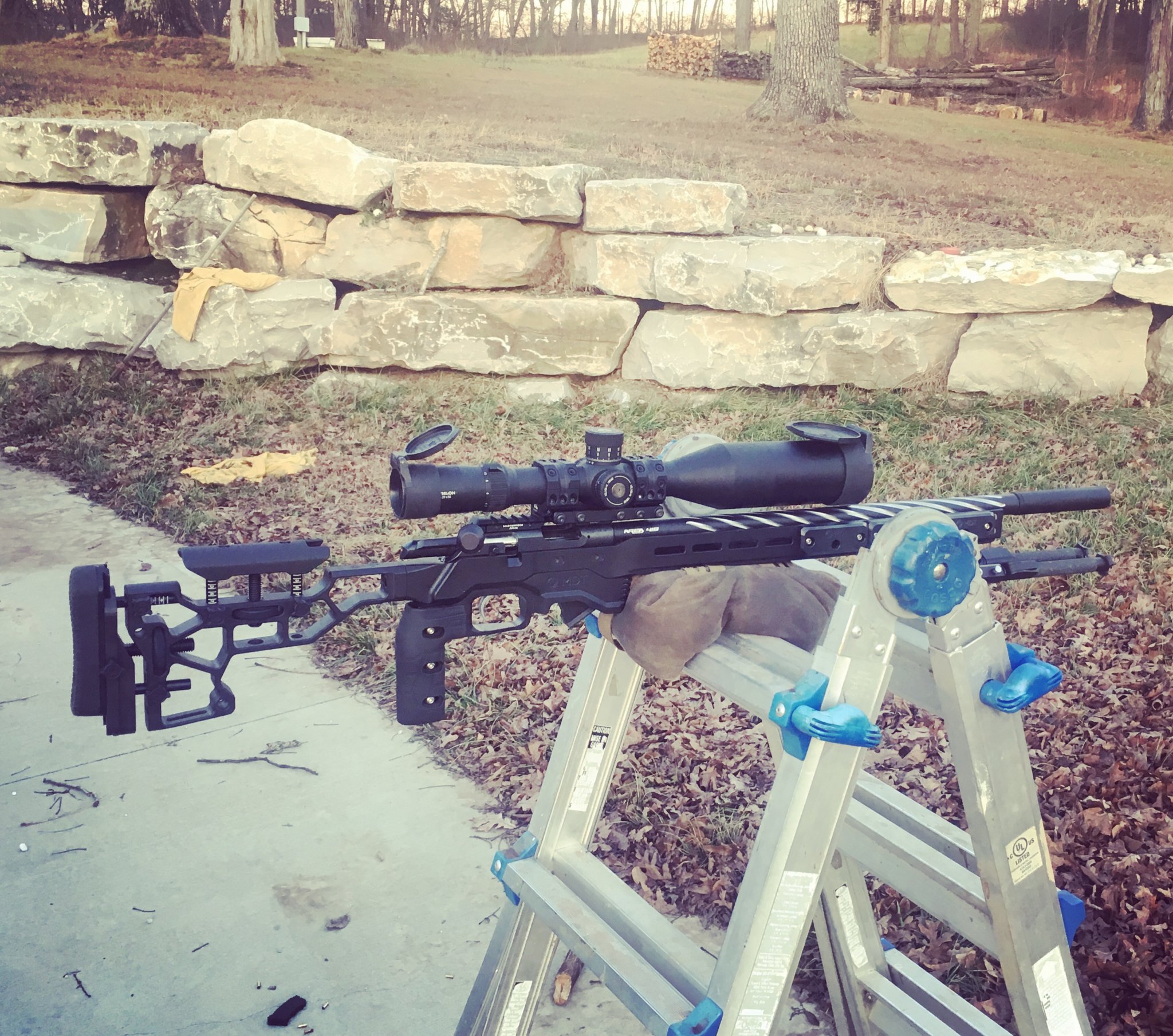

I looked at the ACC and have several other MDT chassis I have been really happy with. In the end I went with an MPA due to the length of the forearm on the ACC. I like 16” barrels so the forearm would have extended about 4” beyond the end of my barrel. The chassis that MPA makes for the CZ is also significantly lighter out of the box as well. I Know both can be tuned but I don’t know how light you can get the MDT ACC. I am considering putting my Tikka T3 in an ACC however to see how I like it.
