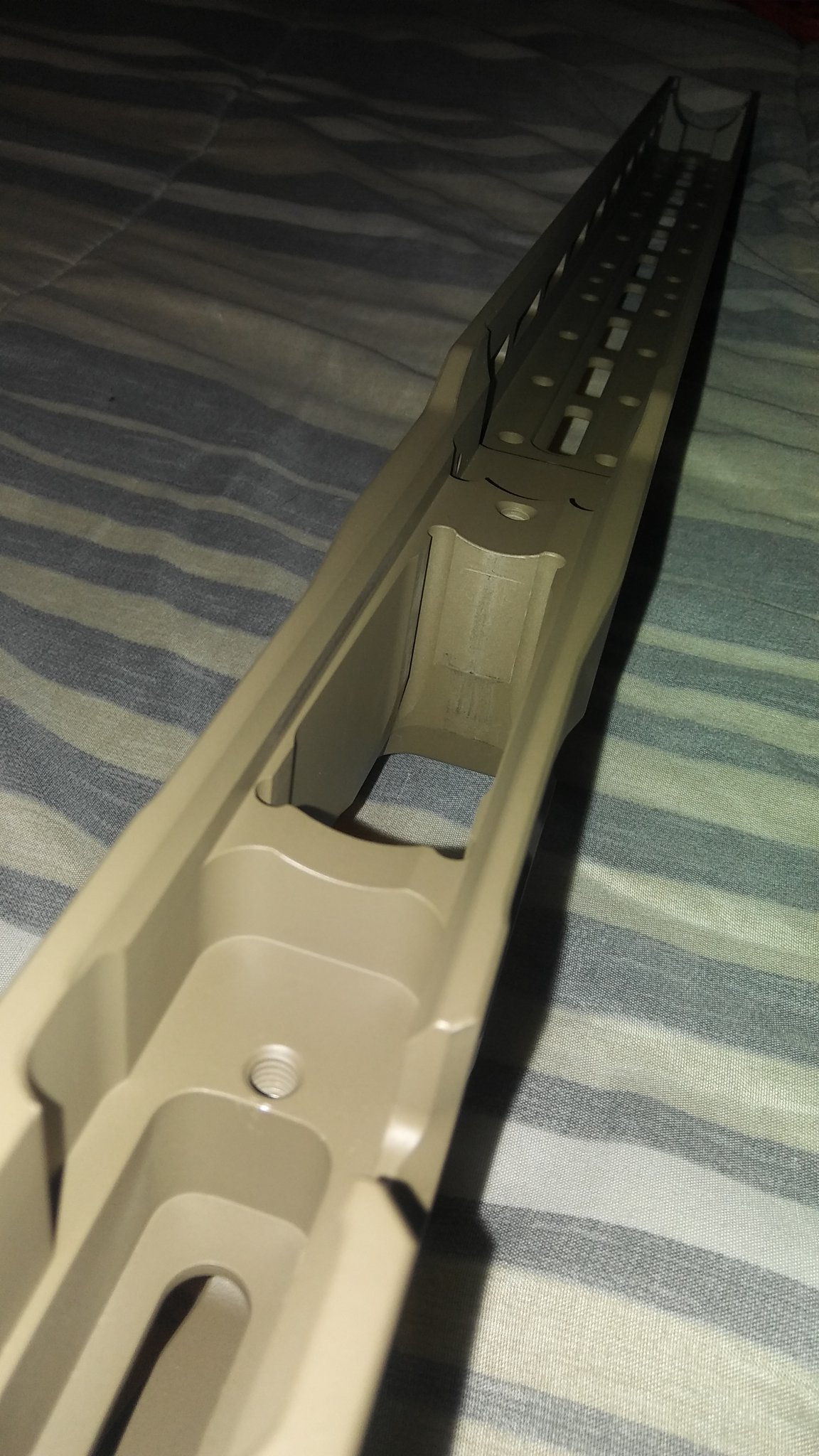

First post here been lurking for a while. Just got an MDT ACC for my Howa 1500 SA that was in a KRG Bravo chassis. The inlet on the ACC has some center semi circular cuts behid the recoil lug and at the rear of the mag well where the action sits but the Howa has a flat bottom which is what I would have expected. There are flats on either side but it has much less surface area to contact. It seems odd and I have emailed MDT. Wanted to see if anyone has pics of theirs or any thoughts on this.

Like a V block for flat bottom action?
Reduced surface area if something is not perfect?
I doubt it is a problem. They have cnc cut them.
Good question @crdixonaz ! The circular cut through the middle of that inletting is for tool clearance such that we can get the large cutters through the centre for better fit and barrel centredness. It will not affect the interface between the bottom of the action, chassis or recoil lug and we have done quite a lot of testing with this specific interface.
Josh
Reactions: trdjohn and Evintos
Josh
