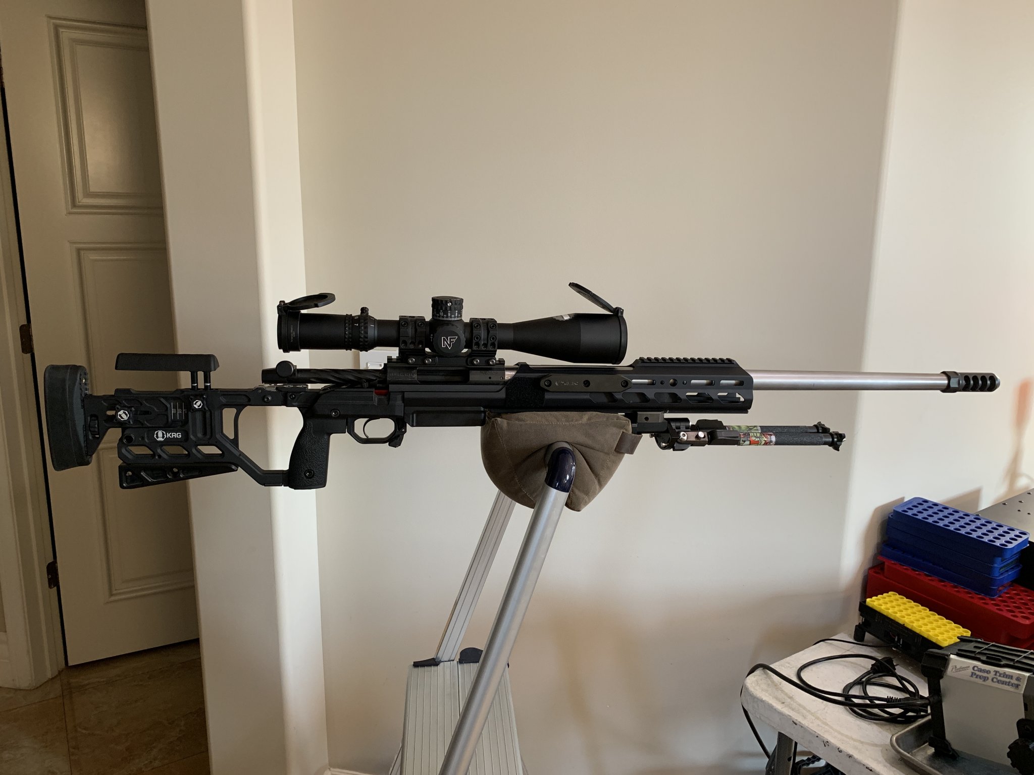

The W3 with enclosed just looks absolutely BADASS! Lol you can also add a couple lbs with exterior mlok weights from either mdt or XLR.
See attached pic for XLR weights on my W3.

ETA: here’s the pic. 2 exterior XLR weights add ~1lbs total.
