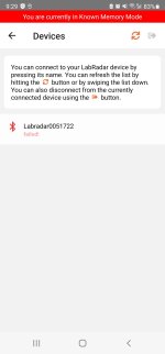

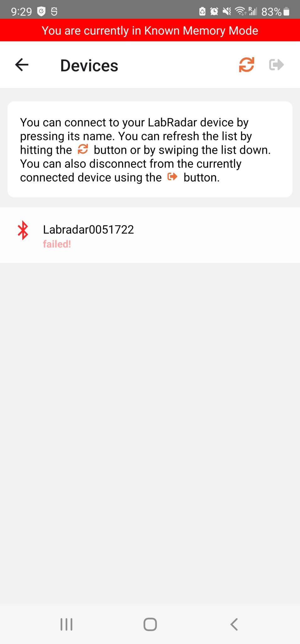

    It's too bad LabRadar won't spend time improving the Chrono app instead of coming up with some other gizmo.
    New iOS version has been out for a few weeks now. Given the now visible version history, would have been nice for them to make those test builds more available, but despite appearances they were working on it.
    New app, same shit..
    Ymmv.
