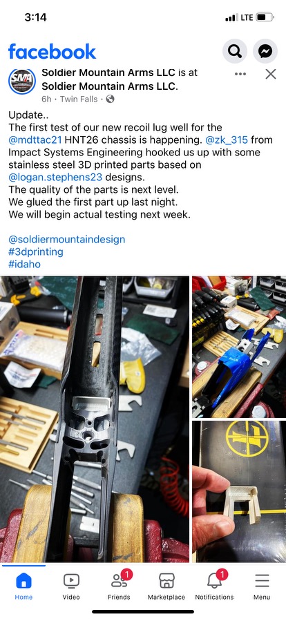

    Local shop does a recoil lug fix if anyone is curious. I don’t have a HNT26

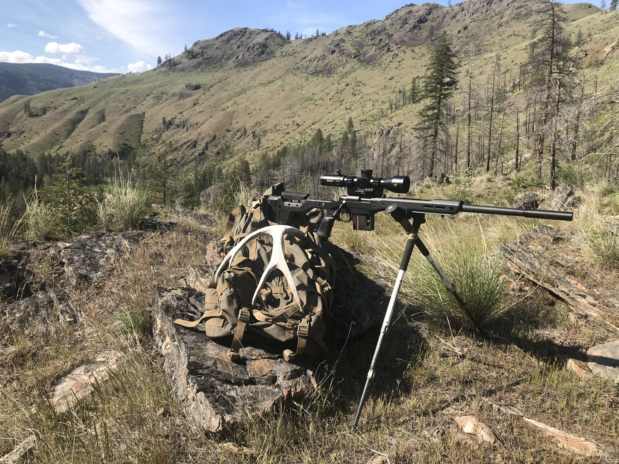

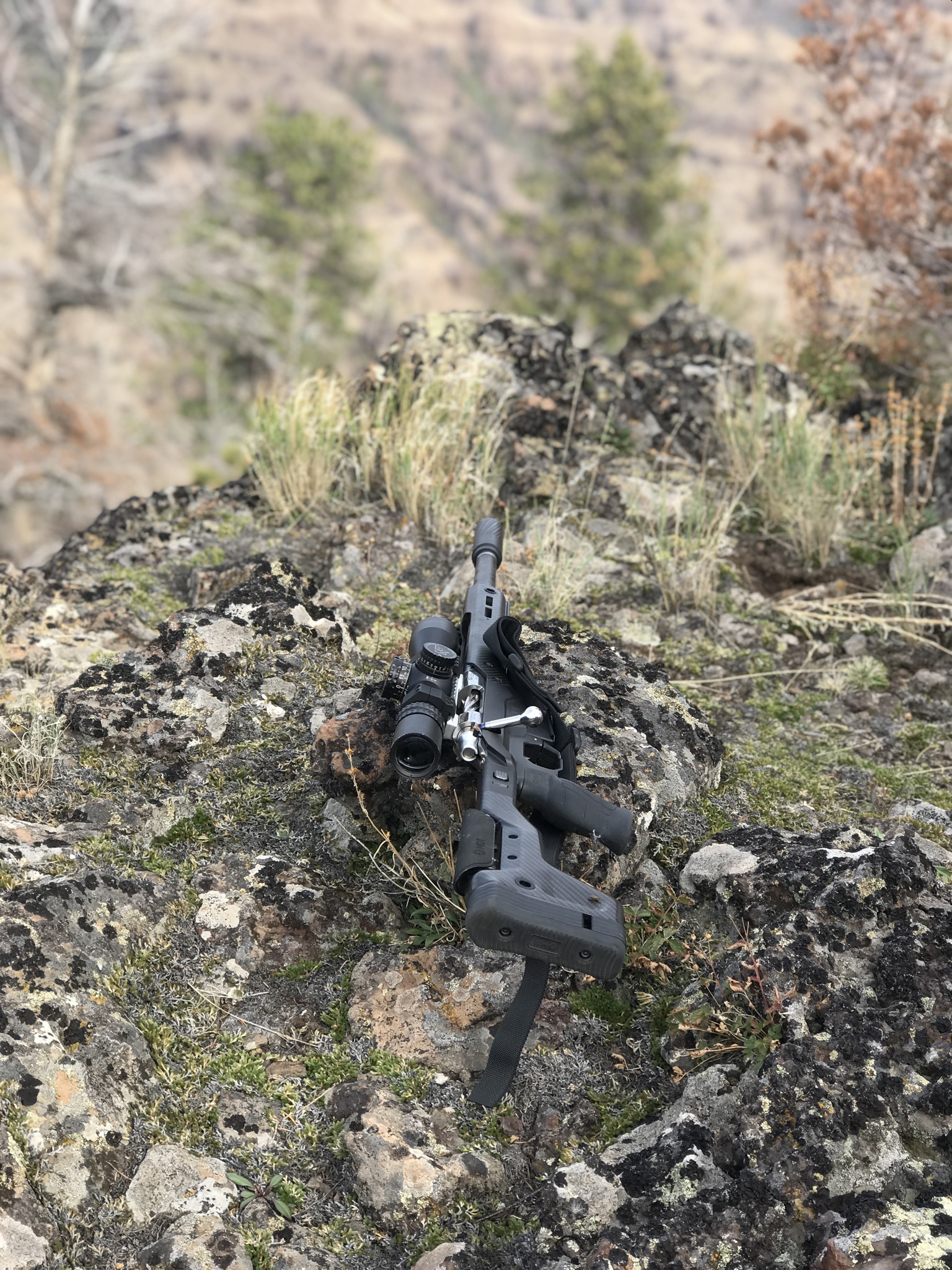

    I have tons of miles on mine, via sling, pack and atv. Hunted all over Wa, Or, ID and Mt.
    I love it.
    I run it on my hunting rifle all fall and winter and on my vudoo all spring and summer.
