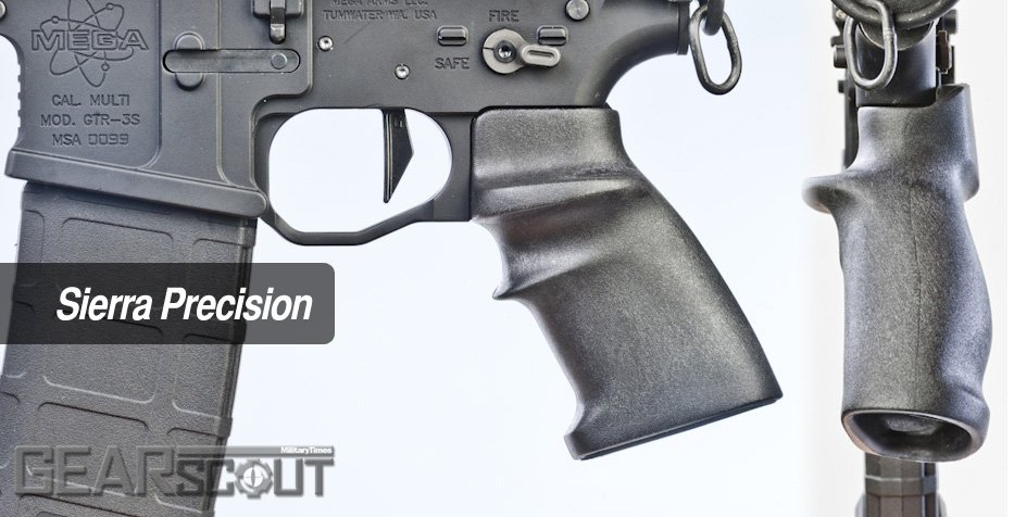

Is your vertical grip suitable for the HS3? I am not sure what grip I would like, so thought I would ask about fitment.

- We have had a few guys use the vertical grip on the HS3 with mixed results. The grip was designed and optimised around our newer chassis (ACC, ESS and LSS-XL Gen2) but is still compatible with our older chassis and other mfg's offerings. For what you're doing, I would probably recommend that you have a look at our standard, overmolded grip as it will give you a more natural grip and not force your wrist vertical.

- Looking at the pictures, I would have to say that the Sierra grip above should work on either of the chassis that you are interested in, but it may require just a little modification to the right side (as you pointed out) to ensure a snug fit.

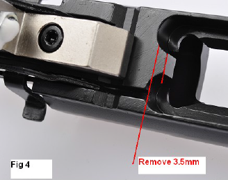

So @MDT_Josh , if we Howa users grind off this tab shown below, can any steel AICS mag work with the 1500 in all MDT chassis? That tab needs to be removed for AICS mags to work with the Howa 1500 in the Roedale chassis as well as with most DBMs meant for wood and fiberglass stocks.
KRG products do not need the bottom of the action to be modified in any way for AICS mags to work.
This will work, as will filing down the top of the magazine spine till it latches.
It is better to file down the concave radius at the front because it raises the bullet point rather than raising the base.
Either is better than shortening the magazine latch which lowers both front and rear.

Some of this has been answered here by @rgv and @308pirate but as a summary, the whole situation with our polymer/metal magazines can be brought back to magazine position relative to the action and magazine height. As you have filed off the radius on your metal magazines to get them to work, you understand how to get them up high enough to allow consistent function.
"Why not sell modified metal magazines which I know fit the Howa action in at least your ESS chassis and probably others?"
- As of right now we do not have enough demand to do a specific Howa 1500 SA magazine. The Howa is definitely one of the most popular actions that we support, and if anything, we would probably move the mag well rather than supporting a proprietary mag.
The ACC has a shifted magwell (different from all of our other chassis) and a lower (IIRC) mag latch to allow the metal mags to work flawlessly. The polymer magazines will latch into this configuration, but will not get the rounds up high enough to ensure consistent feeding.
Hope this helps and feel free to reach out to me if that made it more confusing lol
