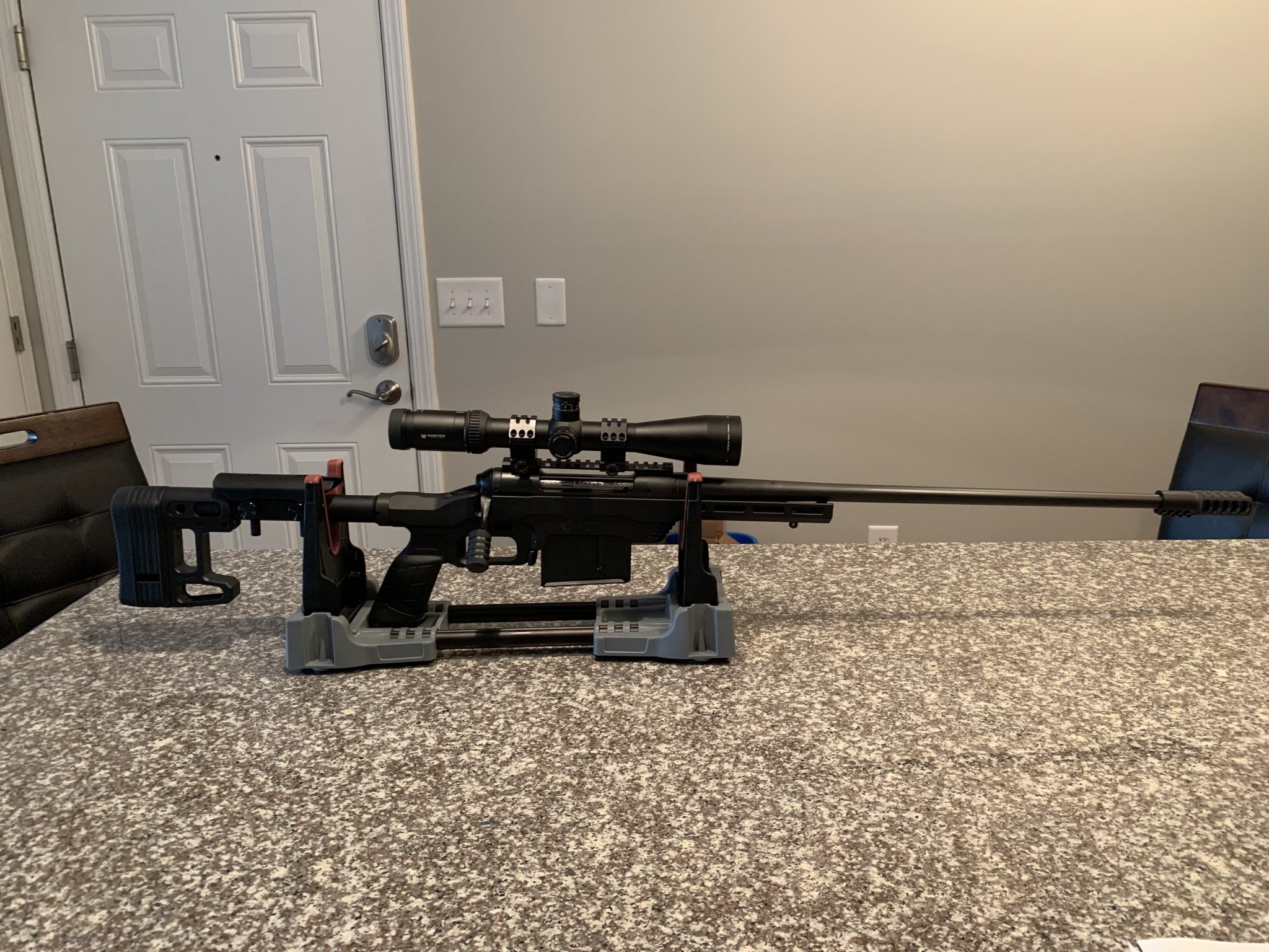

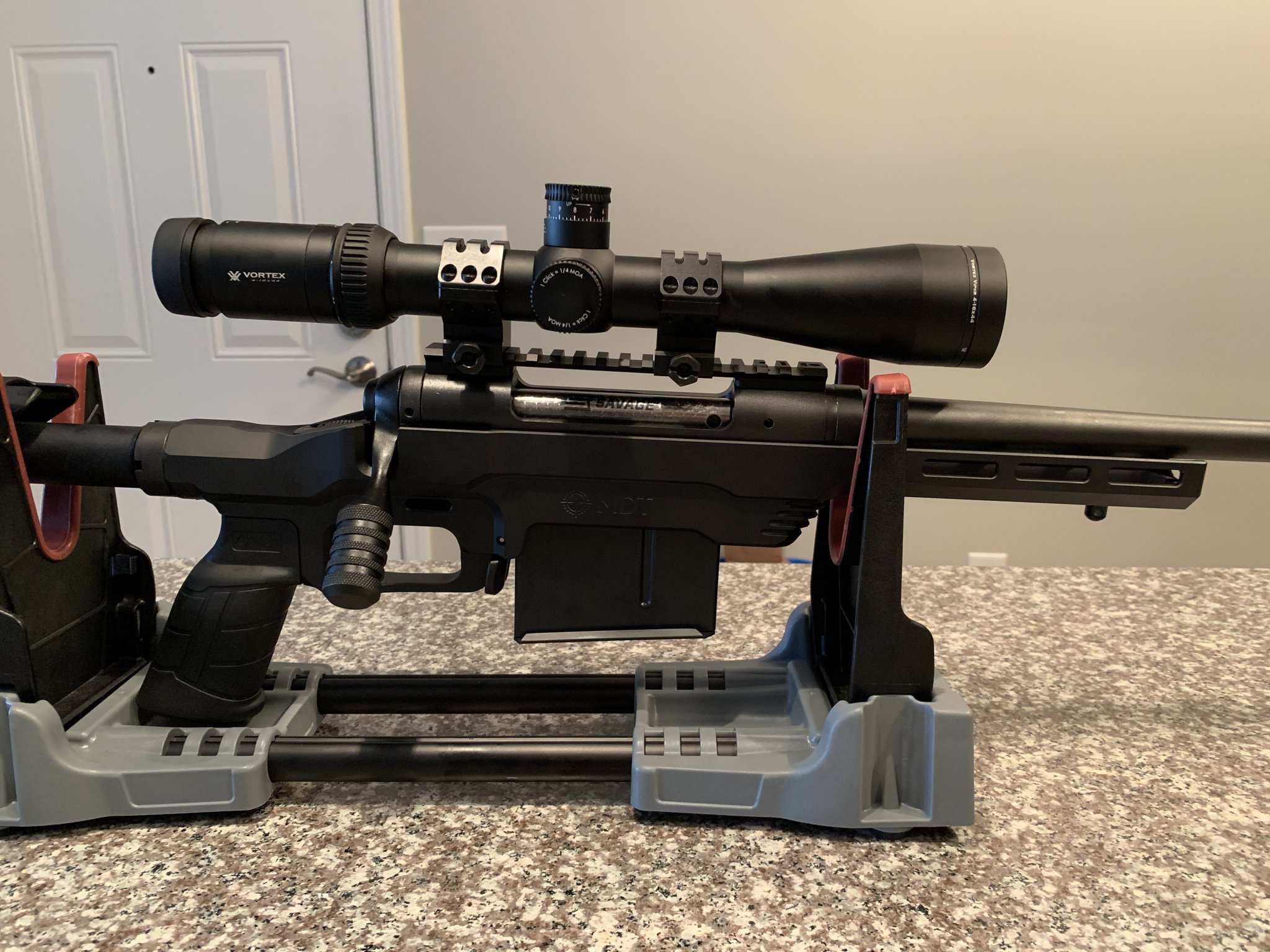

The chassis arrived and it is installed on my barreled action. It is everything I was expecting. The quality is outstanding. Fit and finish is excellent. At about 3.5 pounds it added a little weight to the rifle but it is well balanced. Just attache the hand grip, buttstock, drop in your barreled action and tighten the action screws to 65 in/lbs. I hope the weather holds so I can get out to the range today.

I did buy Magpul .30-06 AICS 5 round mag for this chassis system. It did not work because it was too tall. I sanded the feed lips on my granite counter top for 5 minutes and low and behold it works flawlessly. I now have a 10 round MDT and 5 round Magpul for this chassis system.
