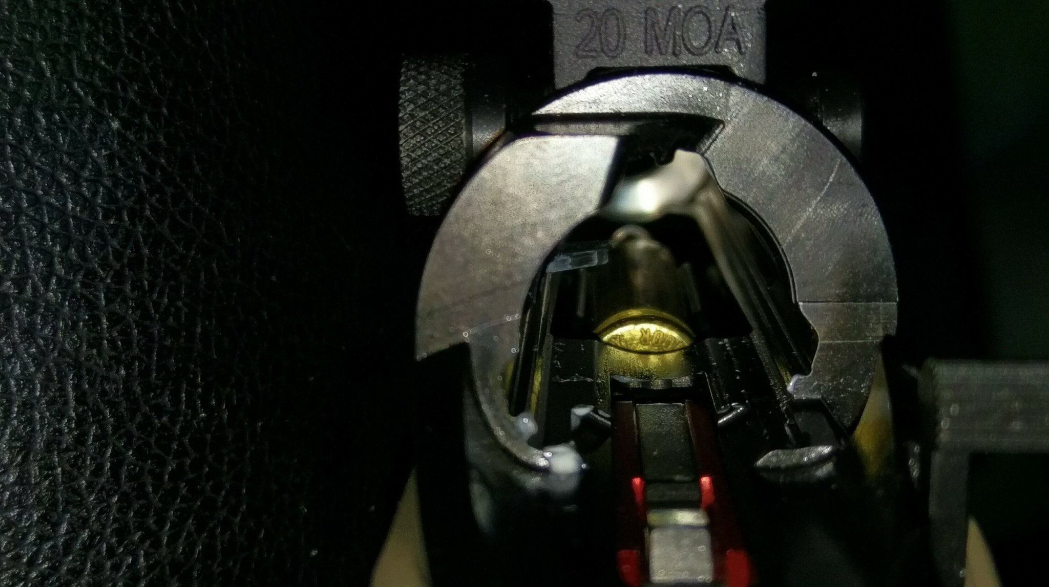

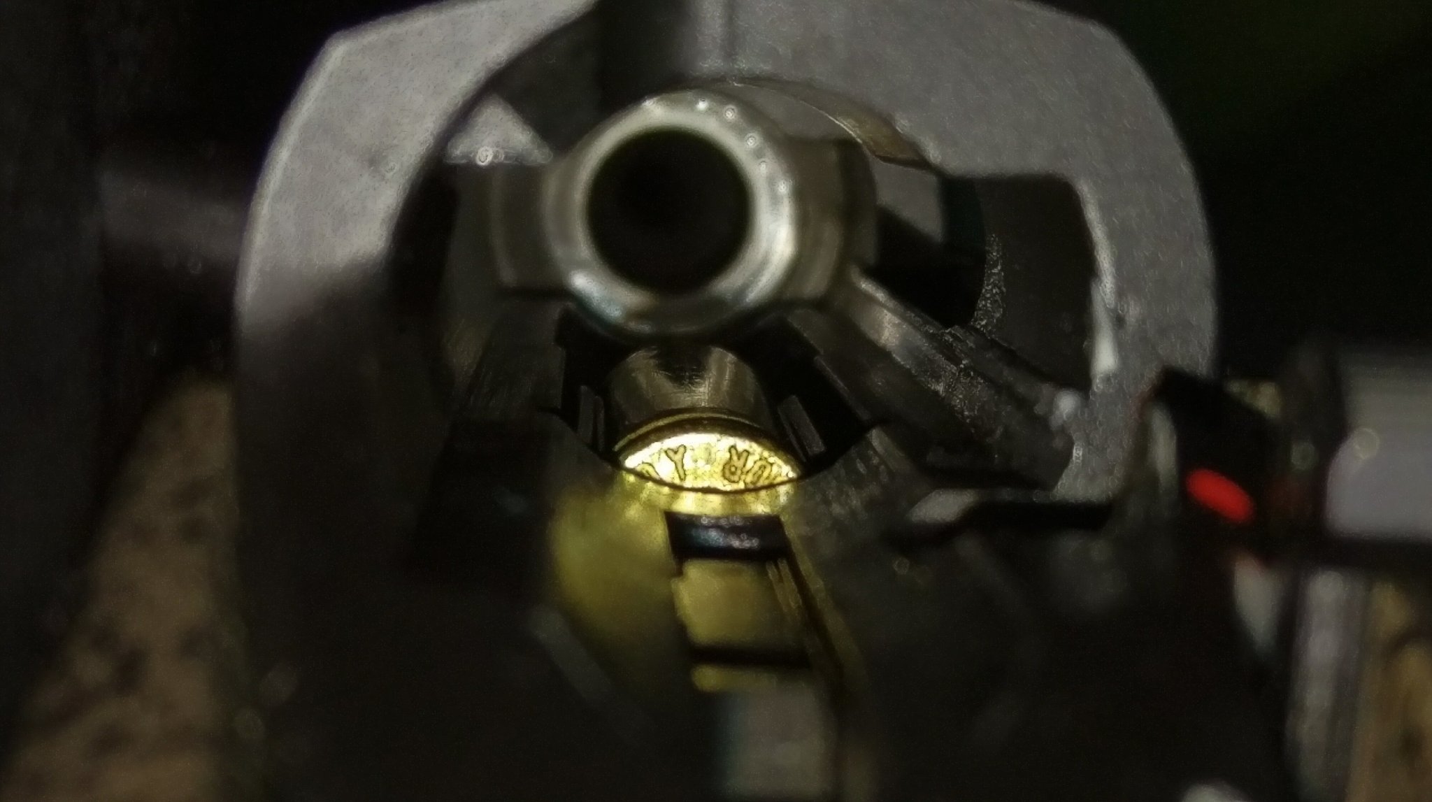

    With a round in the magazine, mag inserted, with the bolt just forward enough to touch the back of the top round as if you were about to chamber the round. How much of the bolt nose is contacting the case head? Now perform the same check on your 2 lug action. You will probably see that the 2 lug action has more overlap (two circles stacked on top of each other - bolt nose & case head). It varies action to action.
    You can open up the mag feed lips to raise the top round. Even .020” - .040” is enough to solve the problem and increase the overlap between the bolt nose and the top of the case head. Make mag lip adjustments evenly, and in very small increments. It often doesn’t take much. Use a mag lip tool like MPA sells, or smooth jaw parallel plyers.

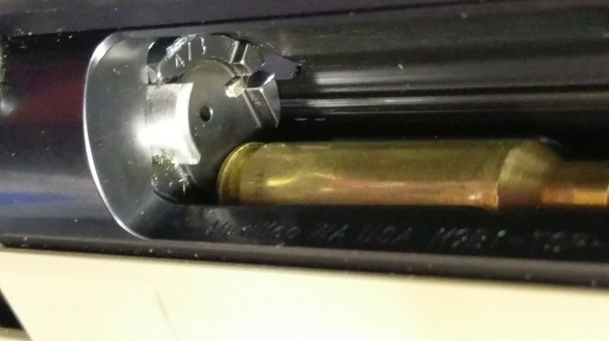

    I may have found the issue, the mag lips only contact the case at the very front of the case, right at the shoulder. This allows the back of the case to rock up and down in the mag.
    I opened up the front of the feed lips slightly allowing the back of the case to make contact with the mag lips. This seems to reduce the rocking up and down of the case head.

    Here is a pic of my Nucleus before I did anything. Bolt case contact appears fine.

    The case protrudes into the bolt head path about the same 3 lug and 2 lug.
    When I load a round in a AI mag or an Accurate mag the case is held firmly against the feed lips. In the MDT mag, lightly touching the back or the front of the round will cause the round to see-saw pivoting where the case shoulder contacts the feed lips.
    This does not happen with the other two magazines.
    7100501
    Looks like plenty of case protruding to make contact with the bolt nose. The feed lips should be making uniform, full, uninterrupted contact with the case. Can you adjust the feed lips to make proper contact?

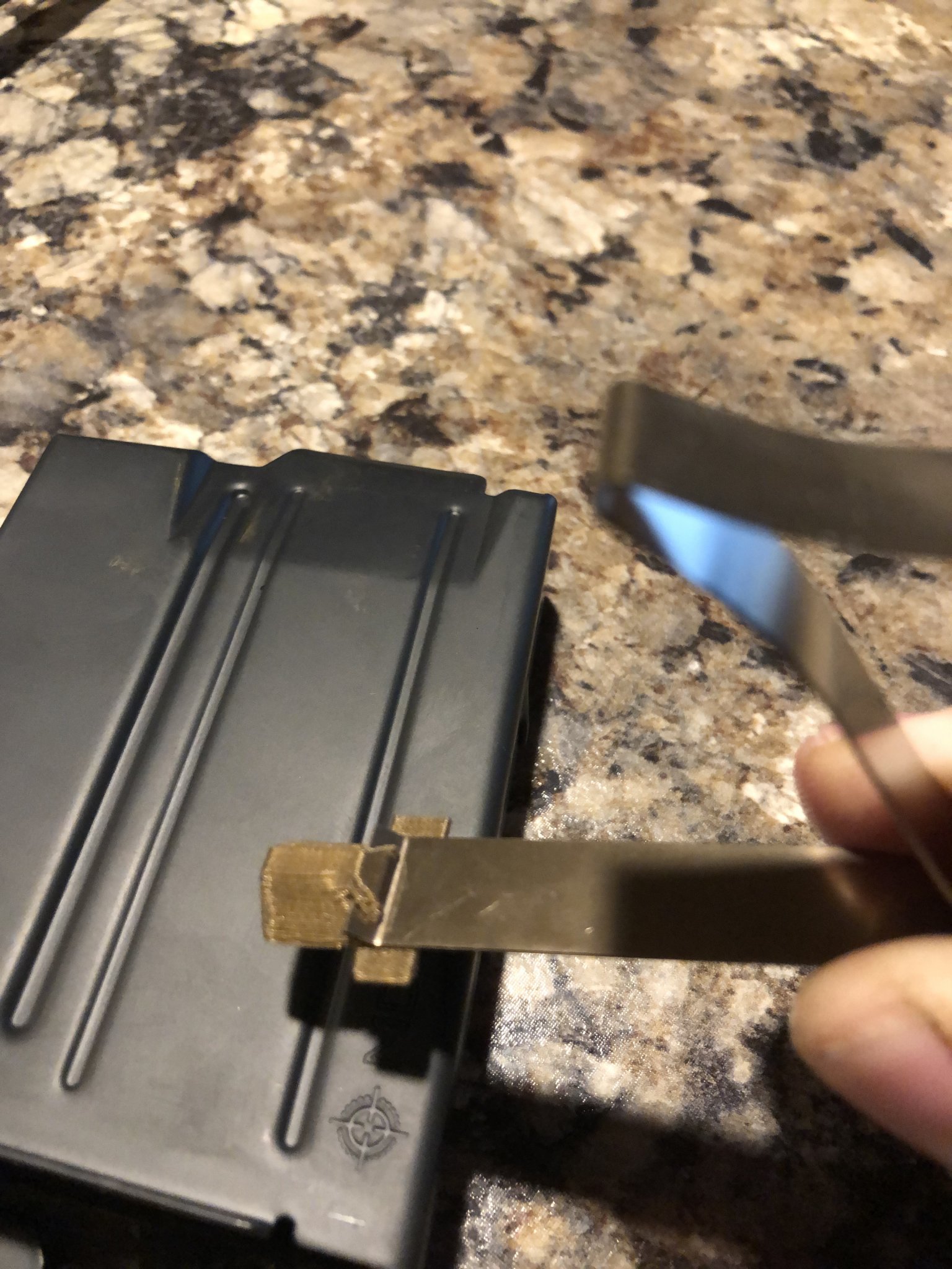

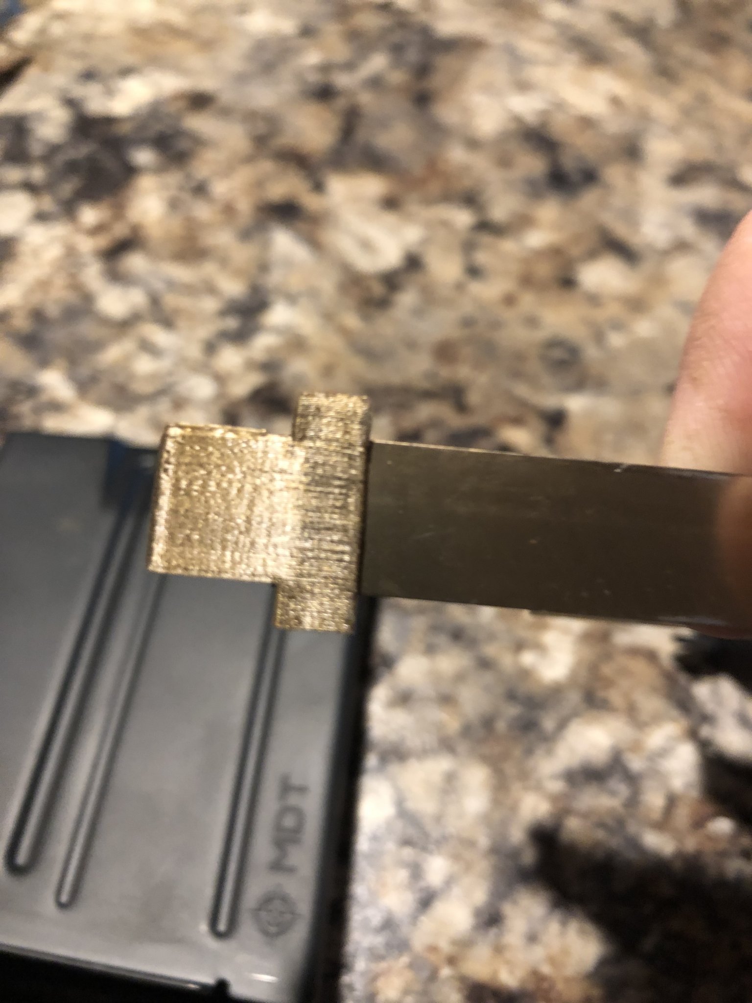

    Could you possibly post a picture of the of the modification?
    Appears to be a friction fit. I haven’t tried removing them, I’m not sure what purpose they serve. Maybe it’s so the spring can slide freely on the bottom plate.
    It was part of an update with our ten round magazines which aids in the assembly of the magazine.

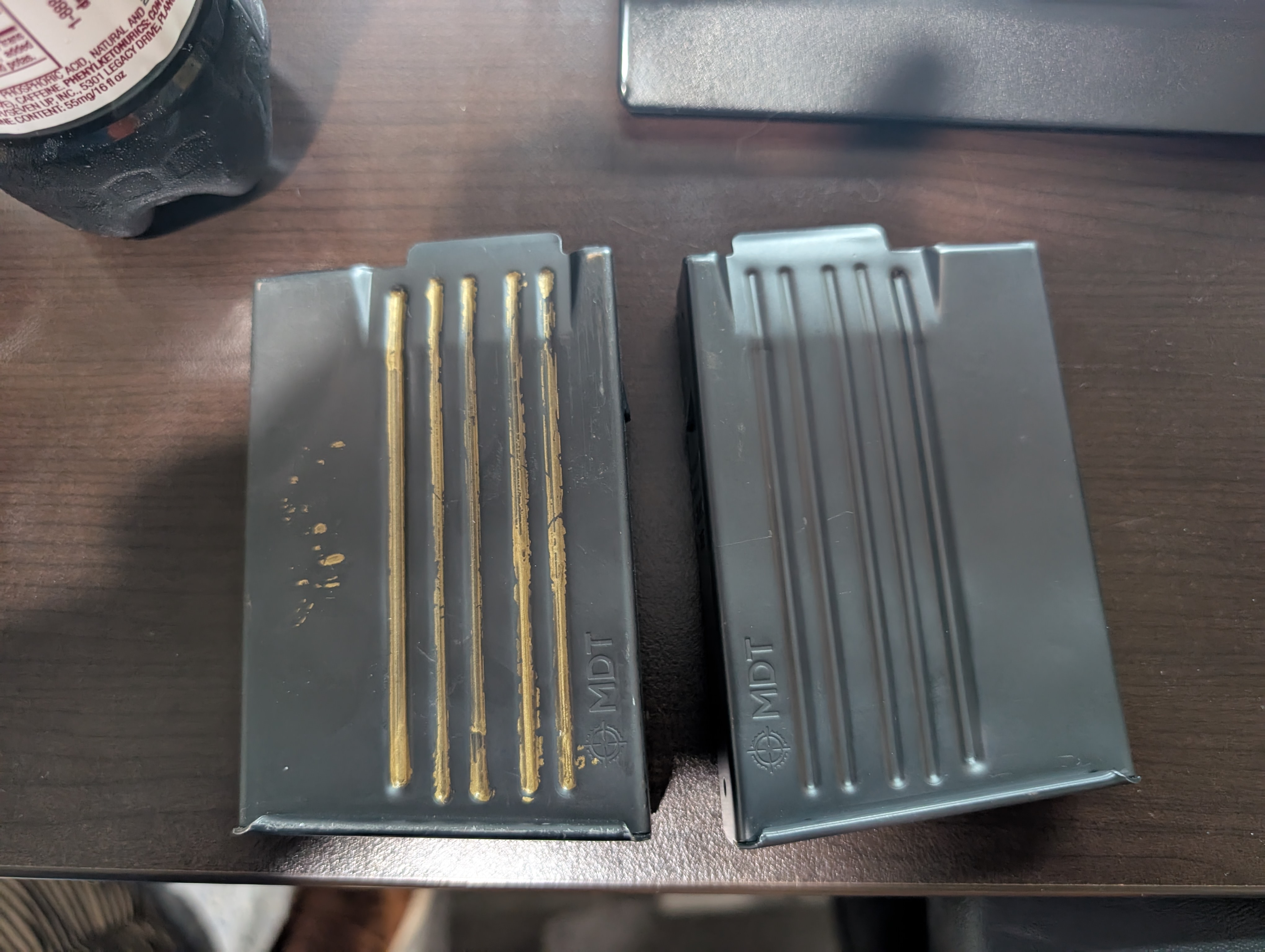

    How many ribs is on the mag? I had issues with previous generation MDT mags, but the current 5 rib mag is the best mag on the market IMO. I have ran them ALL and its by far the most reliable. AICS, ARC, Accurate, Magpul, MDT , ect. Its the only mag I use now and I have a bunch with and without binder plates. The only mags I never had feeding issues with and I shoot damn near every weekend.
    I wouldn't touch the feed lips,. Have you adjusted the mag latch on your (assuming you have an adjustable latch) on your chassis? Sounds like the mag is sitting to low. When the mag is installed with a round you want to take the bolt out and look down. You should see atleast half of the cartridge protruding. If its less than this, your mag needs to be seated higher so the bolt can pick it up reliably, especially if there is any forward or backward pressure on mag like you would get when pressed up against a barricade.
    Thanks for the info, mine have 3 ribs. I took it apart and cleaned it, also straightened up the spring as Josh recommended. I have adjusted the mag latch but it's been a while and will look at it again. Appreciate the info and help. I'm headed to the range Wednesday or Thursday so I'll see if the issue is resolved.
    These are 5 ribs. You can denote the gen of them by number of ribs ( feel free to correct me Josh 😜)View attachment 8709960
    We're not exactly on Gen5 yet 😅 The new design with more stabilizing ribs for all kinds of calibers and the improved feedlip geometry is almost "Gen 1.5", but the Gen2's are being worked on now!
    If those tweaks don't help with the last round @C130 feel free to reach out again and we'll get you sorted.
    - Josh
