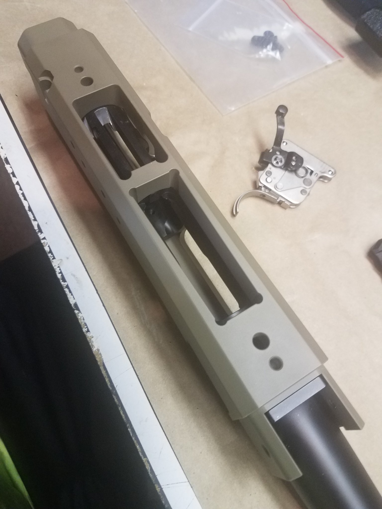

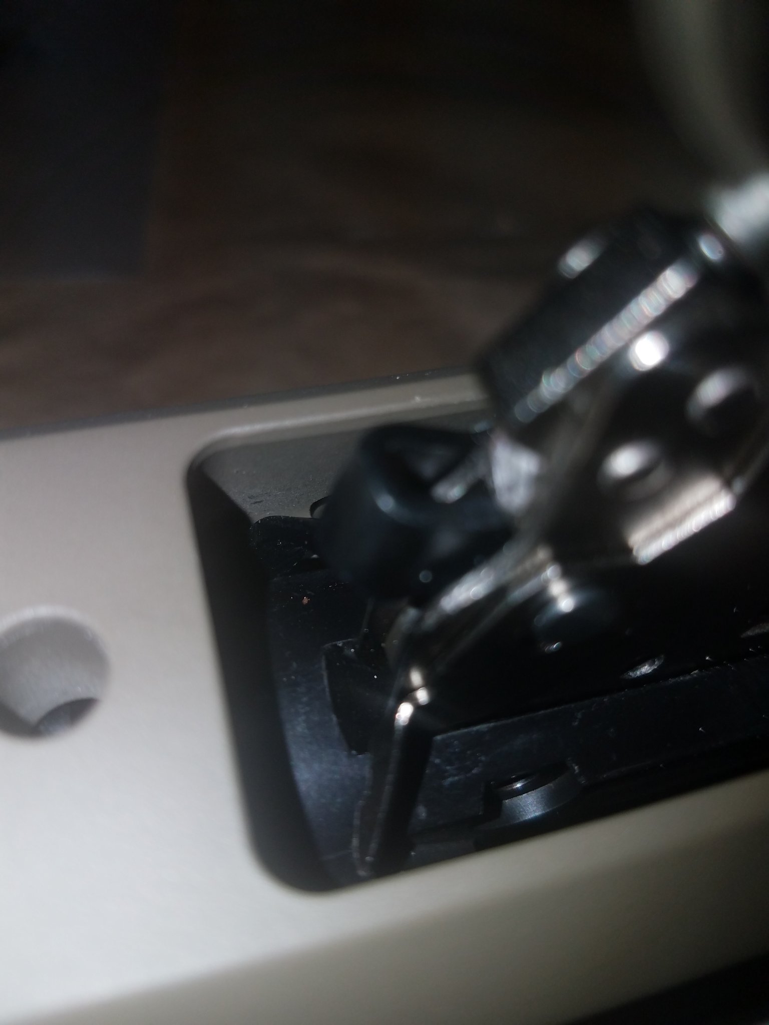

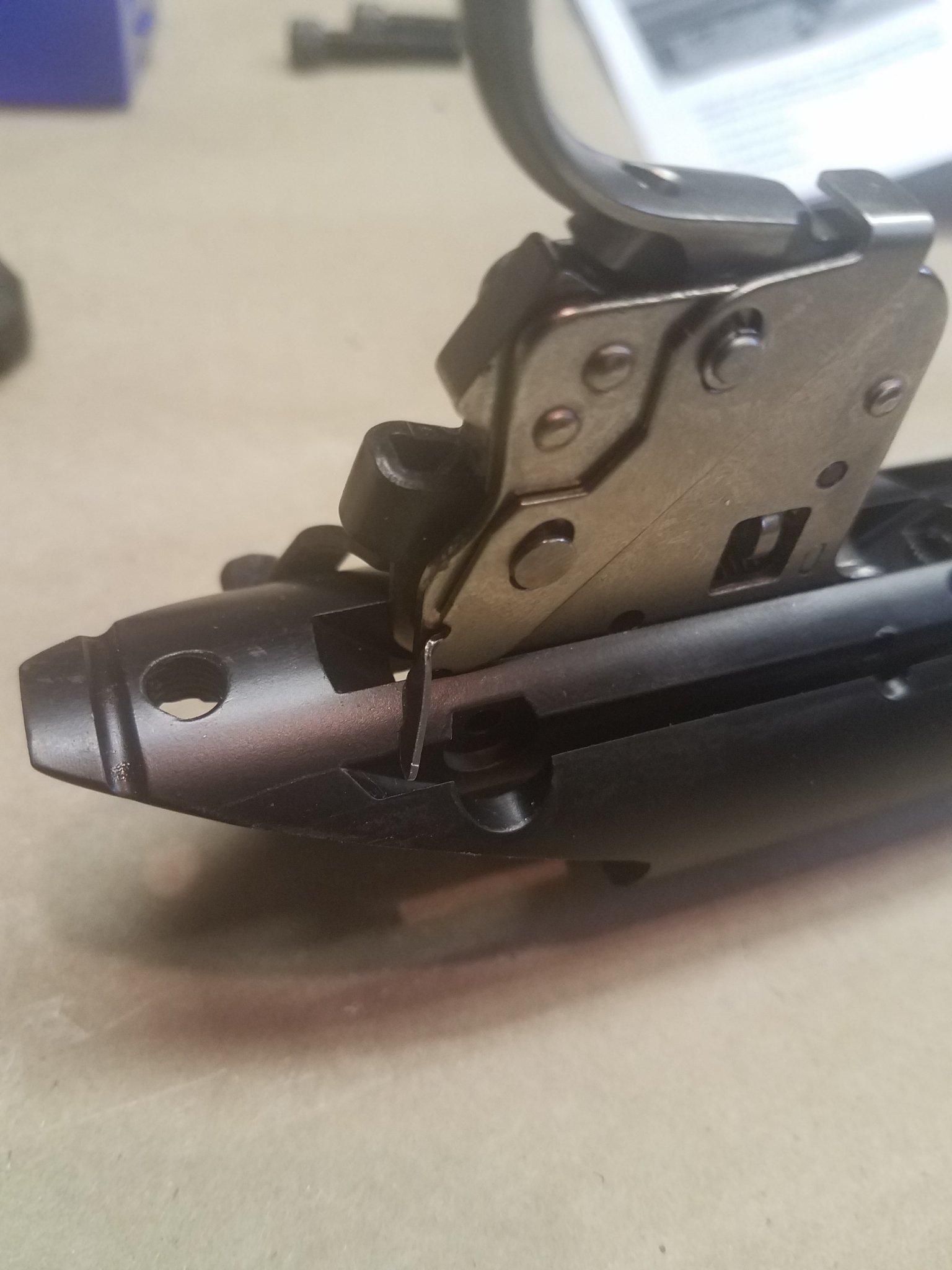

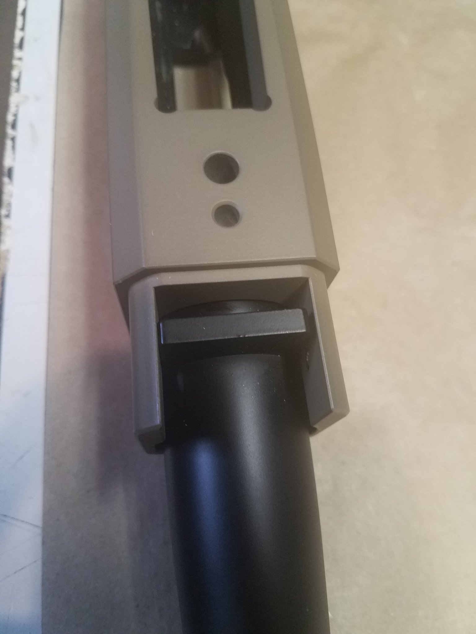

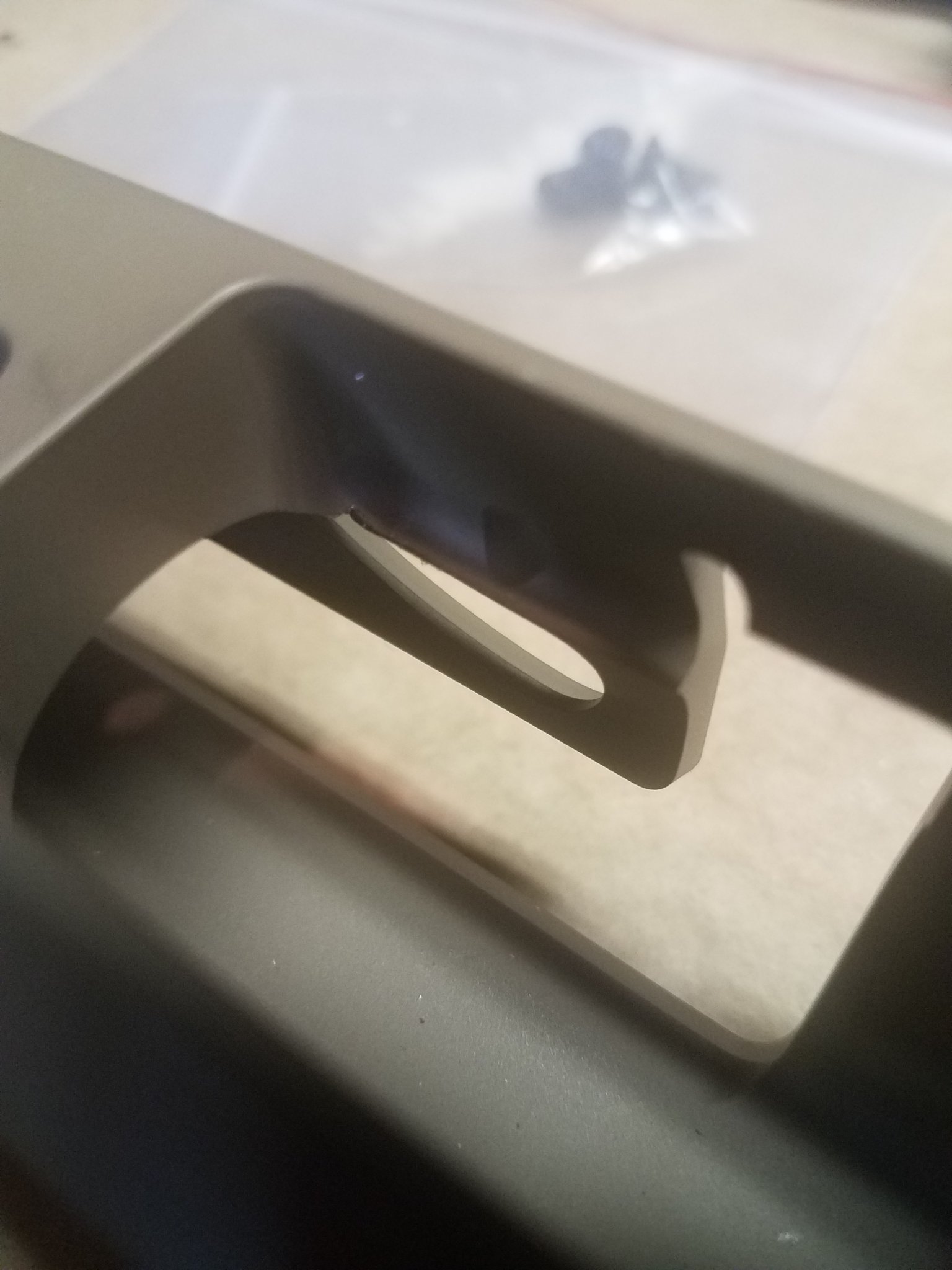

Attached are the pictures. The 2 labeled normal 1 and normal 2 are the pieces separate (1 showing the recoil lug flush and the other showing the trigger in the barreled receiver and the proper distance in the gap behind it).The two labeled wrong 1 and wrong 2 show the issue i am having. The first showing where the recoil lug stops and meets resistance and the second showing the gap behind the trigger with no gap. The picture labeled spur is where the selector safety switch is hitting and not letting the trigger slide into place or the recoil lug slide into position.

Thanks for the reply guys. Got in contact with MDT and turns out the housing was milled wrong and missing the cut out that gives the safety selector switch room to operate inside the upper housing. I knew I wasn't going insane hahahaha. MDT's customer service was second to none and hands down incredible. They spent more than enough time trying to figure out the issue and are immediately fixing it.
