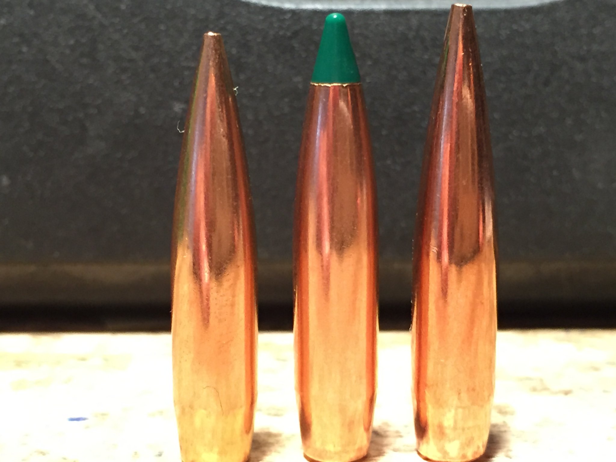

Yeah. There is a picture I can draw but I think I saw it in the Berger manual and it shows bullets of different types with the same distance to ogive
left 130g berger hybrid
center 130g TMK
right 140g berger hybrid
so the bergers are both hybrids and from what i understand so is the TMK but dont quote me on the TMK because it dont really look like it to me.
the 130g berger is 2.090 touching the lands in my rifle
the 140g berger is 2.085
the 130g TMK is 2.104
the TMK has .083 more baring surface than the 130g berger and .063 more than the 140g berger...also note that even though they are all hybrids they have a slightly different looking ogive...also the press that the bullet is made on can vary as well as other machining differences.
i dont know if that helps any.

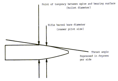

Okay, re-reading what I wrote a few posts above, I realize that I didn't really describe what I meant, so here it is in pictures. And it differs a bit from what I said above.
So, as the pictures show, what we are often referring to as the ogive, is not the same as the caliber or land to land dimension, because we are really usually referring to as ogive just happens to be the diameter of our measuring tool. Notice that the Hornady comparator insert measures .2475" (roughly, since calipers are not the best measuring device for this application), but it is marked .26, indicating its intended use for 6.5/.264 caliber rounds.
The land to land diameter of your barrel for that caliber should be nominally .264", making that disparity the reason for the question, the confusion and discussion. The disparity is the roughly 0.016" in diameter difference between the comparator measuring point and the actual caliber diameter of the bullet (most commonly referred to as the ogive). The location, lengthwise, of that measuring point on different bullets varies considerably (in relative terms).

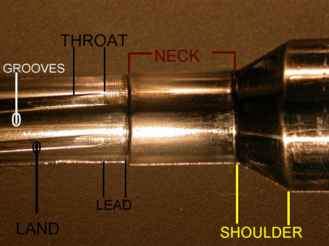

A .308” bullet will hit the lands before they are their tightest diameter of .300, at a land dimension of .300 a .308 bullet will be .008 jammed. The lands taper from .308 to .300
I’m this picture you can seen the area marked “lead” with the circular scratches where the lands are removed entirely. In “throat” you can see the scratches disappearing as the lands taper from removed to their full height.

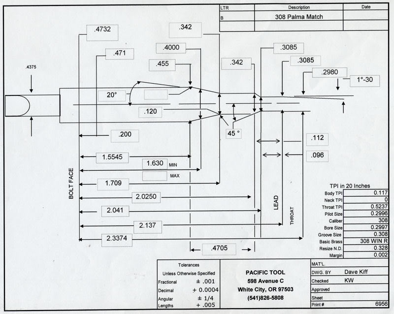

Half a thou over in this particular reamer print for googles quick return

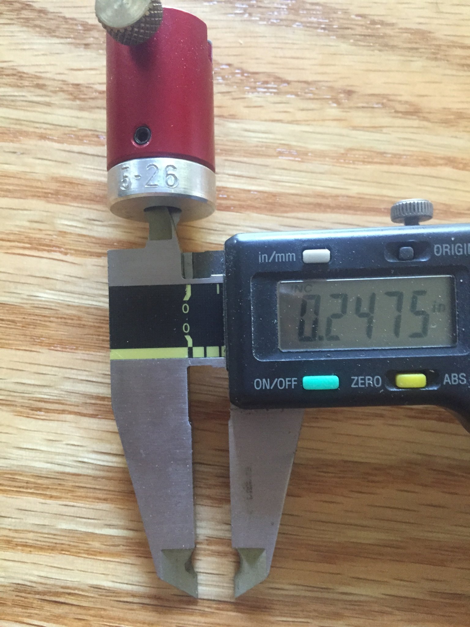

I have used the Hornady tool and find very easy and repeatable to find base to ogive. I still don't understand why but all 3 bullets I tried do indeed have a different base to ogive. The other thing nice is the 6.5 case from Hornady has the exact same base to shoulder of my fired brass, that's was a surprise. I would recommend that tool to anyone.
