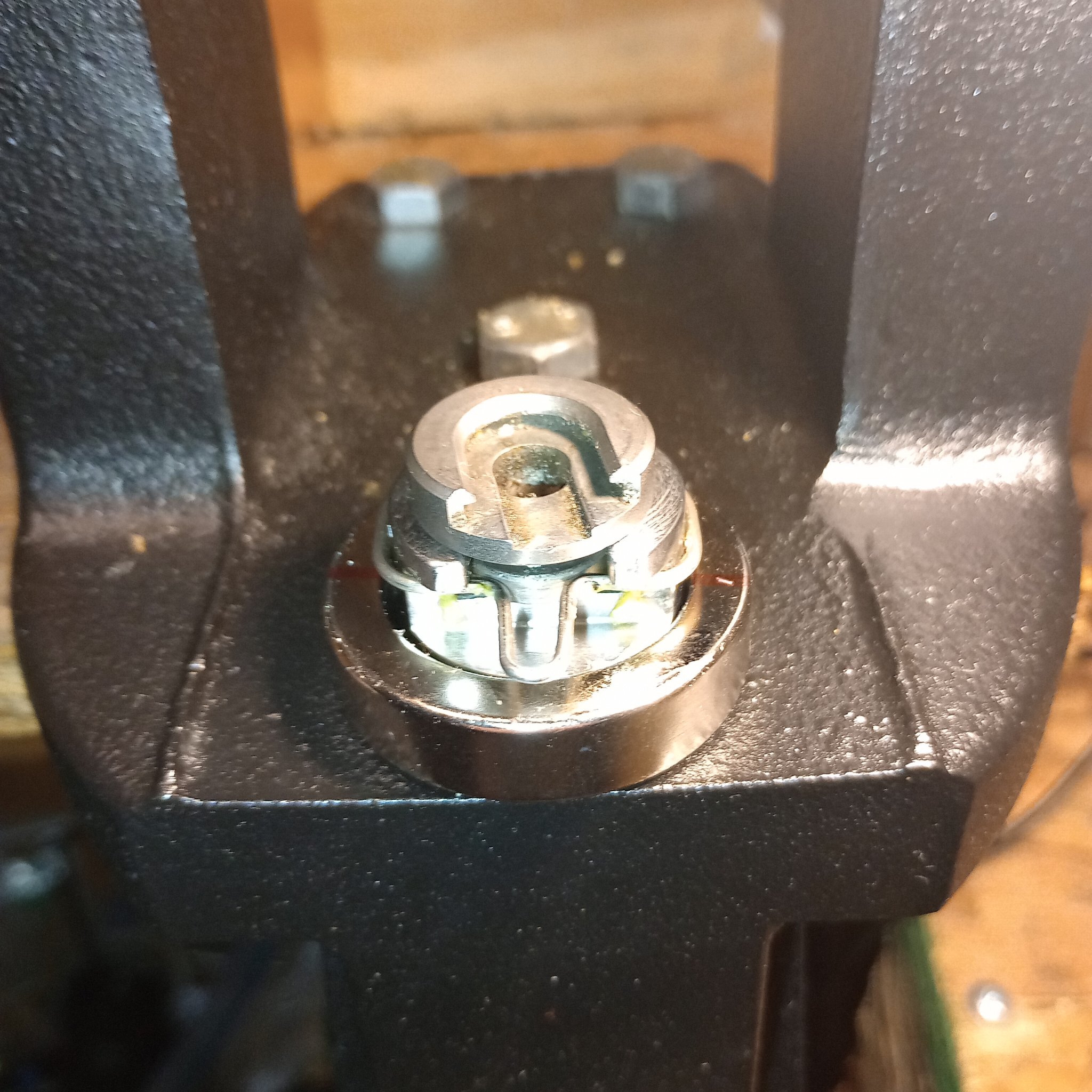

How do you like the floating shell holder?
Love mine as well. Put it on an in-line fabrication mount and added the UFO light to it. Floating shell holder is the bees knees. I don’t regret not getting the Co-ax.

Another thing to be aware of with the MEC press; if you ever plan on using an on-press primer pocket swaging die it won’t work. The floating shell holder retainer prevents most of them from working.
Hang on to your old press if you need that functionality.

I know this is old, but if it helps anyone, removing the shell holder retaining clip will allow the the swager tool to fit

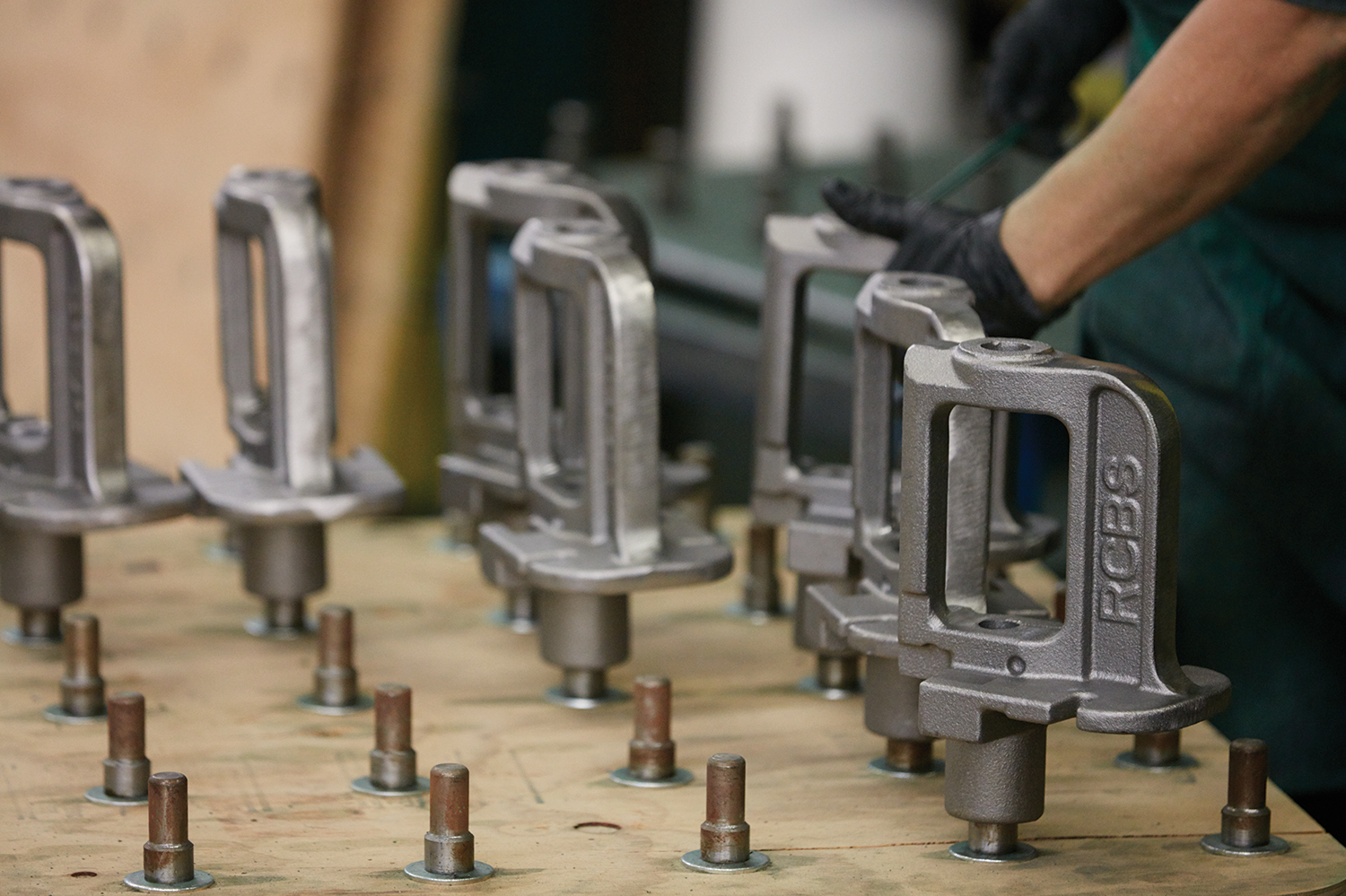

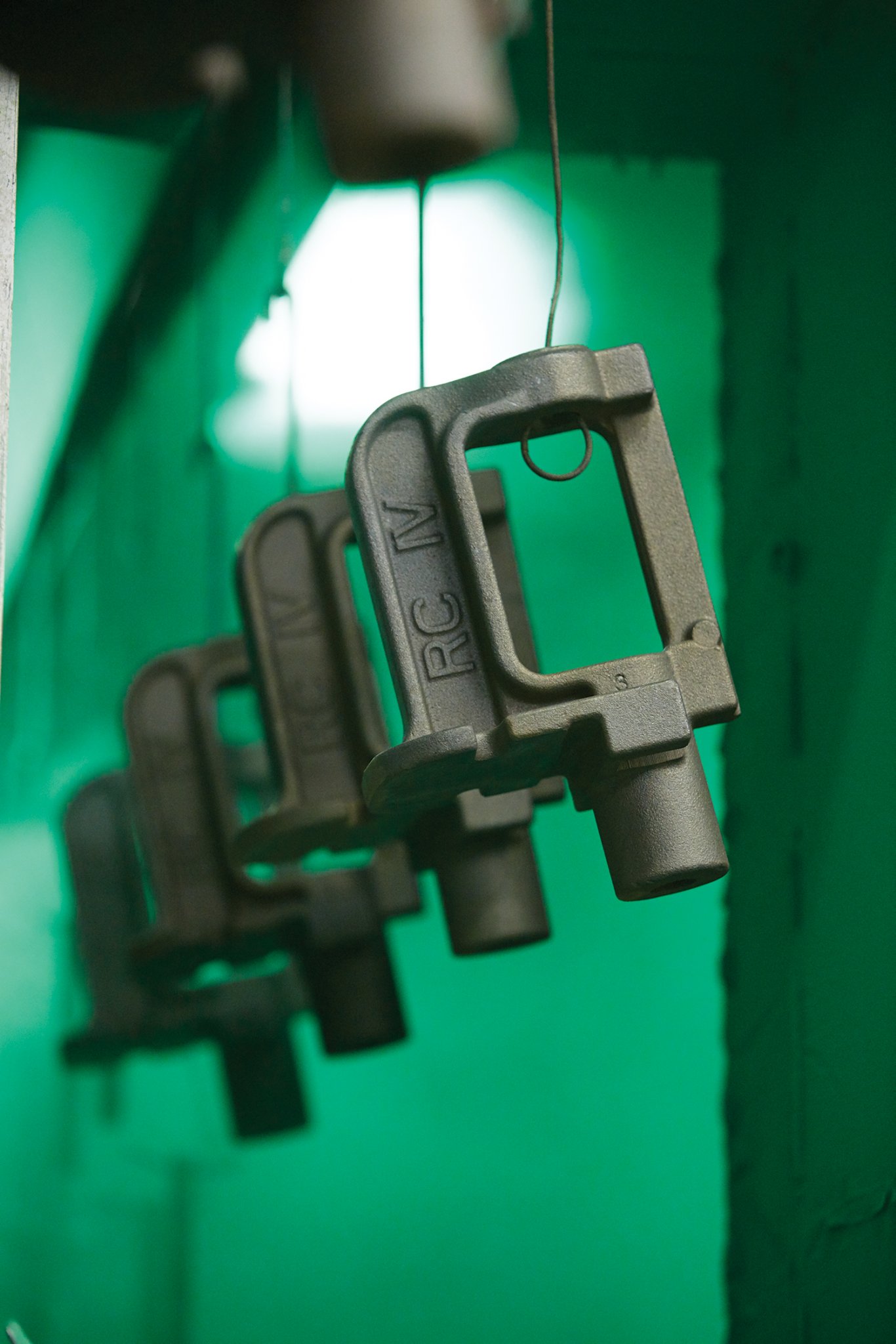

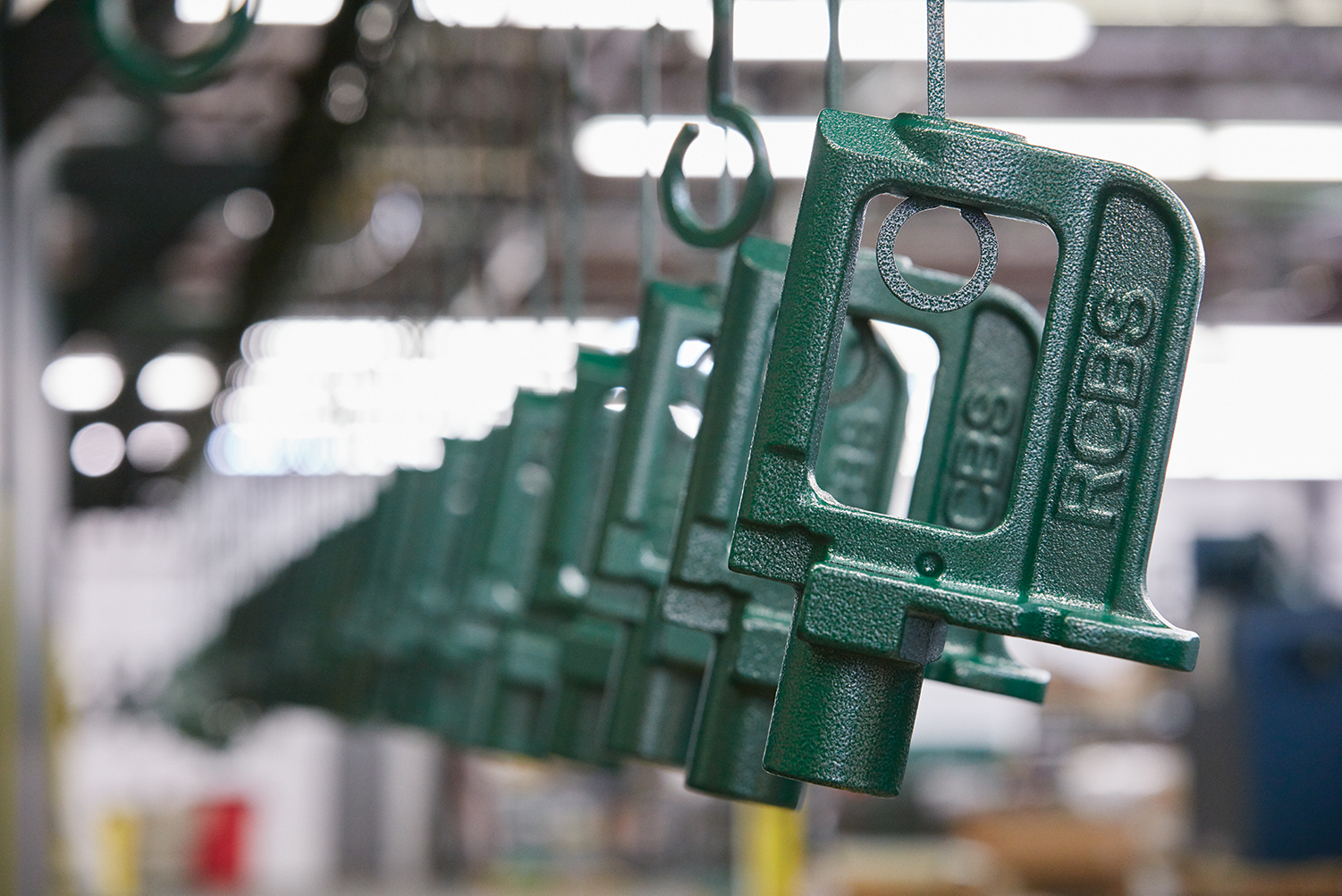

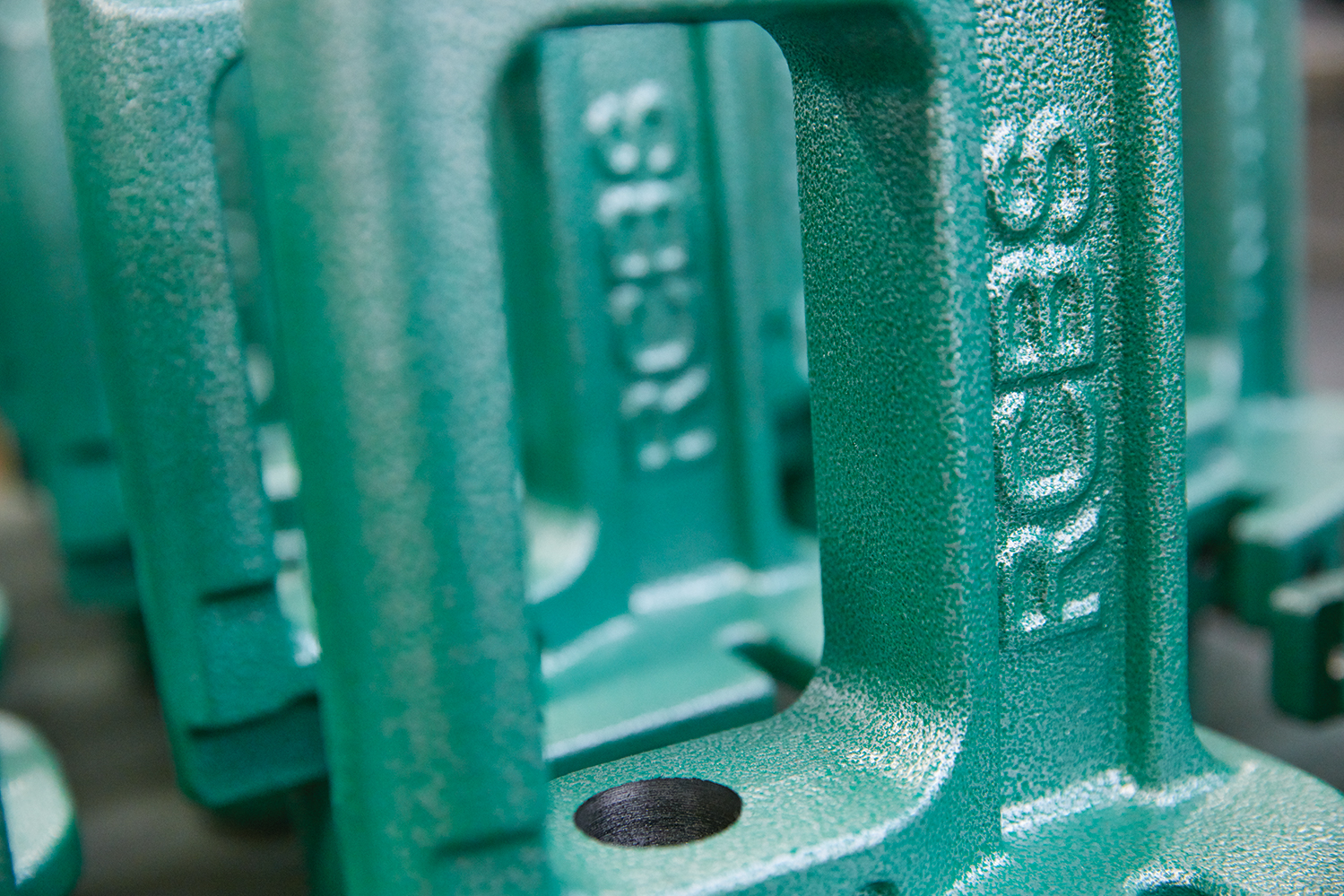

@Team RCBS & Bushnell can you confirm the Rock Chucker is now made in China?
I can confirm they are made in Oroville, CA. I have a few pics from a few years ago. I'm in the Overland Park, KS office. I can see if I can get some newer pics of the facility. Unfortunately I haven't been there on a tour myself yet or I'd have a lot more. The Rock Chucker is made in USA, not China.
