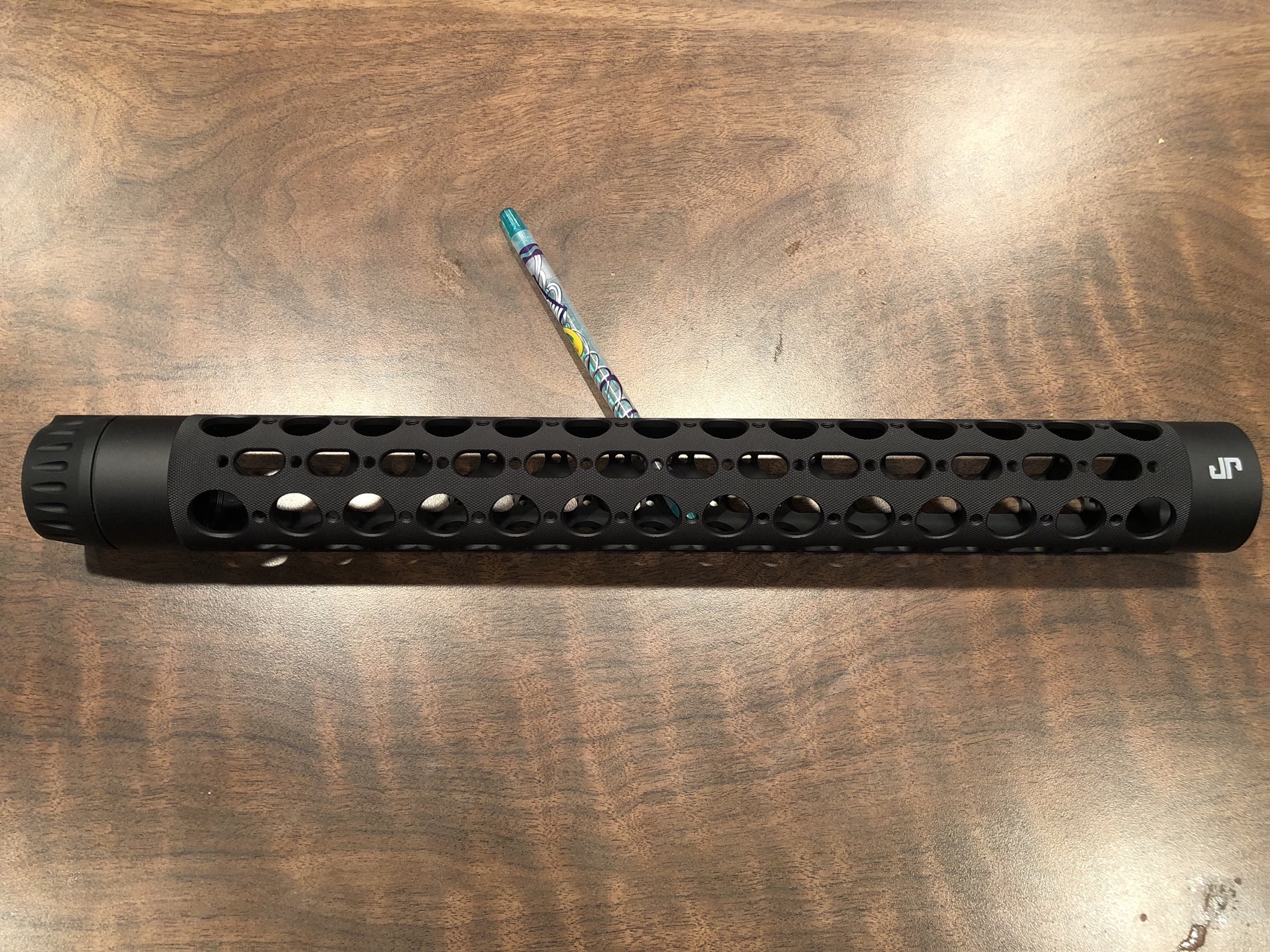

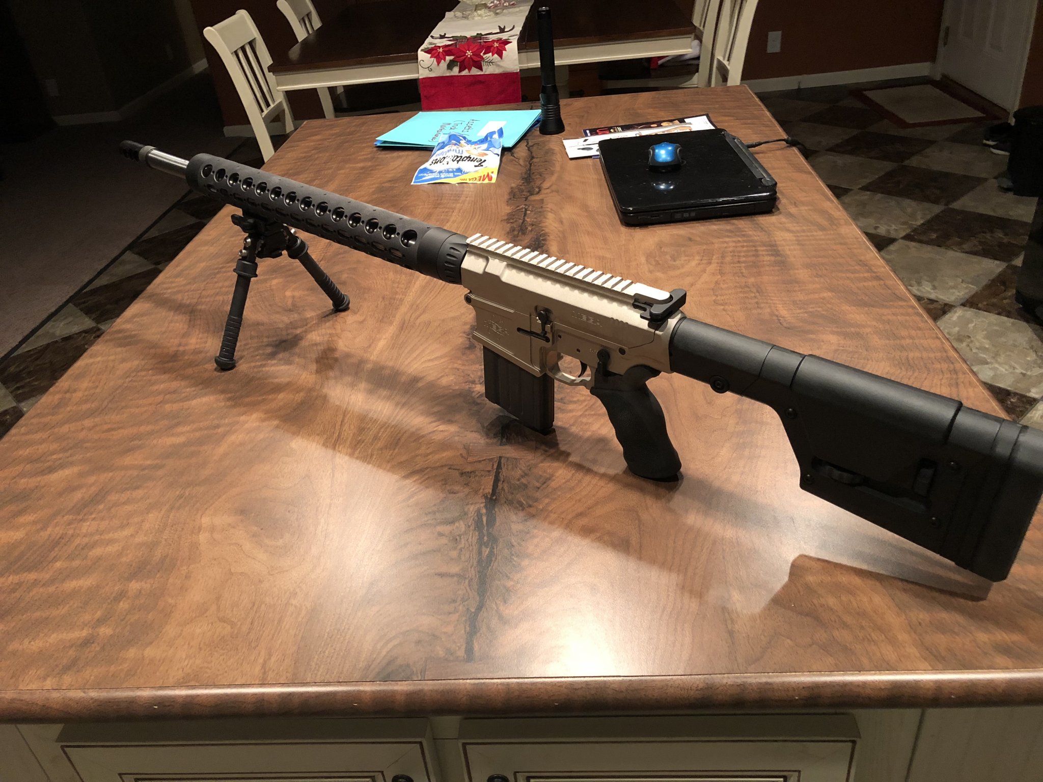

    The pieces are starting to show up. The JP guts are coming from Brownells. I have to send the bolt to John at Keystone for head spacing. One more package from OpticsPlanet and I can start assembly. I’m getting excited!

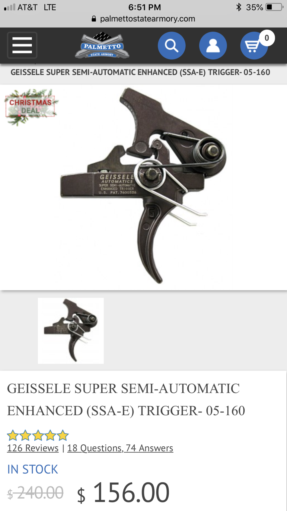

    That trigger is actually going into an AR 15 and I’m using the JP that’s in the AR in this rifle. I’ll definitely get the SD-E in the near future. Just trying to save a few bucks to go towards scope and mount.
    Other than the flat trigger, what advantage would the SD-E have over the SSA-E?
    I’m not sure how I would like the flat trigger and I found a hell of a deal on the SSA-E at Palmetto.
    Same trigger, just curved vs flat. I prefer flat on all my guns but SSA-E is great too.
    Reactions: DRAM40A1
    I guess if I’m going to do it, I might as well do it right. SSA-E on the way.

    I went through a bout of trying triggers to find something to standardize on in my rifles.
    The SD-E and SSA-E are the same trigger with the exception of the bow. I've had both and they are nice in both my 6.5 & 6 Creedmoor. Worked well in my 6.5 Grendel as well. I do prefer a curved bow myself. Tried the flat bow on both the SD-E and a CMC.
    Tried MBT's in all my AR precision rigs. They didn't make the rankings the Geisselle's did. If you can try both, do. See if you like the flat bow. Either way, an SSA-E or SD-E you won't go wrong with and if you can get a good deal on them all the better.
    ETA: that's a great deal, I'd snag it.
    Reactions: DRAM40A1

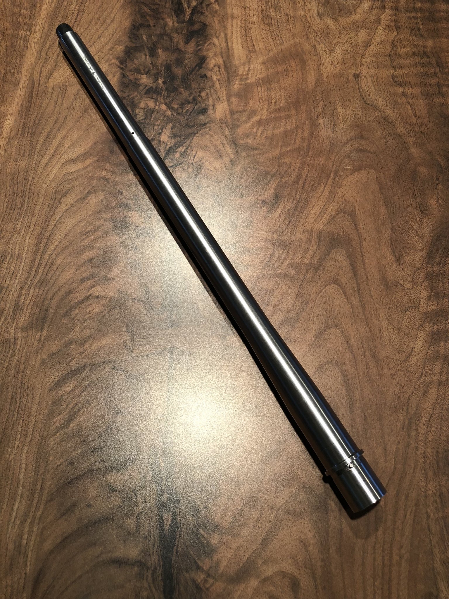

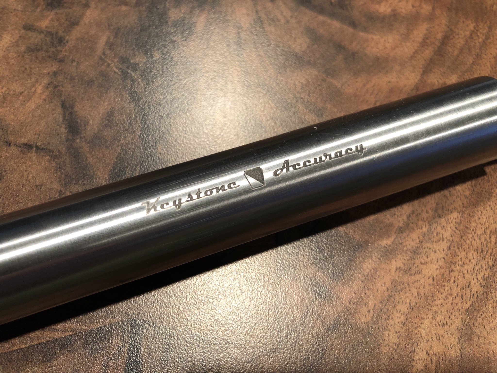

    Keystone Accuracy!!!

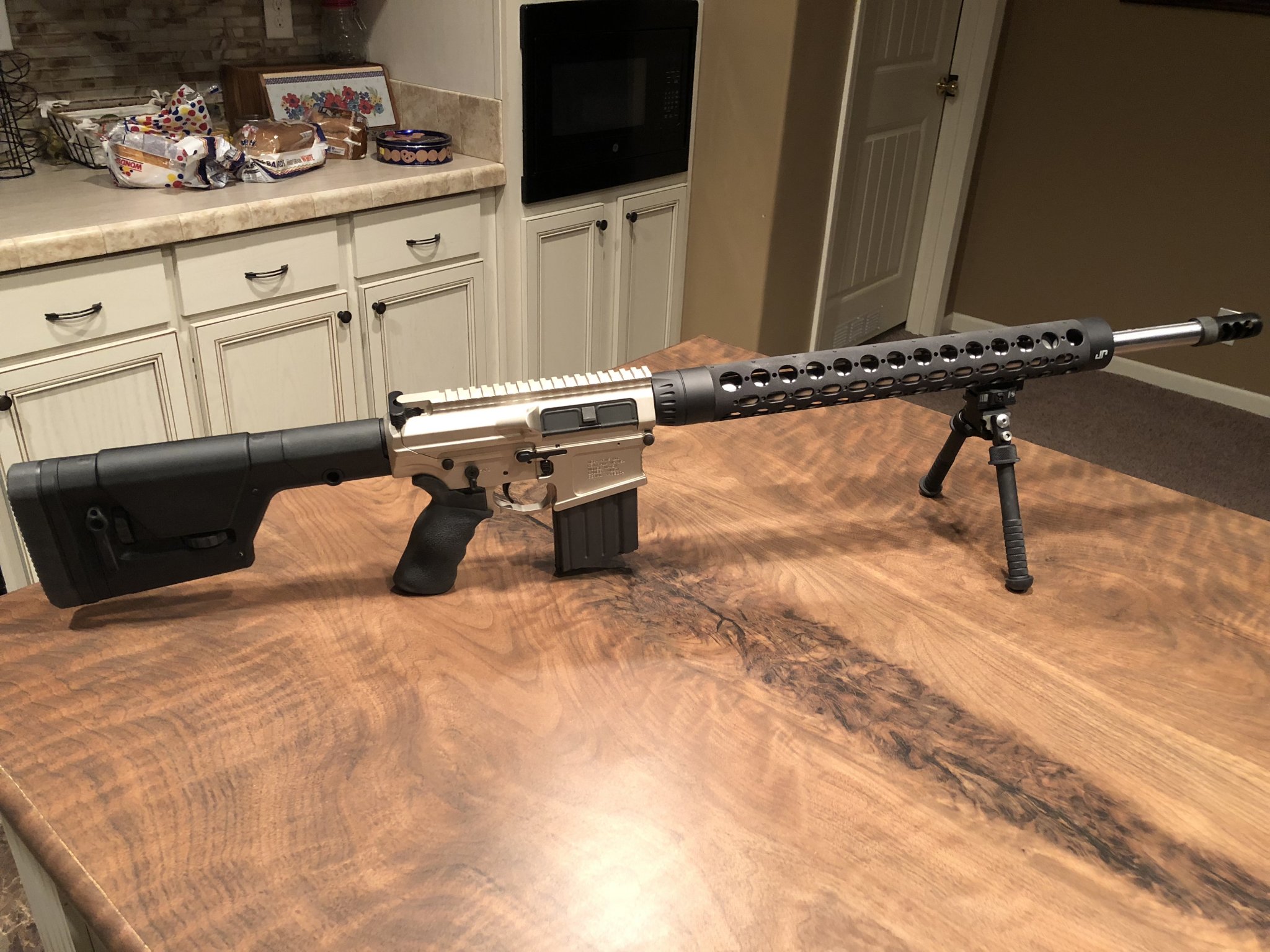

    I have a couple hundred 140 AMAXs loaded up with 41.5 H4350 that I was shooting in a Ballistic Advantage Aero build. I’m going to start with that and get it tuned and broken in.

    I was a little skeptical about the handguard until I tightened down the screws. That’s the stiffest handguard I’ve ever owned. Thank you for all your help!
