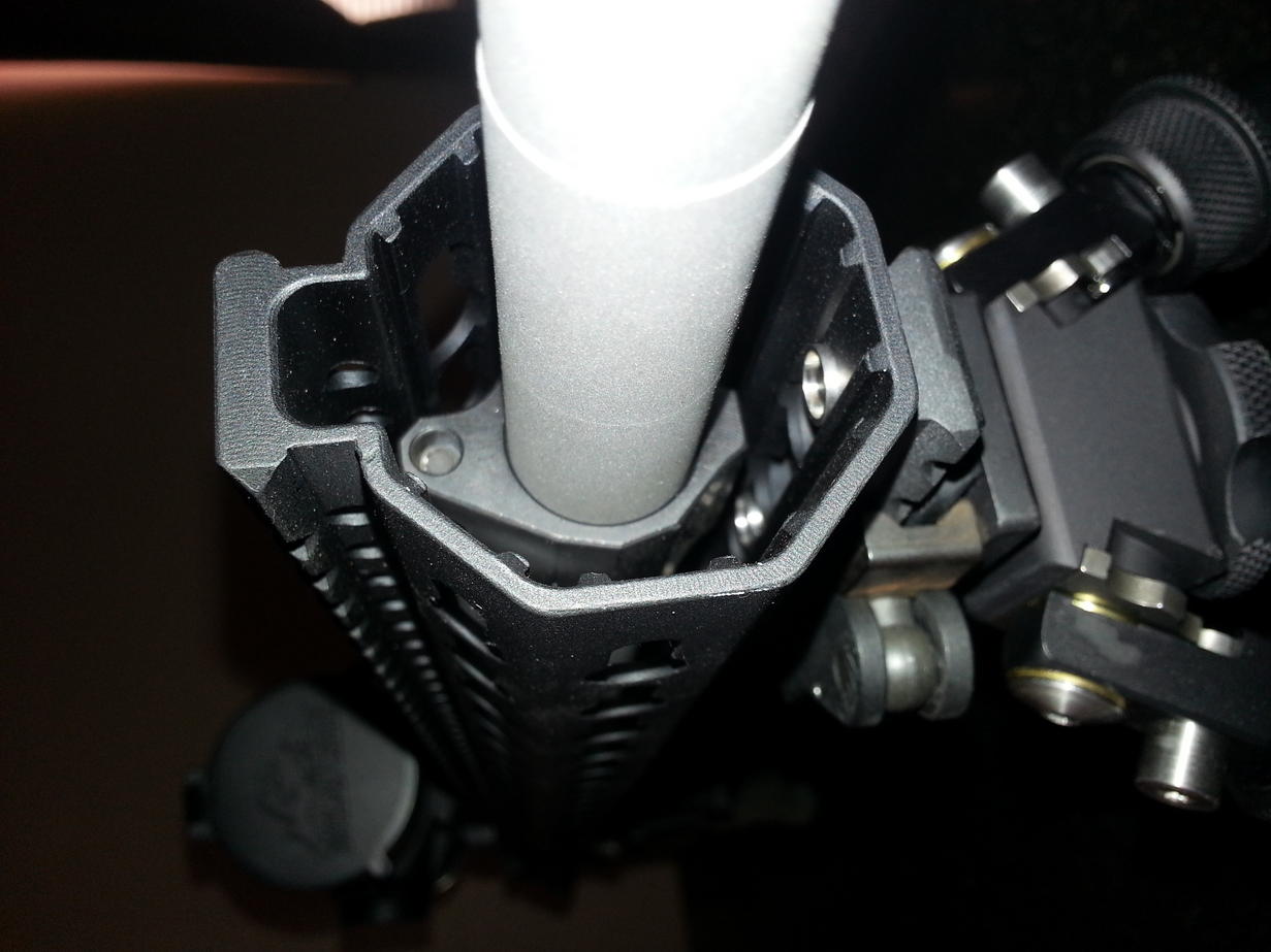

It would would be a REALLY tight fit, let me put up a picture of mine and I will show you where the issues would arise.
Within the rail are a series of ridges which on my rail measure 1.544 inches.If really wanted to make it work you could try and have someone remove the ridges and you would get an actual opening of approximately 1.65.
From Jason Curns, "It will accommodate any suppressor that is 1.50” in OD. If you are using a mount, it may be tricky."
It looks like somebody was able to pull it off. The only other concern I have for this build is about the handguard heating up. I don't do mag dumps, but how many shots can I waste before my hand becomes uncomfortable?
Yeah, it will fit, but what they don't mention is that it will not fit with any key mod accessories in place. I took mine off and tried to shove a 1.5" can in there with a rail panel I have currently installed for my bipod, it is a no go. It is too tight. It really is too tight for a 1.5" can despite what others might tell you. For tucking a suppressor an internal rail diameter of 1.6 or larger is much better for a completely free floated system. Much like some of the poorly designed flash hiders and the annoying ring they can make, you can get the same thing from the harmonics of a can stuffed in too tight of a hole.
You can do it, just don't expect to mount anything on it though and I hope you are not planning on doing any long strings of fire.
