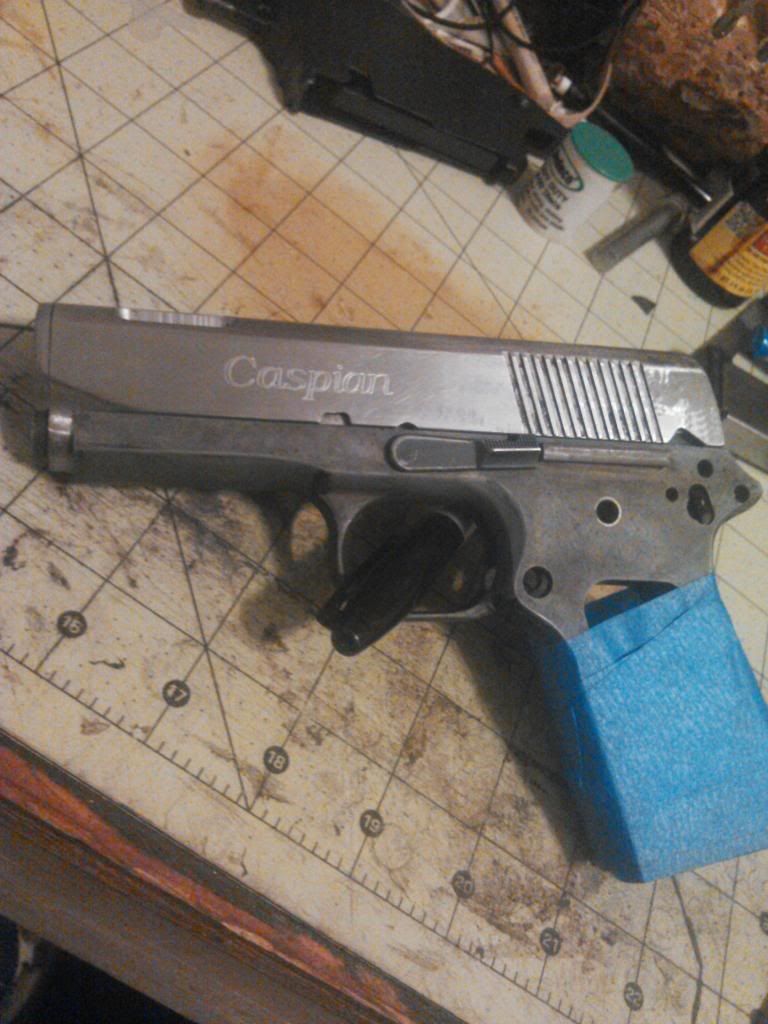

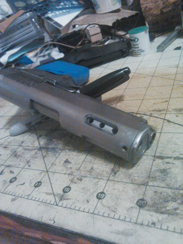

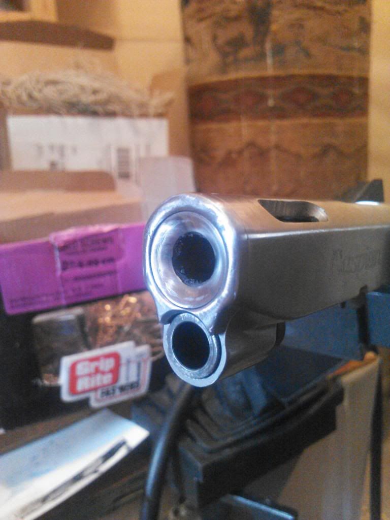

These are pics of it before I really started in on finishing the slide and bushing. 220grit in the pics. It is now in 600 grit and much smoother. The port is a series of three on each side of my own design. I got to shoot a compact ported this way previously. It was very nice. I reproduced it on my barrel and slide. Working the steel down takes time but the effort is worth it. The results are starting to show now.
