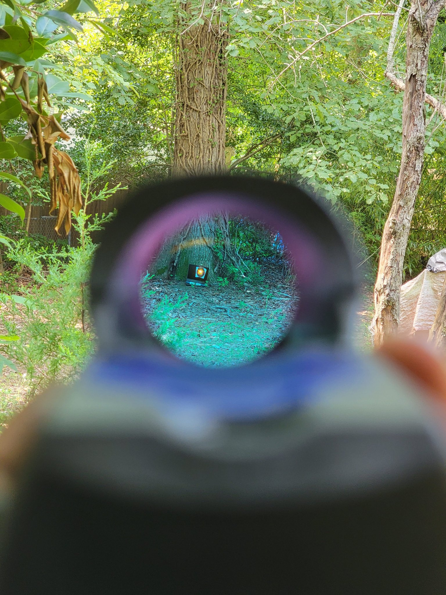

    • Bluest red dot I've tried. Makes my PK-01V look like an Aimpoint.
    • Momentary On only for active aiming, manual suggests the PRO fixes this with constant on functionality\
    Here's a pic of how blue it is.
