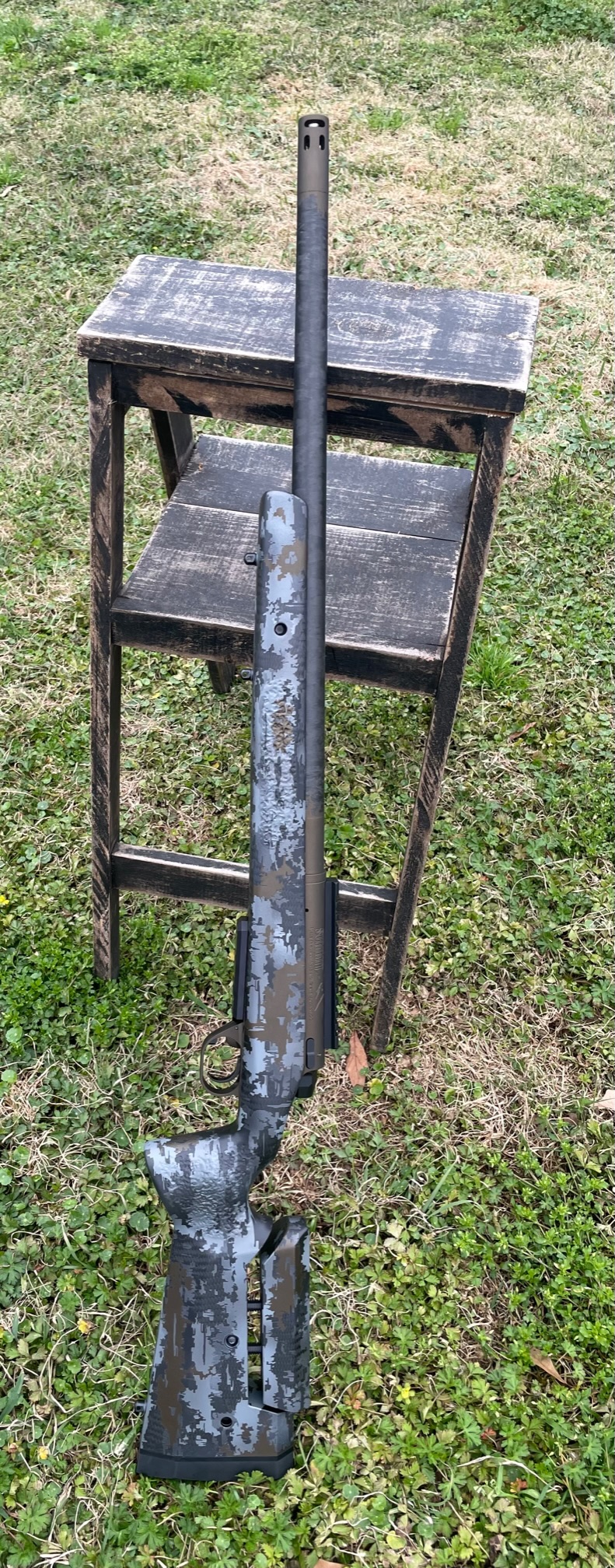

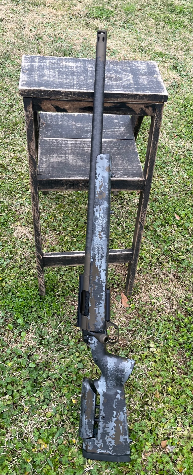

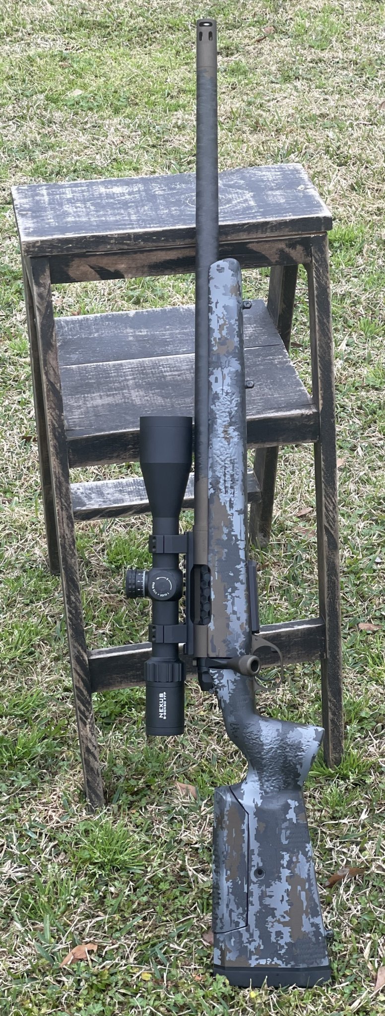

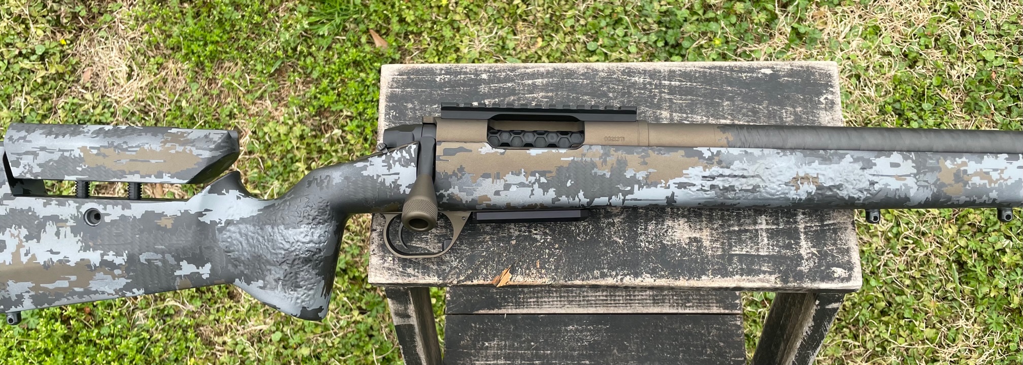

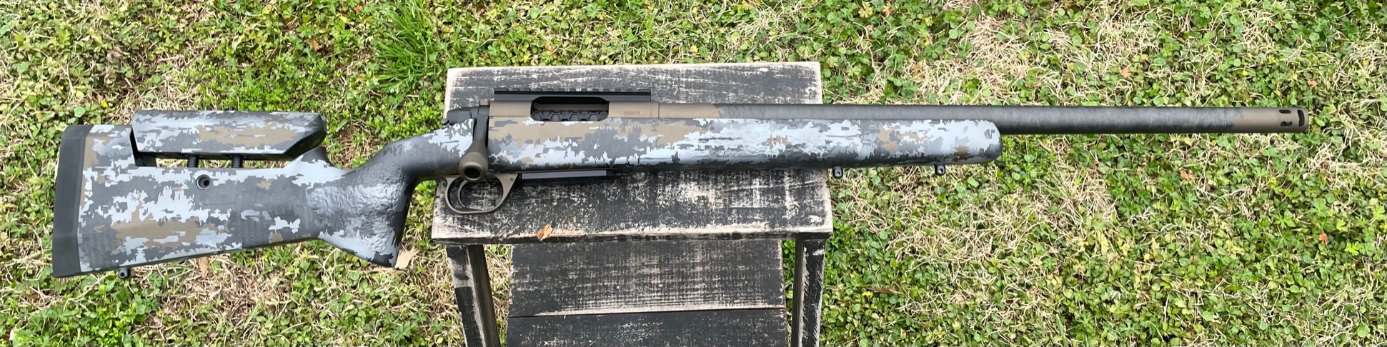

Not seeing much about the Mesa Summit Ti. I looked at several TI actions and settled on the Mesa. Almost went with the Terminus Apollo Lite but wanted an integral recoil lug and not a fan of split scope base. Stock went out to Joe Ducos for cheek riser. I ended up pillar bedding and Cerakoted everything. Microslick inside, midnight bronze outside. LRI DMP stencil kit. Ended up 8 lbs with out optics and rings. About 1 lb over my target.
Curious to see other TI or Mesa Summit Ti builds with weight if you know.
Build:
Mesa Summit TI - SA
Manners EH1 stock
Bartlein M24 Carbon Fiber
- SPR Bugholes chambered 6.5 CM
- 6mm left, gain twist on order for 6 CM barrel
Trigger Tech Diamond
Hawkins Hunter DBM
LRI DMP Stencil kit
Pillars and bedding in house
All Cerakote in house
Optic - Element Optics Nexus 5-20 (gonna check it out).
  • Love
Reactions: moosemeat
Very nice rifle, how much does it weight?
Do barrel manufactures make pre-fits for this action?
I don’t think there are prefits for the Mesa. Southern Precision Rifles cut my barrels so I can order a barrel without sending in my action. Pretty much same as prefit but not “on shelf” inventory.
Rifle weighs 8 lbs without optic. Weighs 9.25 lbs with scope.
