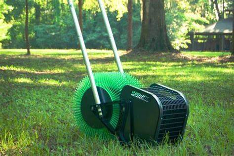

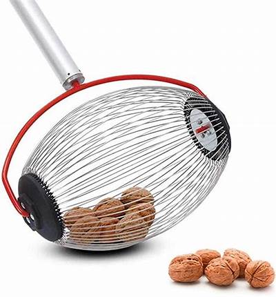

I got brass catchers for my pistol and ar’s , they work pretty good. Bolt guns I just pick up
They actually have a arm mounted one, not sure how good it works

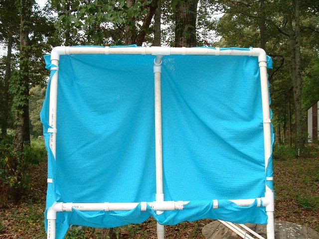

do you shoot from the exact same spot every time? are you shooting off a bench? standing? You could get creative with PVC and some netting or shade cloth.
not mine but something like this.

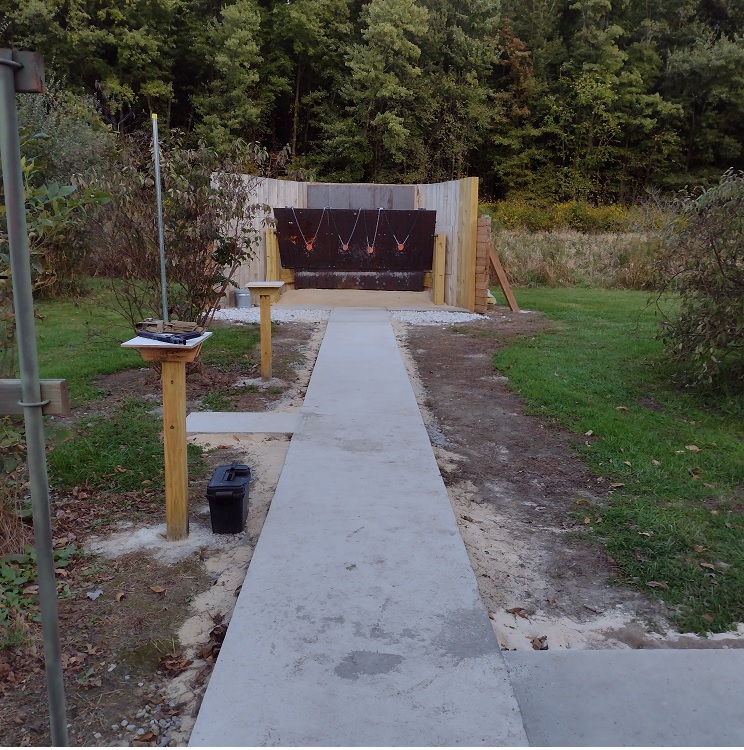

So here's what I need to work out. That grass to the right has been mushy all spring because of the rains.
This concrete path runs back 55', I poured it so I could shoot year round (and not stand in mud).
Most shooting done 25' - 45' out. I was thinking about 1/4" galvanized hardware screen angled towards the path.
This whole thing is a work in progress.
If it were me, I'd rig up a portable frame like shown in post #5. Store it in or behind the target area. Harbor freight sells camo tarps for peanuts.

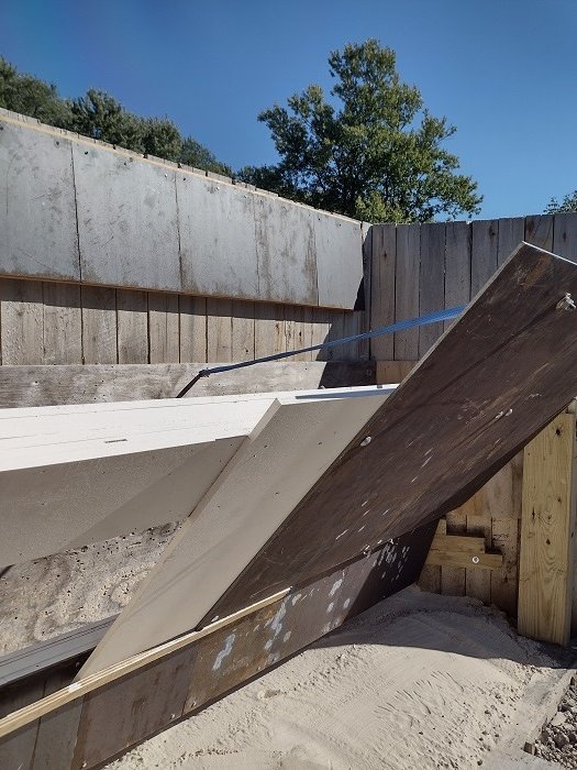

I had it cut into 3 pcs, each 40"w x 60"tall. Plate was about $1,500 + $200 for fabrication. They drilled 5 - 3/4" holes per plate. 15# per sq ft, so about 250# per plate. Plate above and below is 1/4" AR500, rounds fragment off main plate, to lower plate and into the sand. I made a long box and bolted it to that. Through the box is some heavy pipe that supports it and allows it to tilt. Drilling through the 1/4" plate, even with the correct bits and drill press and cutting oil is no fun, hence had them cut and lasered out the holes in the big plate.
Rounds go into the sand, almost nothing ever comes back. That said, I have a few stations and a bench behind some 3/8" acrylic for "spectators" to stand behind. I ran a F/A Thompson SMG on it Sunday, neighbors have to be like WTF? Usually I run suppressed as we do have neighbors.

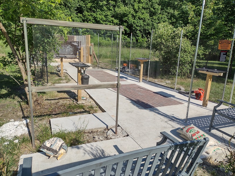

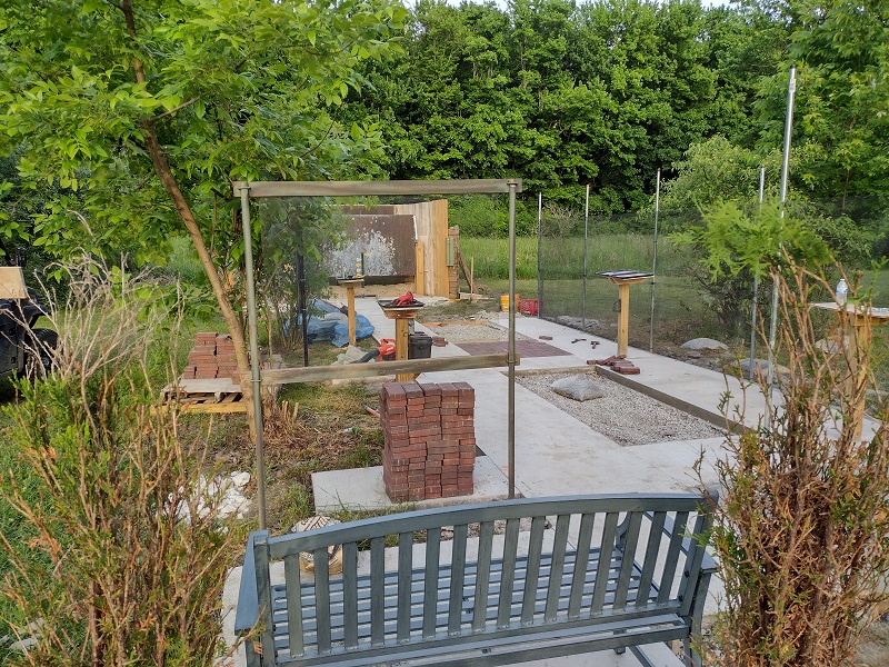

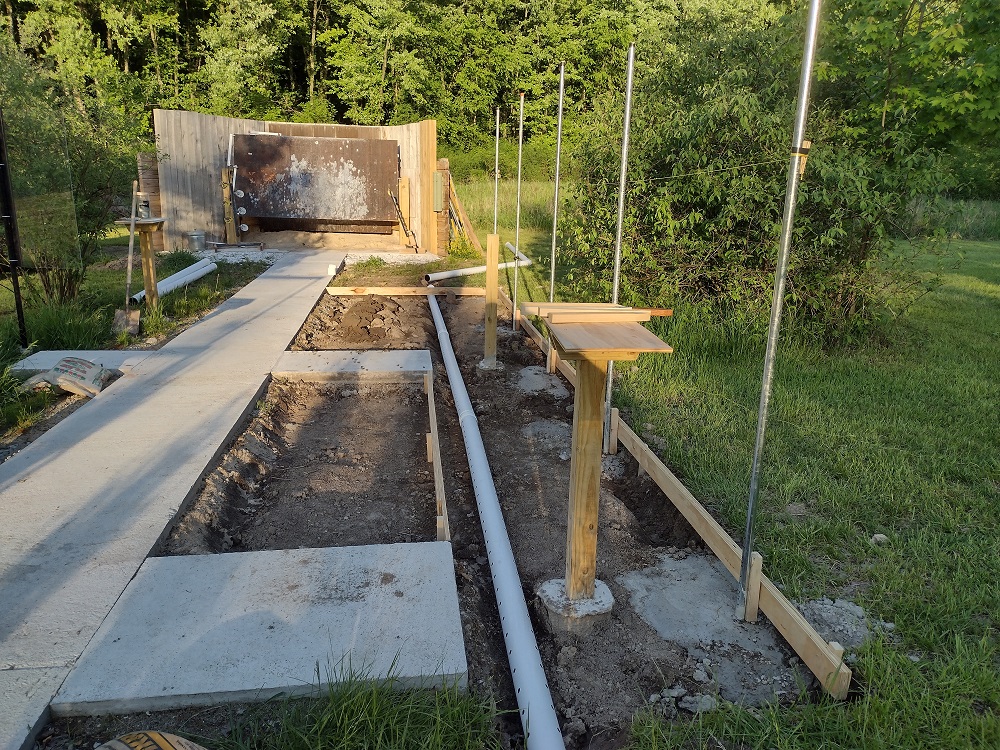

Well, I went down the rabbit hole on this one. This is not easy work for a 60 y.o. fat man, but I need the exercise.
I have a dump bed Kawasaki Mule, so shoveling dirt and moving it isn't so bad.
Pipe is to drain water from under the new concrete pad. Got some 1/4" black metal screen to provide 6' x 25' of fence.
Got 4 pallets of concrete and gravel coming Friday. Going to pour in 3 sections, I have two mixers, so that part is easy.
It's all the prep (2 eves + weekend) that was labor intensive.
224 more bags of gravel and quikrete.

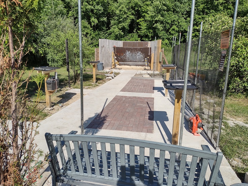

Mesh netting and a leaf blower.
Kids don't like helping out in the hot sun.
Pavers were 22 cents at Menards, why not.
Well this things about done, got some concrete cleanup and another acrylic panel for non shooters to relax behind. The deer ate the new arborvitaes, so while they're coming back, it's a losing proposition. The angled plates do a nice job of depositing fragments into the sand.
