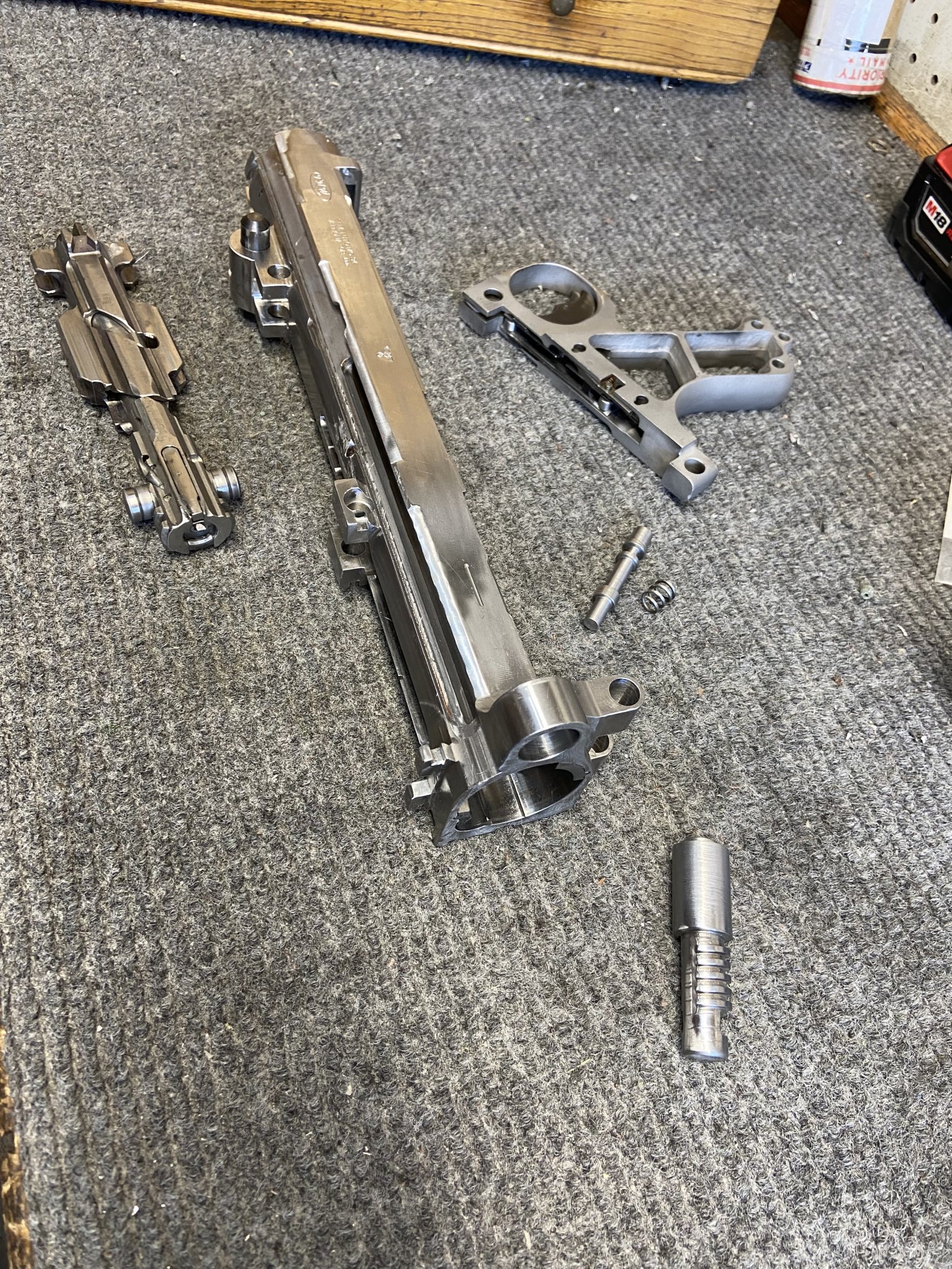

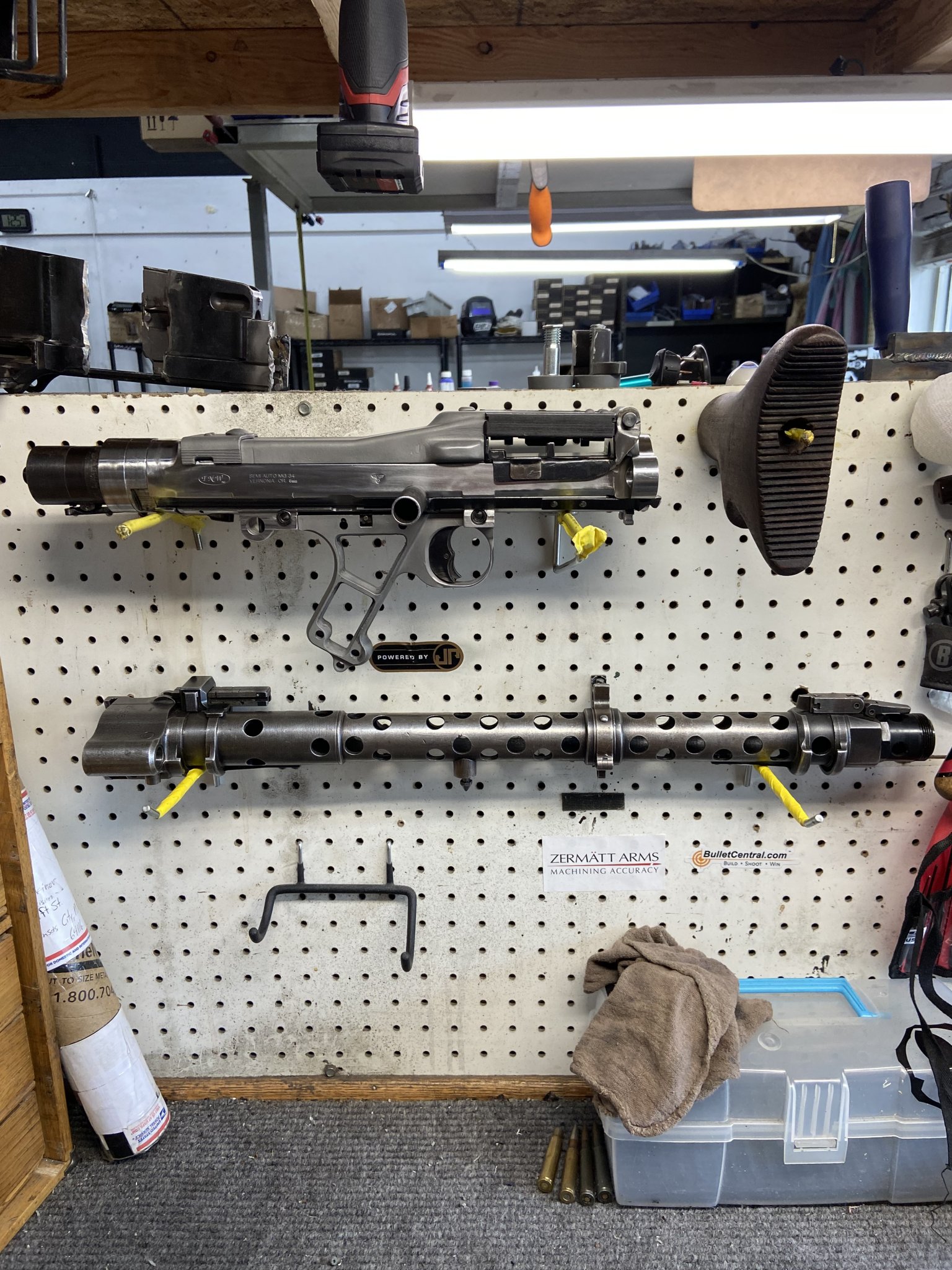

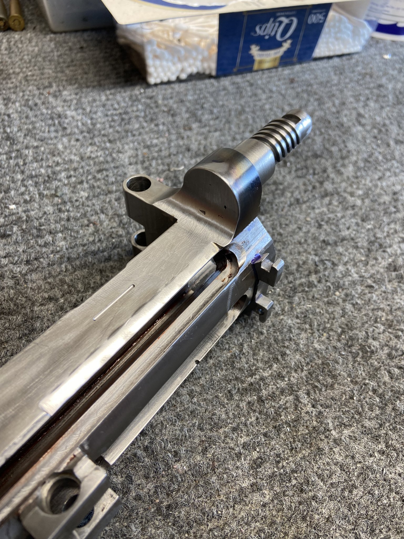

This one’s not so much a “build” as some of the others because I went ahead and ordered a complete semi auto reciever from TNW. Well after almost a year it finally came in, and after about 2 hours of deburring (ordered it in the white) I took stock of what needed to happen for this project. My parts kit was missing a few small parts like the mainspring and couple pins, so I ordered those and got em. It was missing the bipod so I still need to source that.

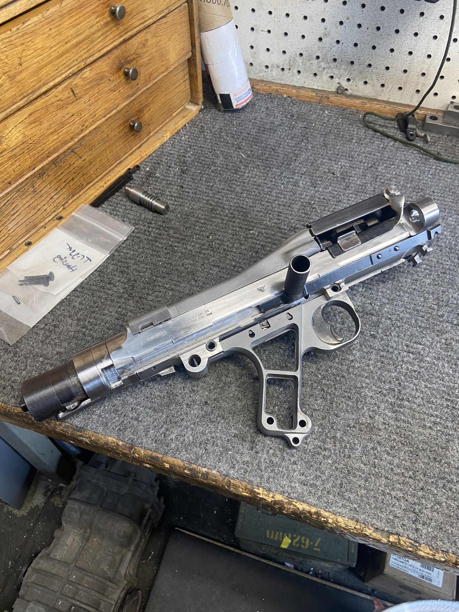

The reciever needed the spigot up front that the barrel shroud hooks to, typically builders cut originals off the receiver chunk from an original gun then clean it up and weld it in, I fabricated the post from scratch (obtained some original prints offline). A couple minor milling operations on the original bolt modifies it for semi auto only. Also fabbed a new top cover retainer pin. Also A minor mill job and conversion to rollers on the trigger/grip assembly to convert it to semi.
Had to rivet in cam locks into the reciever, which wasn’t bad.
All I need now is to weld in the reciever spigot and I should be ready to test fire

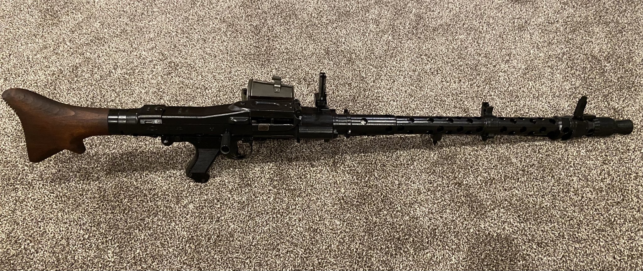

Nice project! I'll see if I can dig up a pic of an original MG34 I had. That's one gun I regret selling!!!!!! Mine was a reg. C&R made in 1942.
I also had the tripod, optics, (still have the original spare barrel carrier and an Israeli 7.62 barrel), had the crank handle belt loader etc...pretty close to the whole kit you could ask for.
I made a couple of brand new barrels for it. Just in case you might need to get a new one! LOL!
Gun ran like a watch!

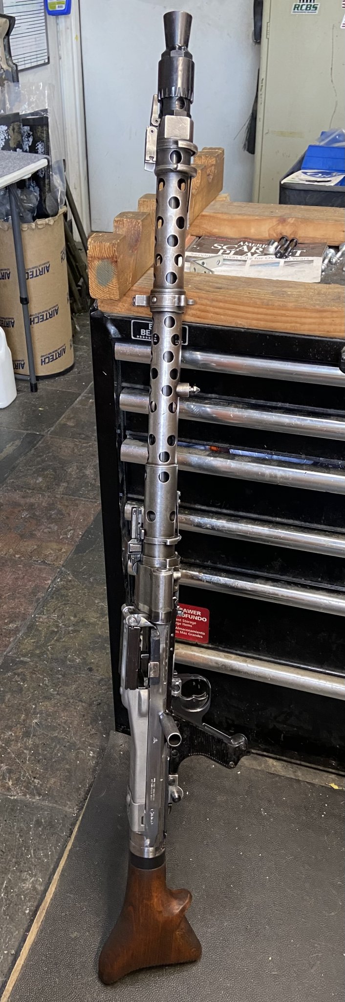

Test fired it, fired but didn’t want to eject for shit, turns out the ejector is worn out or just didn’t mate well with the replacement ejector plate. So I ordered a replacement from brp and it comes long meant to be filed to “time” it to the ejector plate, did that now it kicks brass out

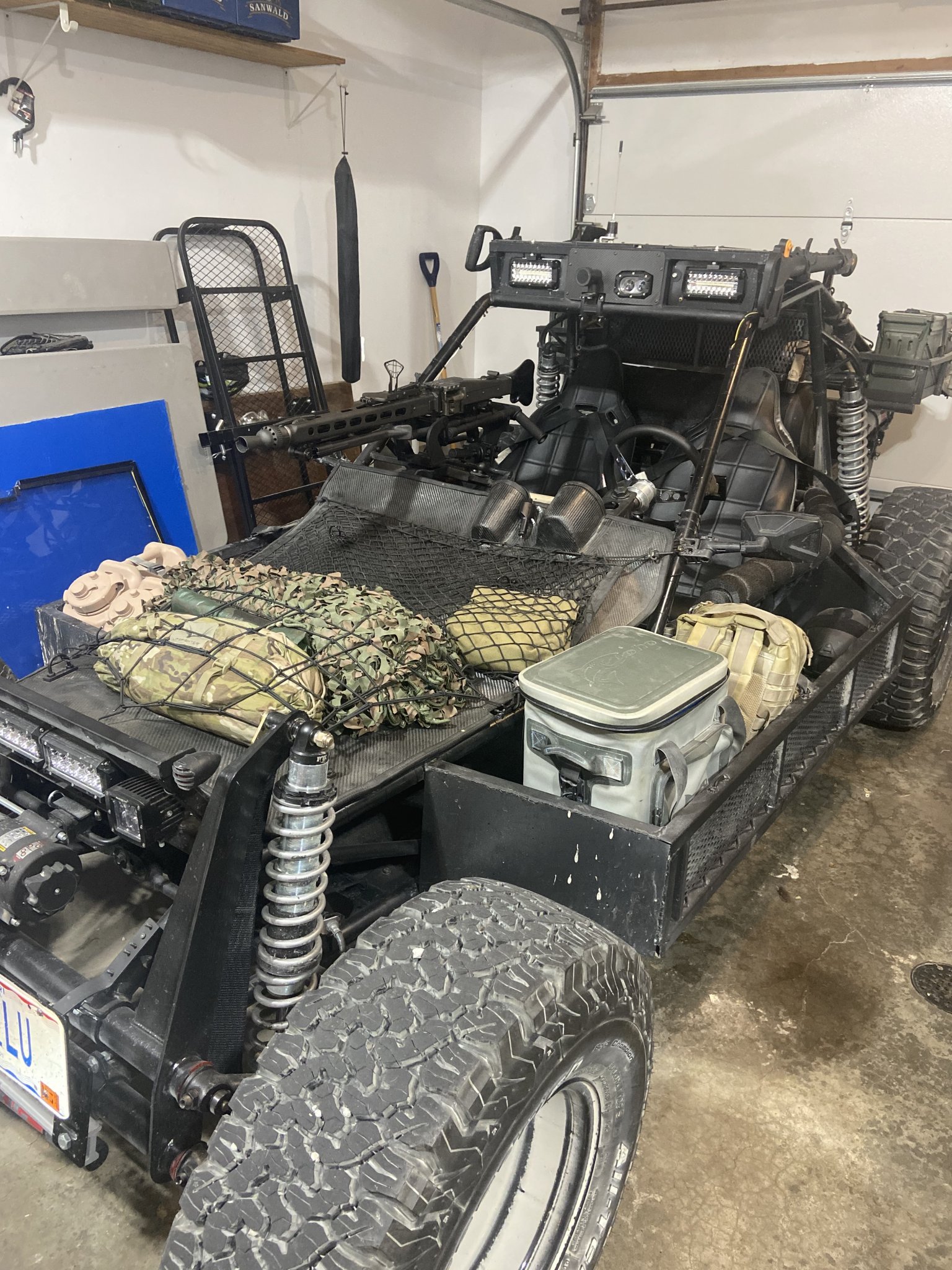

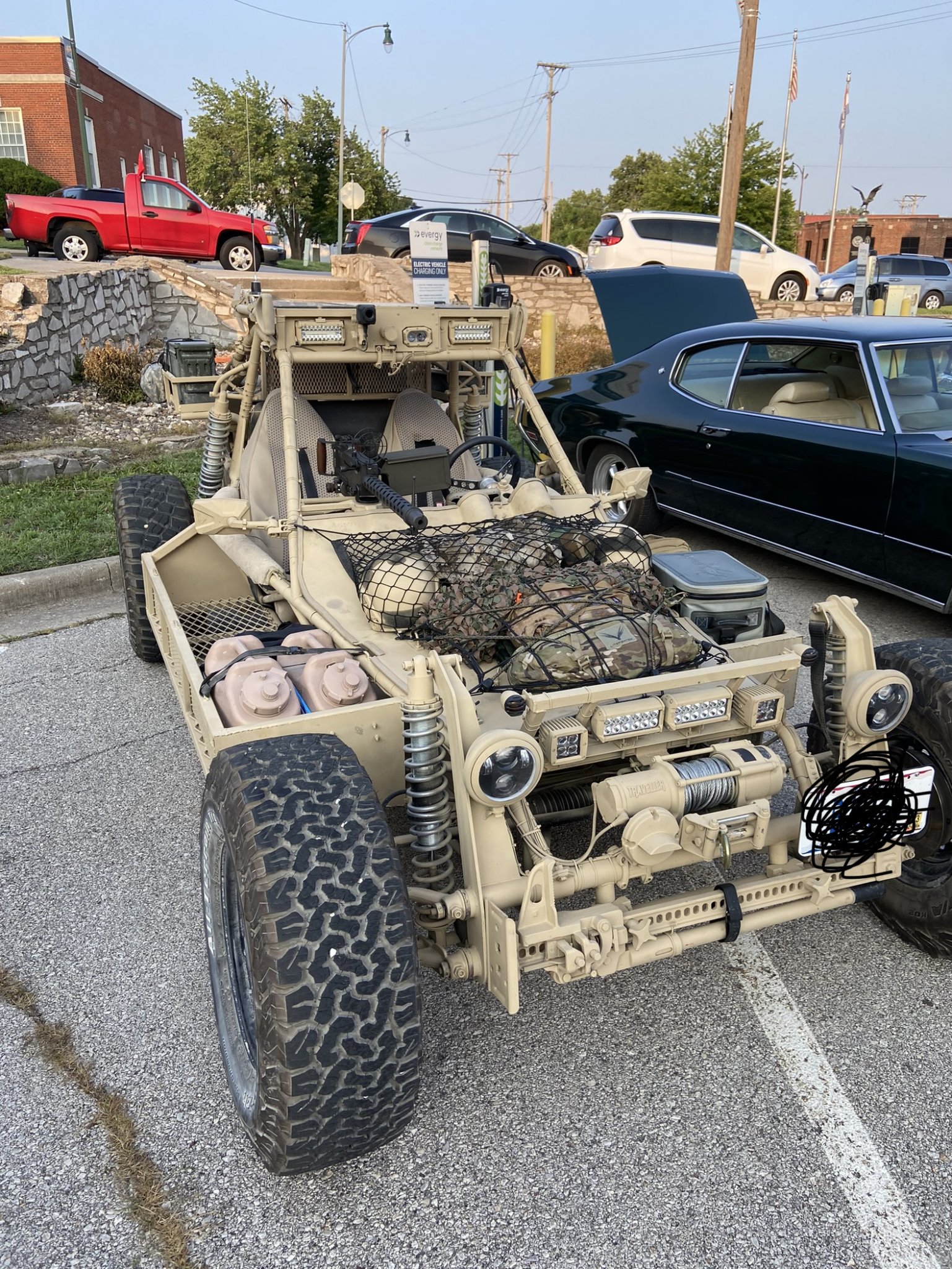

Looks cool. Is that a chenowth?
No, not sure the brand of frame but put a lot of work into making something similar to a FAV, more so a DPV was the inspiration, not a clone just wanted an “ish”. Debated caging in the gunner top seat but decided against it as my frame is a little shorter and narrower than a chenowth dpv frame so it might get a little squirrelly if I had done it
And it's electric...per the charging station pole behind it :)
