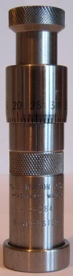

Wilson micrometer seating die

I've gone as far as 47.6gr in a lapua case seating a 155 scenar to 2.2OAL (measured with a comparator). I had to turn the micrometer head .018 past seating the scenar in an empty case in order to get the same COAL (pretty freaking compressed). My redding die has the VLD stem in it and I'd say the "ring" on the bullet from the seating die is very minimal. It's very apparent, but I'm not sure there's any noticeable/measureable deformation occuring. Now... try that same thing with my wilson micrometer die and the ring that forms is blatantly obvious and you can feel it very easily. I haven't tried it with a forster die, but I have one sitting around I could probably try it on. PM me if you need me to do it and respond here with results and I'll see what I can do.

I use Wilson inline seaters with Sinclair micrometer tops in 308 and 260, they have replaced Reddings comp seaters. Both the Redding and Forster work exactly the same, the Forster cost less, but the numbers are hard to read compared to Reddings

I too like the Wilson seater, I like the feel, I can tell if one is hard to seat. That round becomes a fouler...
