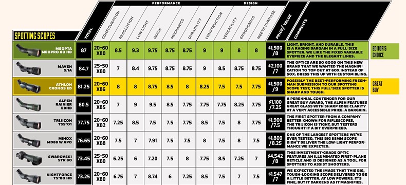

Not totally relevant to this Minox MD80xr but interesting none the less. Found it on Meoptas website
