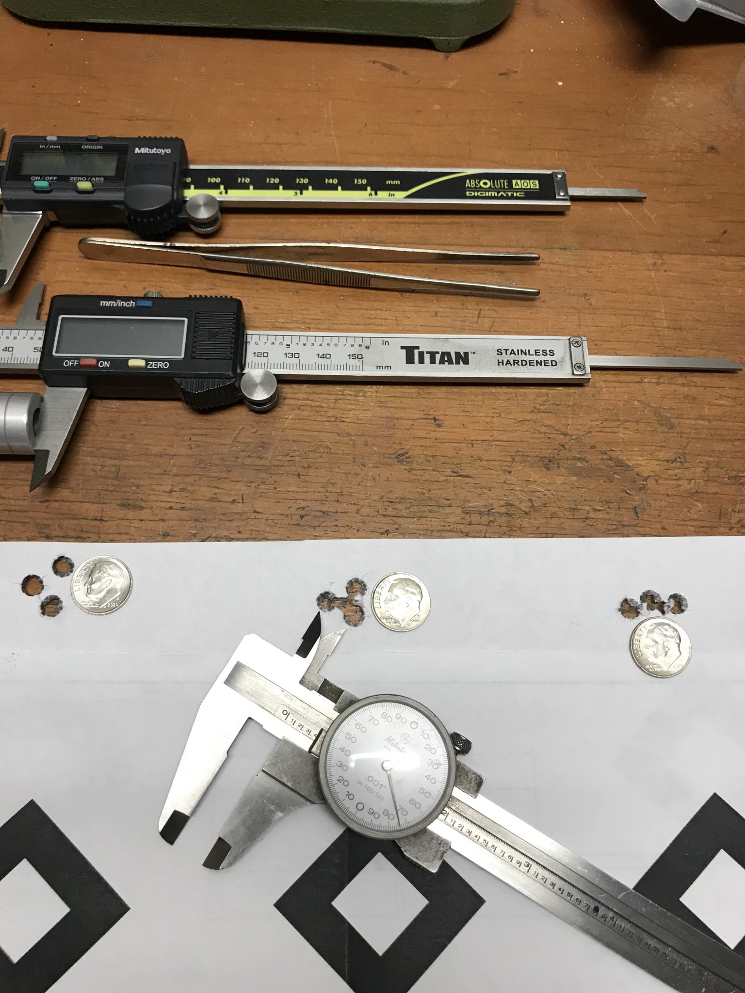

I’m curious why they would be hard to tune? I loaded 44.1 gr StaBall and did a seating depth test and went w 80 thousandths off the lands and I’m getting consistent 0.5” groups
