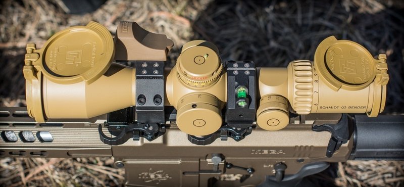

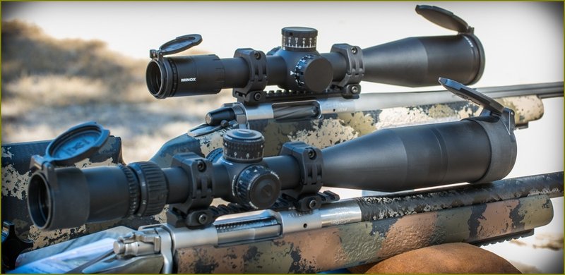

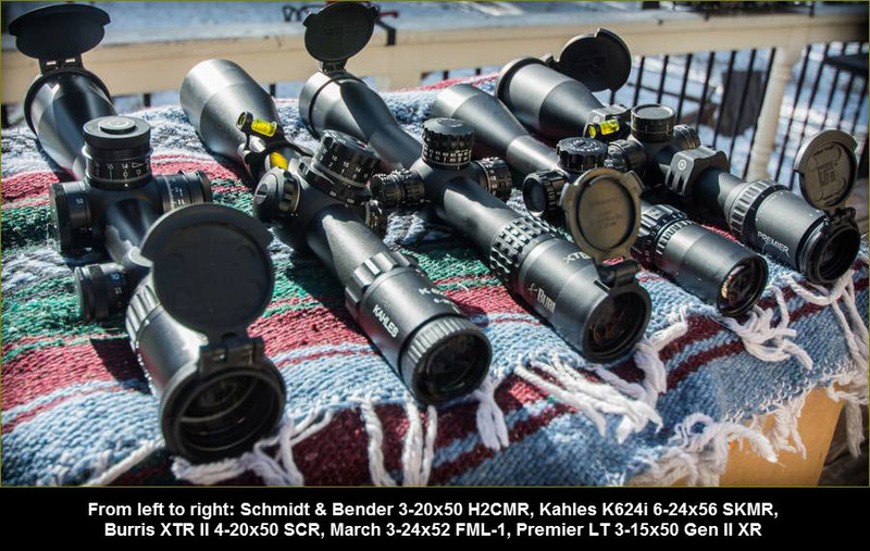

    Here are the pics of the scopes –
    And here was the scope lineup from 2016 -

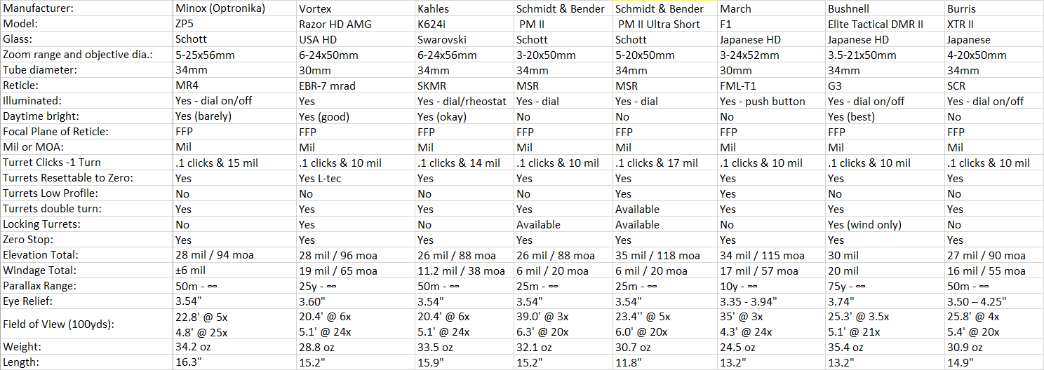

    Specs:
    When looking at specs please realize there is nothing in manufacturers’ specs that will tell you how “good” the glass is for a particular scope. Generally with optics you get what you pay for in regard to glass quality (but sometimes you will pay more for lesser quality glass depending on the manufacturer). So when you look at a Vortex PST 6-24x50 and the Vortex AMG 6-24x50 and wonder, why on earth is the AMG 3x as much or more when it has the same specs, please realize that not all specs are equal, go in to your local sporting goods store and ask them to show you all the 8x42 binoculars they have and you will see everything from $200 to $2000 and yet they are all “8x42” binoculars, this should tell you something, that not all things are equal. The glass, the parts used, the process and a whole bunch more go into the manufacture of any given item which affects cost. Generally speaking the higher the quality the more costly it is to make the unit, so with the Vortex example it could be any number of things but with the higher price usually means better glass, better parts and materials and better assembly techniques, etc.

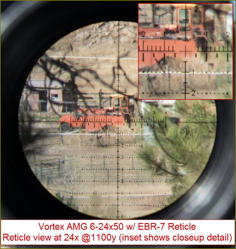

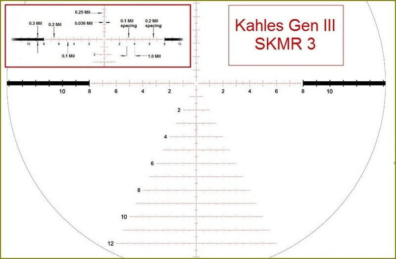

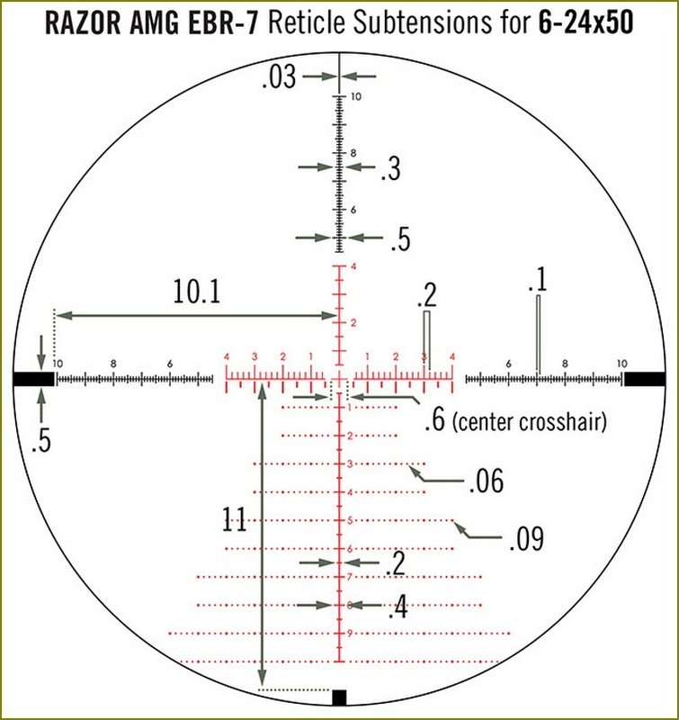

    Reticles:

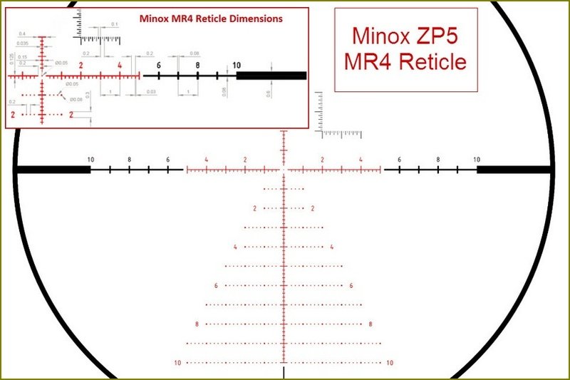

    The below are the manufacturer’s specs and I wanted to show how close the MR4 reticle is to the new SKMR 3 reticle with the floating center dot and .2 mil hash marks. The EBR-7 reticle is different but just as usable.

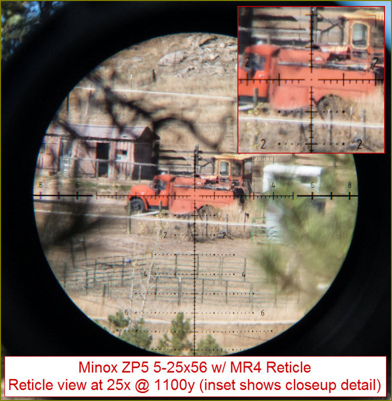

    Disclaimer: The following images are for giving you an idea of how the reticles look through the scope, please do NOT use these images to evaluate IQ because the image through the scope to the naked eye is far superior than what my camera and lens can pick up. Imperfections in my ability to perfectly align my camera lens with the scope lenses will cause image degradation in some shots.

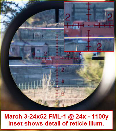

    Here are the reticles at each scopes max magnification:
    Minox ZP5 MR4 @ 25x
    S&B PMII US P4FL @ 20x (oops, forgot to get a shot aimed at my favorite old truck)

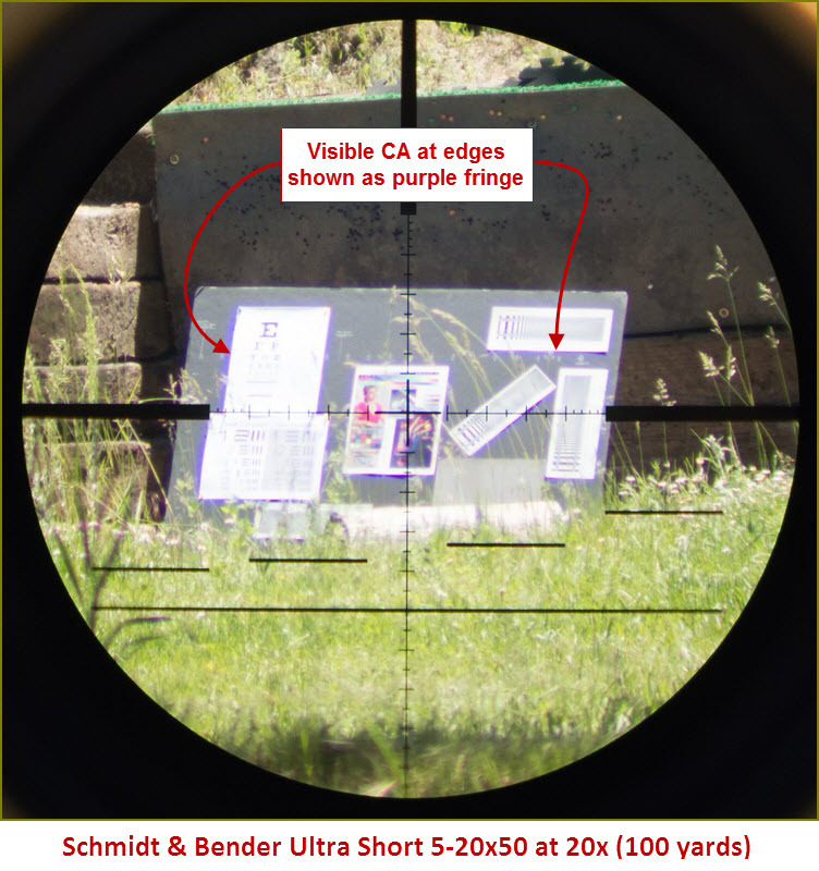

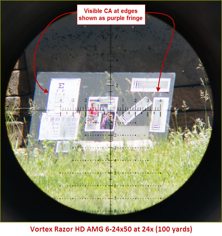

    Chromatic Aberration (CA)
    While the CA shown in an image is more pronounced than through the scope appears (because your camera's lens also exhibits CA), the below images do show how much better the Minox and AMG handles CA over the Schmidt & Bender. Out of many scopes I've used over the years, the Minox ZP5, Vortex AMG, Premier Heritage (Tangent Theta) and March scopes handle CA better than others, but again, I want to reiterate that CA has nothing to do with being able to hit a target, though it can affect the quality of the image you see through the scope, ultimately it is up to you to decide whether CA will be a deciding factor in your choice of a scope, keeping in mind that many shooters rarely ever notice CA even with some of the worst CA performing scopes (like the Steiner T5Xi series).
    Disclaimer: The following images are for giving you an idea of how chromatic aberration looks when looking through the scope at high contrast situations (trees and branches against bright sky, snow with trees or shade, white targets on dark backgrounds, etc.), remember these images show both the riflescopes CA as well as the camera lenses CA so these images show more CA than what you'd see with the naked eye through the scope. Also, CA has nothing to do with how well the scope performs, it is an optical characteristic that has no affect on being able to accurately hit a target. Finally, please do NOT use these images to evaluate IQ because the image through the scope to the naked eye is far superior than what my camera and lens can pick up.
    Minox ZP5 5-25x56 (barely any noticeable CA)
    March F 3-24x52 (slight purple and green fringe at edges of white target) BPuBE8r.jpg
    Kahles Gen III K624i 6-24x56 (thick magenta fringe at the top of the target and cyan fringe at the bottom, this is representative of the bad CA this scope exhibits) ChHRSU7.jpg

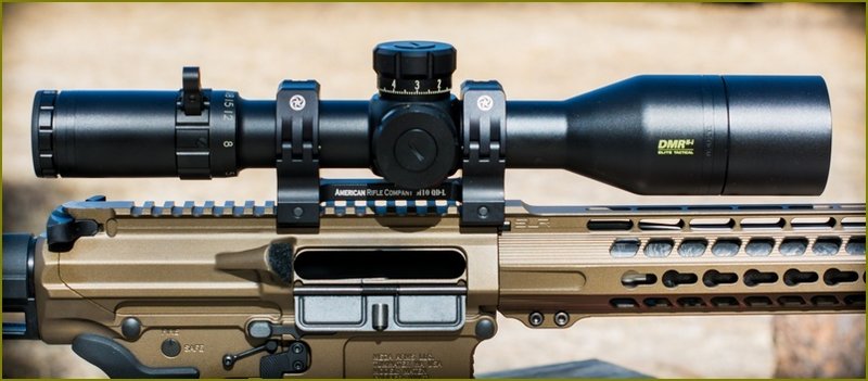

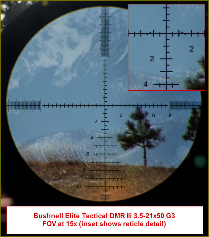

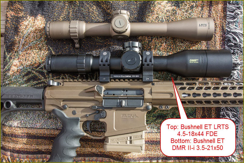

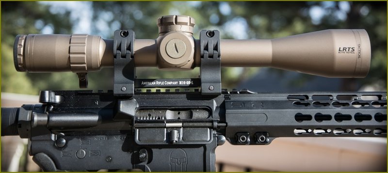

    Bushnell Elite Tactical DMR IIi 3.5-21X50 Illum. G3 Scope ET36215GI
    I just finished my preliminary review of this scope and was not able to include it with the original evaluation; however, it does fit the criteria (barely though - more on that later) for being a high magnification (20x or better), being under 35oz (only in spec) and having good glass. A number of years ago I purchased the original Bushnell ET DMR and was highly impressed in a number of areas, but as my desire for better glass increased I found the DMR glass to be somewhat wanting in certain areas; one of those areas was in regard to the multi-coating they were using which had a blue cast to it and was very apparent during low light situations, causing the scope to "suffer" in clarity during low light. I do not know if Bushnell decided to upgrade the glass in the DMR II but I can say this, they definitely improved the multi-coating and the DMR II performed beautifully in my low light tests showing very good contrast and clarity. Another area of frustration was that, at the time, it seemed like every scope mfr except for Bushnell had an illumination option which really helps in low light situations, well with the DMR II Bushnell finally offers illumination and their illumination is the best daylight bright illumination I have seen in a long range scope, brighter than any other scope I have tested but also has excellent low settings with no perceptible bleed or ghosting in low light. The one area that Bushnell has shown to be consistently inaccurate on with its specs is the weight, Bushnell lists this scope at 34oz but on my scale it comes in at a hefty 35.4oz (the old DMR was listed at 32.5oz but came in at 34oz), now my scale could be off; however, it has been within .1 - .2oz for all other scopes I have weighed so something tells me Bushnell needs to update their weight or fix their faulty scales, this is really unacceptable in modern manufacturing. The addition of the built in quick throw lever is really nice and ought to be something all manufacturers consider as an option (Schmidt & Bender now has a new "shark fin" design) instead of having to buy a clunky wrap around throw lever, the lever is removable which is another nice feature for those who may not want/need it. While its been quite a while since I had my original DMR, the turrets appear to be lower profile which is nice, but I'd still prefer them to be a bit shorter. Clicks were concise if a bit mushy but easy to get where I wanted to go, one very refreshing update is the amount of travel, the original DMR was a pathetic 5 mil of travel per turn but with the DMR II it is up to the standard 10 mil per turn. Bushnell also came out with a new "G3" reticle which improves upon the original GAP design, but in my opinion not enough; Bushnell had an opportunity to draw from many of the new reticle designs offering .2 mil hash marks and while they did throw in a couple extra hashes between the 1 and 2 mil horizontal stadia points, it's just not quite as useful as other designs like the SKMR, SCR, EBR-7 and MR4 to name a few. However, given its price point and glass quality, I would say the new Bushnell DMR IIi offers the best bang for the buck, in fact, for glass quality alone, I would recommend this scope over others in the $1000 - $2000 (street price) class. And if you're looking for a "short" scope with at least 20x or more magnification, then unless you have the coin to buy a Schmidt & Bender Ultra Short, this is the scope for you. I think the new DMR IIi will be a huge hit for many shooters and will find its way onto a lot of AR and Covert/Short style rifles.
    Some shots of the scope:
    H00AFyN.jpg[/B]
    Reticles:

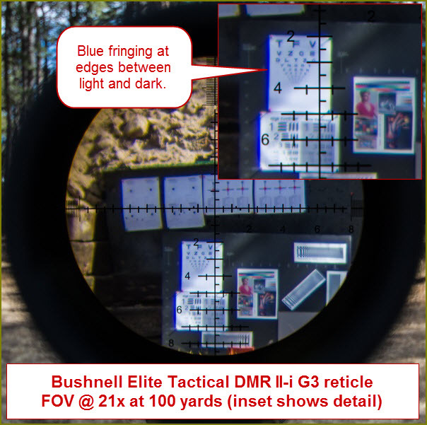

    DMR IIi G3 @ 3.5x
    DMR IIi G3 @ 15x
    DMR IIi G3 @ 21x
    DMR IIi G3 illuminated @ 21x (in the shadows)
    Reactions: CSTactical

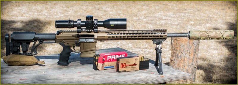

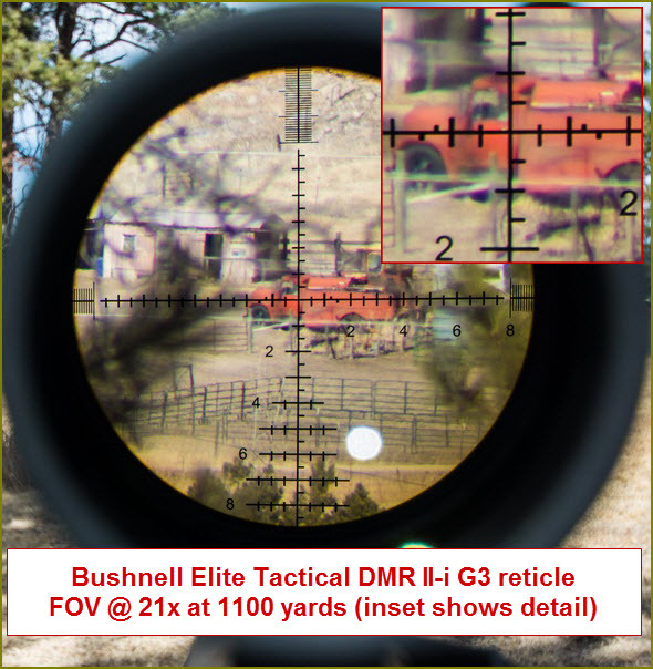

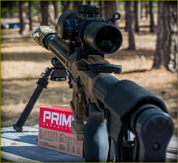

    Took the Bushnell DMR II and AMG out for a spin this afternoon and must say the DMR II is really impressive. Not as good in controlling CA as the AMG (but then no scope is except for March, Premier/TT and Minox ZP5) but not horrible, I'll try and post some pics soon. What really impressed me was the resolution, this scope (at least my copy) is really impressive for a $1500 optic. Eye box was not as good as the AMG (but again, the AMG is in another class) but not bad at all, it was still easy to get behind and has generous eye relief.
    Wanted to get some more time behind the DMR II-i, really a great scope for the price, my new favorite in this category. Also have an LRTS that I will be curious how it compares especially on my AR-6.5...
    Targets at 100 yards away
    Updated thread with some new DMR II through the scope images.
