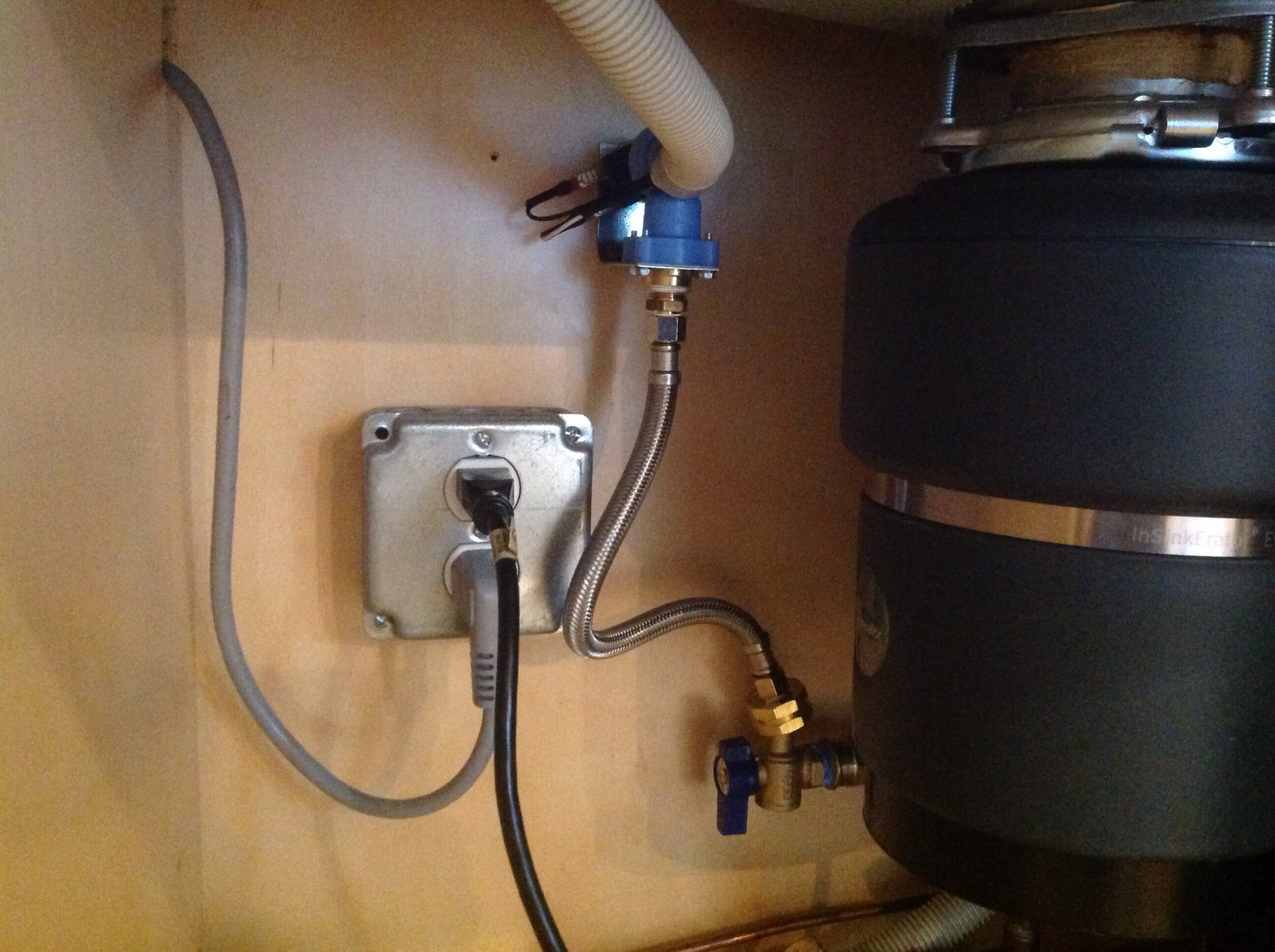

    Success...........
    I'll be using the money saved to buy more ammo.
    I'm getting a sweet deal on FGMM 30-06 right now at $185/case. PM me if any of you helpers want in on it.
    PS...........I know power is in a shitty place in relation to a live water valve with plumbing done by a non plumber.
    Surprised it wasn't GFCI in the initial install.

    Hi I had something similar. I bought a dishwasher about six months ago. For all the time that we have it, it broke down about twenty times. My wife insisted for a long time that we throw it away and buy a new one, but I didn't want to throw it away because I spent a lot of money on its repair. However, after a while we decided to get rid of this dishwasher. We first wanted to throw it away, but then we were told that we can exchange our old dishwasher for the best commercial dishwashers and of course pay a little. So ask if you can exchange your dishwasher, too.
