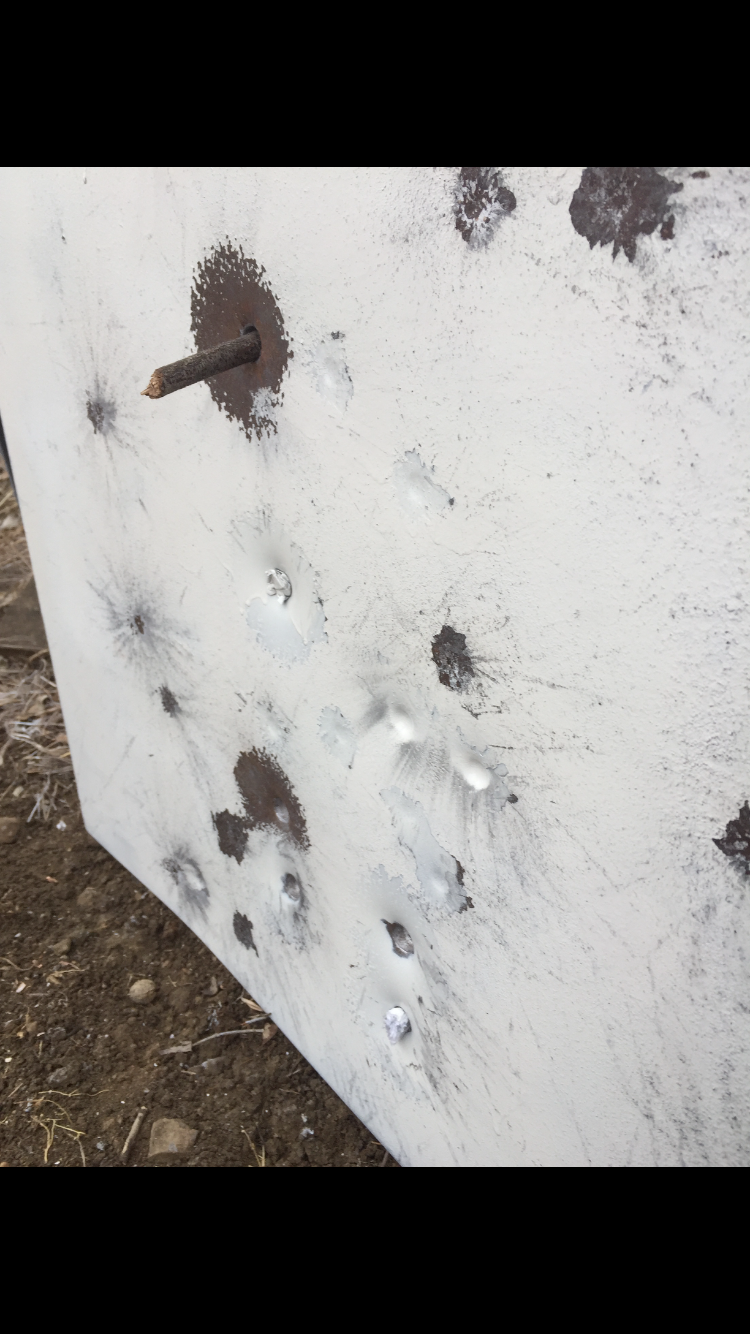

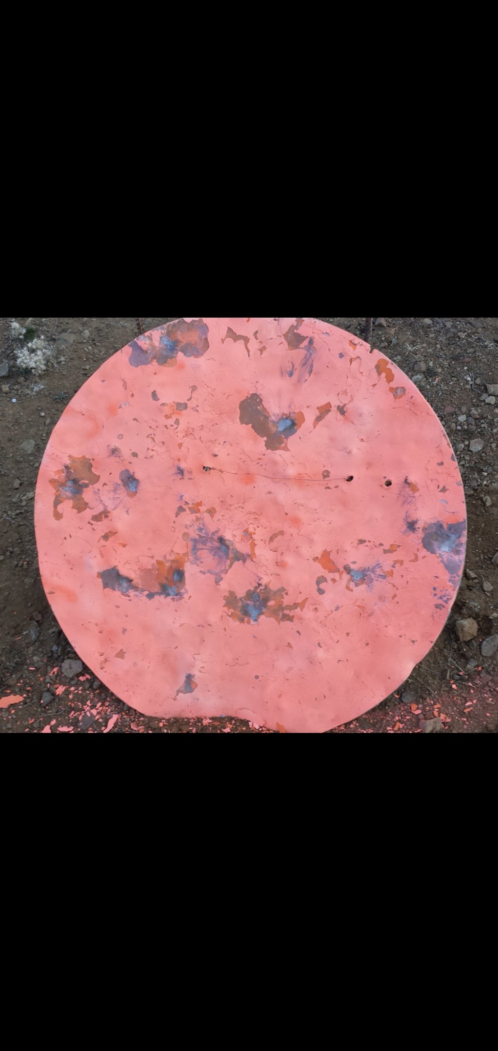

I attached my buddies 3/8" mild steel 1760yd target with 100s of hits on it for your reference.

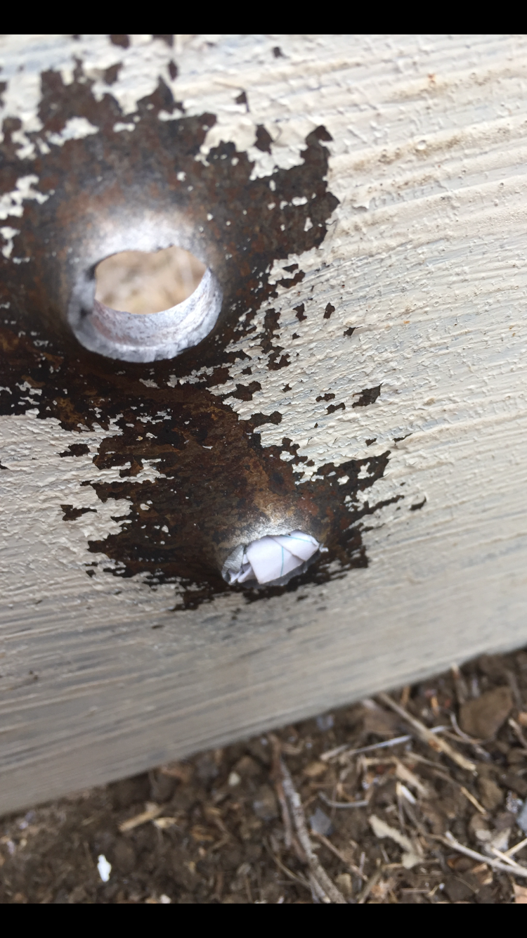

The 375 cheytac may be an issue as I THINK that's what caused the holes in my buddies 3/8 mild steel. I think one of the big issues is some of the rounds are solids that really pack a punch.
It sounds like everything else, at ~50 rounds a year, you can CONFIDENTLY use 3/8 mild steel (at a mile plus) and not need to replace it for many many years.

mild steel sure looks funny after a few dozen/hundred rounds when its shaped like a bowl
