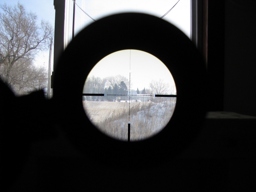

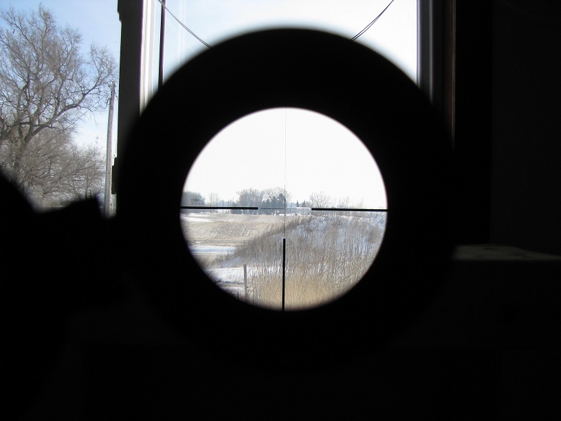

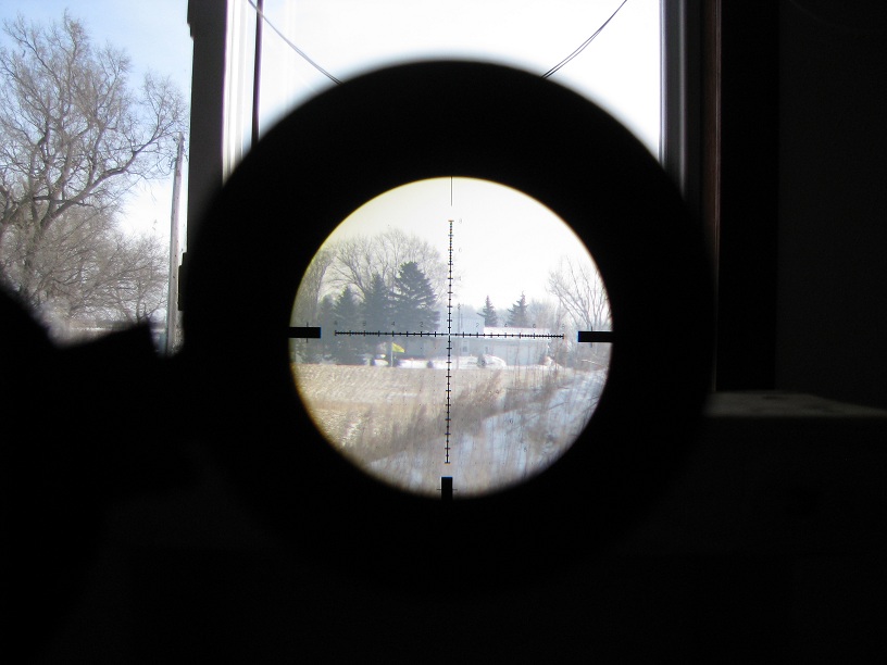

<div class="ubbcode-block"><div class="ubbcode-header">Originally Posted By: bourdlay</div><div class="ubbcode-body">Third: I haven't used a first focal plane scope,so I can't judge, but it seems the reticle would be to large at long distances with the higher magnifications for a percise shot placement? How do guys get those shots in their with so much crosshair in the view? It has to be covering a lot of the target? </div></div>
Its not as bad as you'd think. Here is a few pics that show a vortex razor at different power settings, looking at a house thats a mile out. Still precise enough to plainly put it on a target of your choosing.
http://www.gregd.net/pics/guns/optics/razor/IMG_3266.JPG
http://www.gregd.net/pics/guns/optics/razor/IMG_3267.JPG
http://www.gregd.net/pics/guns/optics/razor/IMG_3268.JPG
http://www.gregd.net/pics/guns/optics/razor/IMG_3272.JPG
The reticle selection is pretty vast from all the different companies that offer FFP. The P4F from S&B is one of the finest. Some would say, too fine.

<div class="ubbcode-block"><div class="ubbcode-header">Originally Posted By: orkan</div><div class="ubbcode-body"><div class="ubbcode-block"><div class="ubbcode-header">Originally Posted By: bourdlay</div><div class="ubbcode-body">Third: I haven't used a first focal plane scope,so I can't judge, but it seems the reticle would be to large at long distances with the higher magnifications for a percise shot placement? How do guys get those shots in their with so much crosshair in the view? It has to be covering a lot of the target? </div></div>
</div></div>
OK, much better example of what I have seen. The FFP scope that looked through had what seemed to be at the time heavy crosshairs, but anyway you've change my way of thinking.
I understand now no matter what, the reticle is the same size on the target through the range of magnification.
Very Helpful
