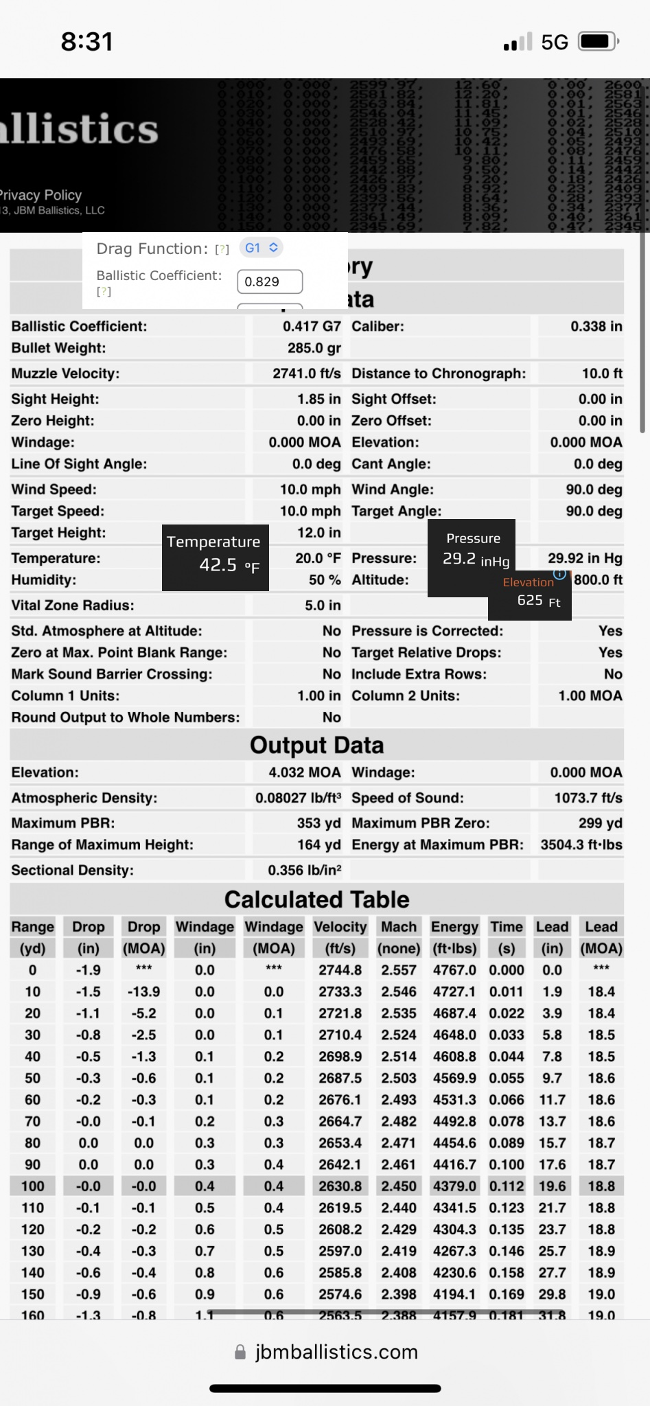

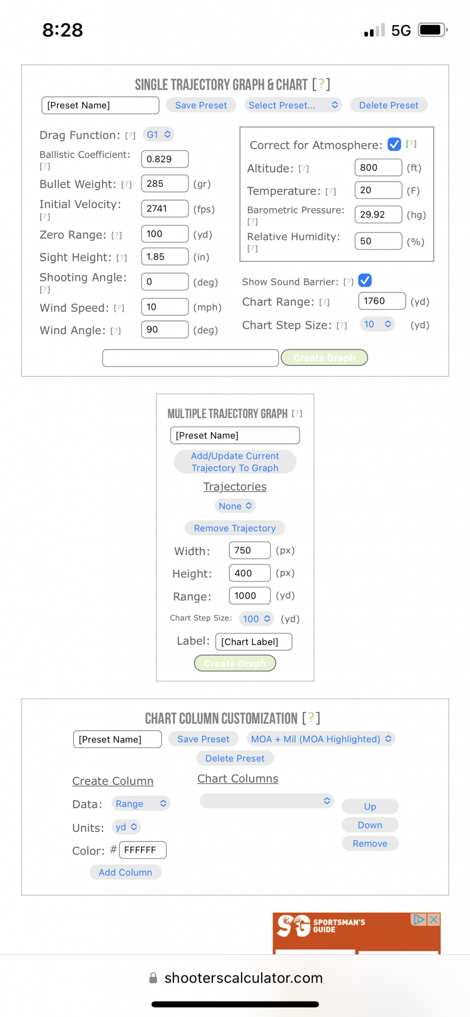

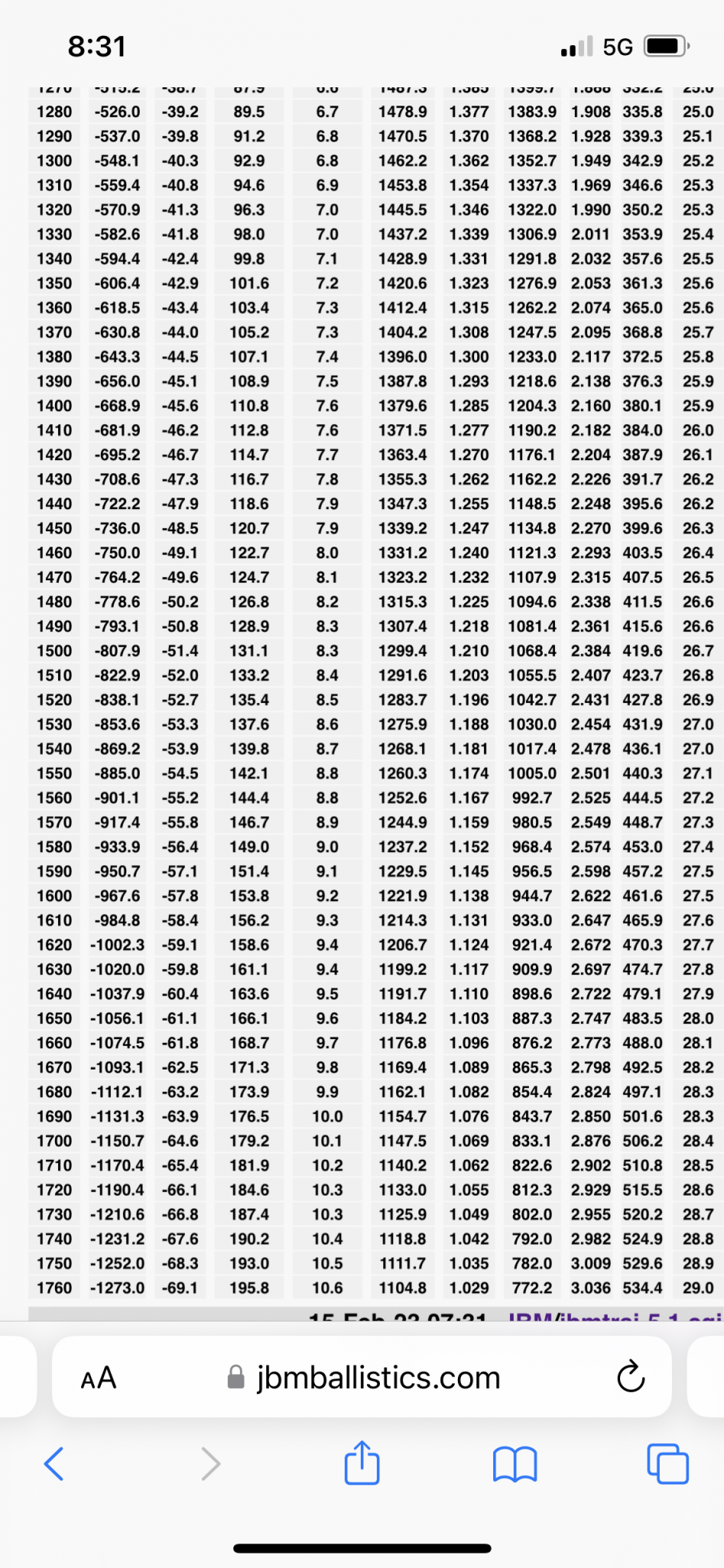

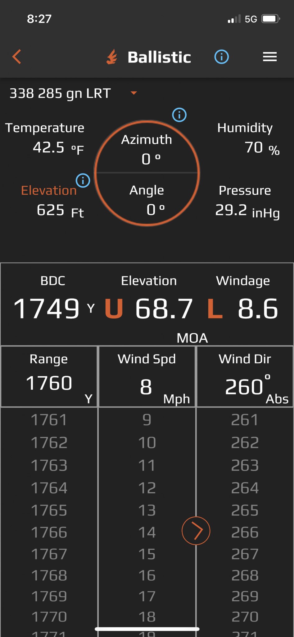

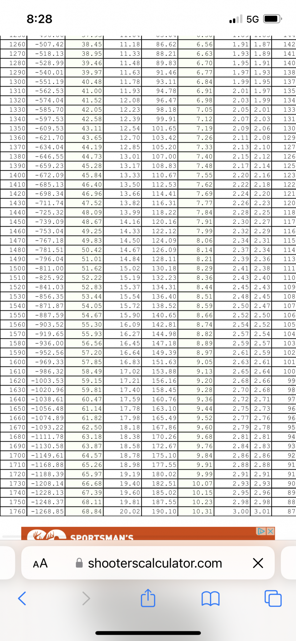

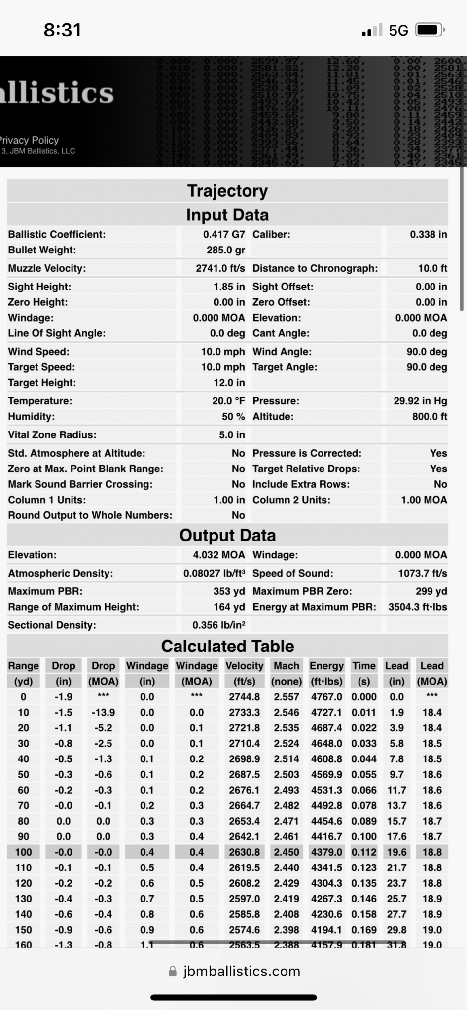

I’m not trying to be difficult and I am very green to ELR. So if I sound like an idiot it’s probably because I truly do not know. But heres the calculators that I use. Revic and jbm are my usual go to. The third one is a random one I used just to see. All three call for 69ish moa. Actual hits were 82 moa. 20 degree day 5-6 mph wind coming from 7-8 o’clock. I think I was holding 6 moa for wind but don’t really remember bc I didn’t write that down.
338 lapua, 285 gn eld-m, chrono avg 2741 fps,

Posted some screen shots and enviro
I can't find the error. What are the odds your MV is actually 2541 fps? That'd do it but also not lining up at 1000 yards.
Unless that bullet is tumbling once it goes trans? but that doesn't happen consistently enough for reliable hits at a mile.
@secondofangle2 looks correct to me, G7 OF .417 and G1 .829 seems weird to bounce around like that but what ever.
If you use .8 as the g7 instead of .4, the difference is 15 MOA low at 1760
And part of his problem is that that calculator is a POS and not intuitive. No wonder a Newb gets lost in that mess of inputs
There's all kinds of inconsistencies in these numbers...not sure what I'm looking at.
Ya but that doesn't account for his actual dope being 82 moa.
@ma smith Ya his numbers a whacked but those aren't going to equate the error he is talking about, unless there is another one some where.
Oh yeah I see you’re right. He should be about 65 MOA for that shot. But we did find the problem. His ballistic calculator is a POS and not user friendly. Time to get TRASOL (if he has iOS). Or AB.
That’s my hypothesis. His screenshots show both g1&g7. It just so happens if you put in .81 and call it the g7 BC the error is 15 MOA almost exactly the reported error
Plus, there are few other input errors that would cause an output error that large.
So the first order of business is to unfuck the BCs and see what the output is then.
