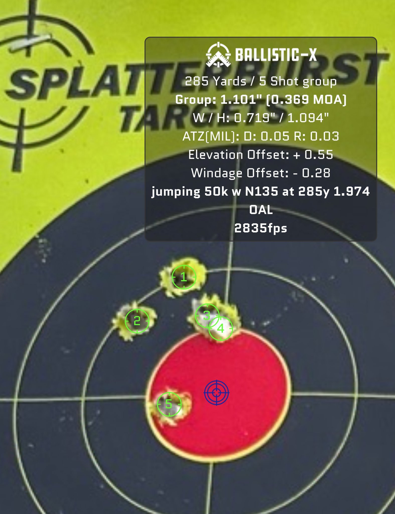

    I , and just about everyone else I’m shooting alongside, seems to struggle getting ragged holes with these bullets. Now keeping mind I’m jumping 30/1000 at mag length so after all my testing , I always find my best OAL is 1.974 so 15/1000 is not an option for me. Marks SAC shop cut this barrel the same as all his PRS TAC shooters. So if we can assume I can’t chase lands. What else can I do to help.
    Right now, I’m not in too bad of shape. I’m thrilled with my last test, I had 3/8 moa, at 280 yards. Thank God for that, but will it stay here is my question and if I use longer necks will it help me AT ALL ?
