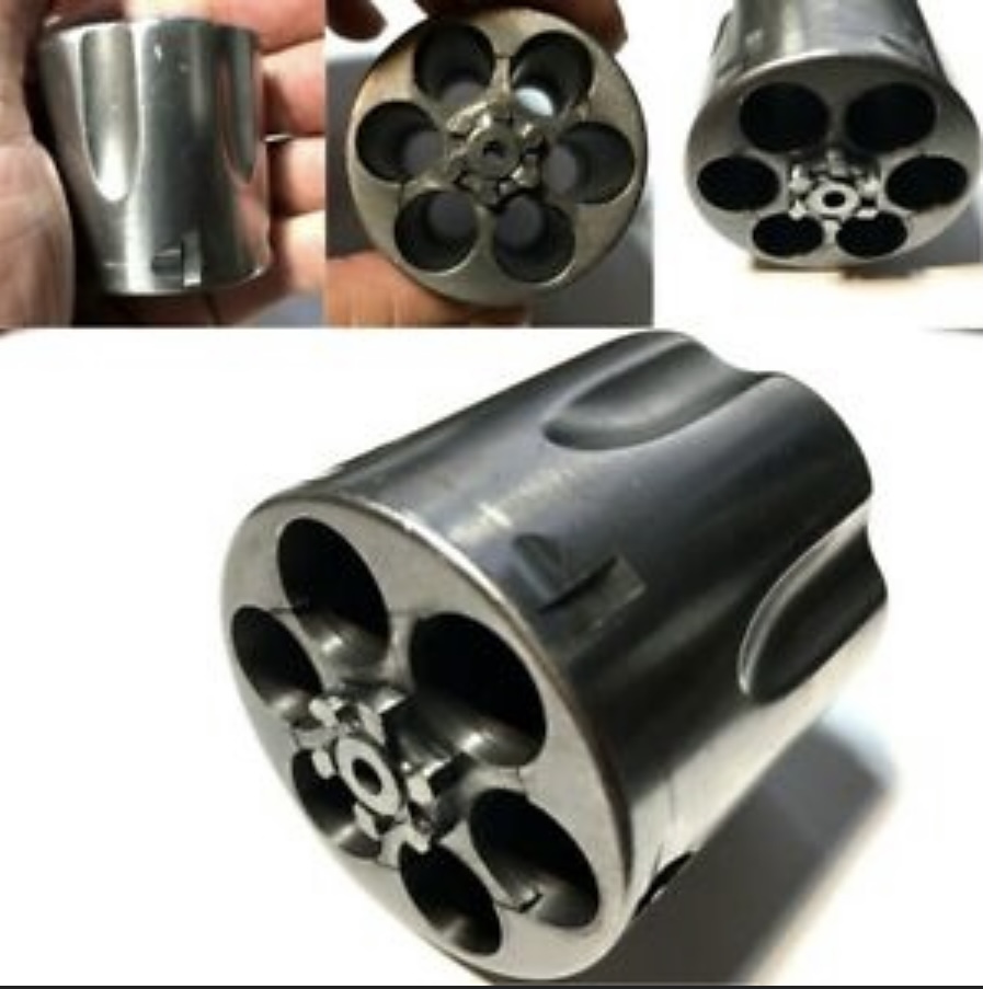

Look at a FN 5.7 carbine barrel? Or look at a cylinder wall of a large caliber revolver like a .44 mag. At its thinnest point, that cylinder wall is only about .060-.080” thick. And it is milled for the lock right at the thinnest point.
