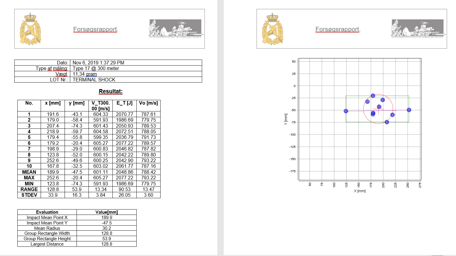

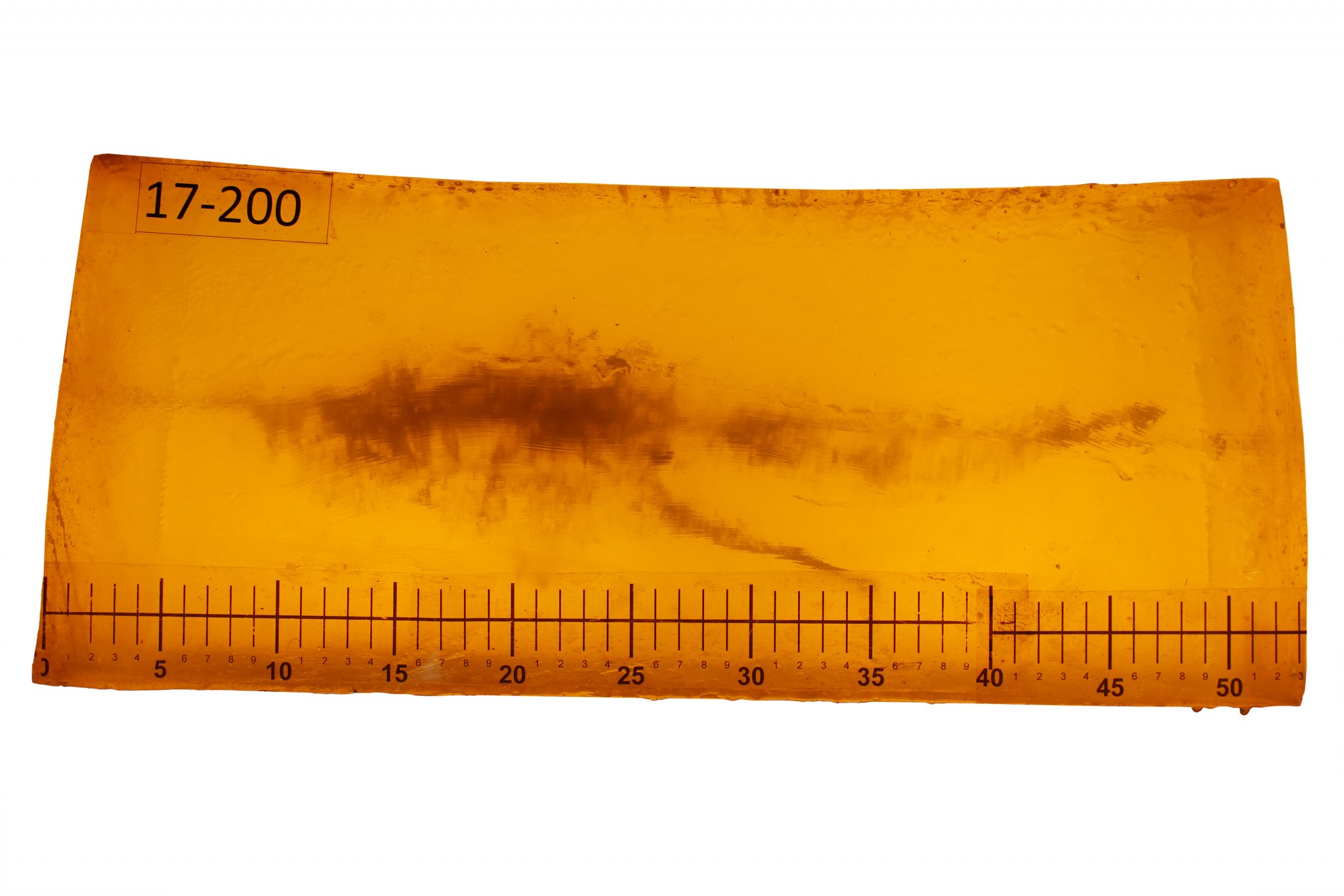

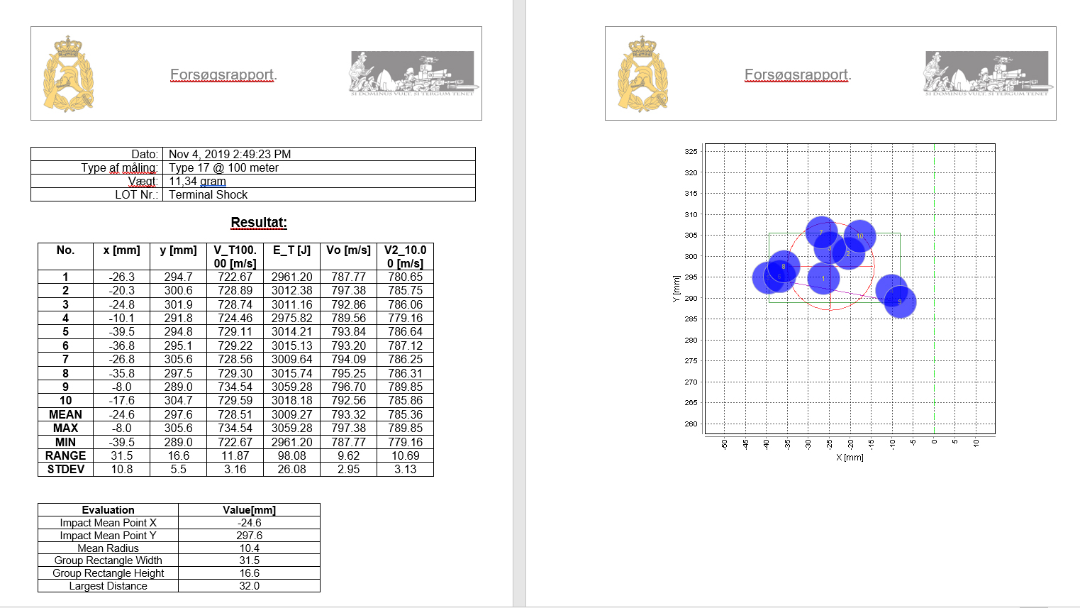

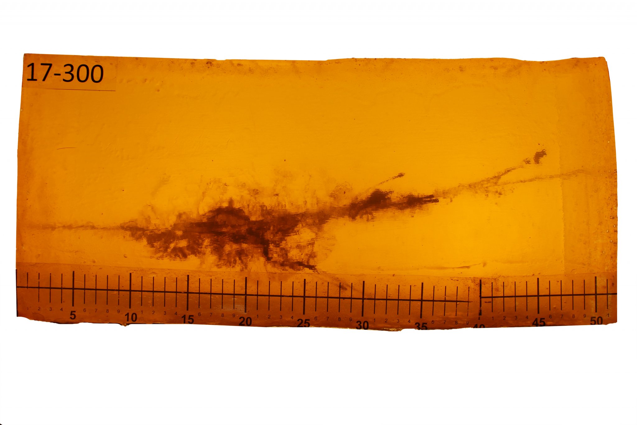

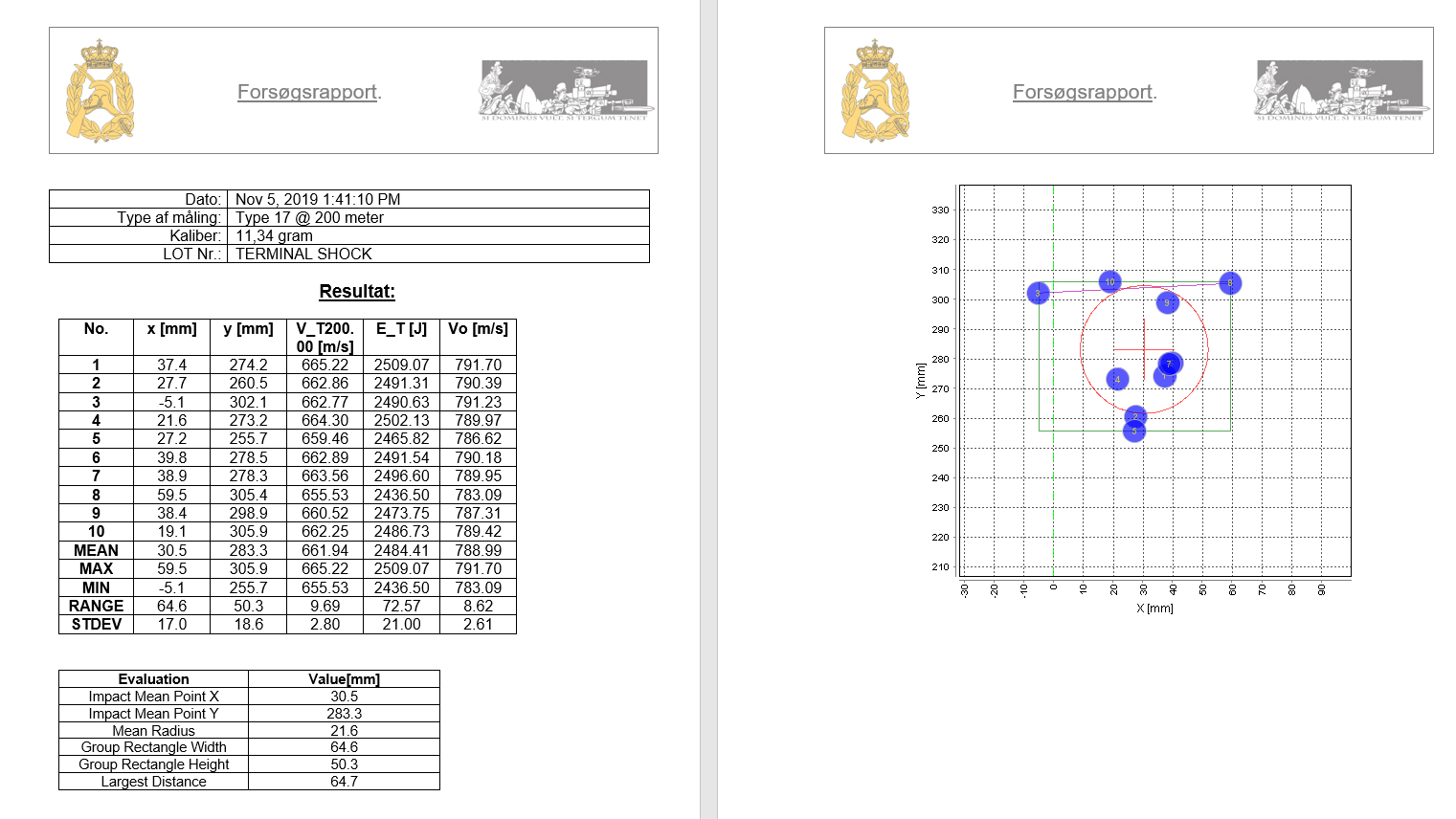

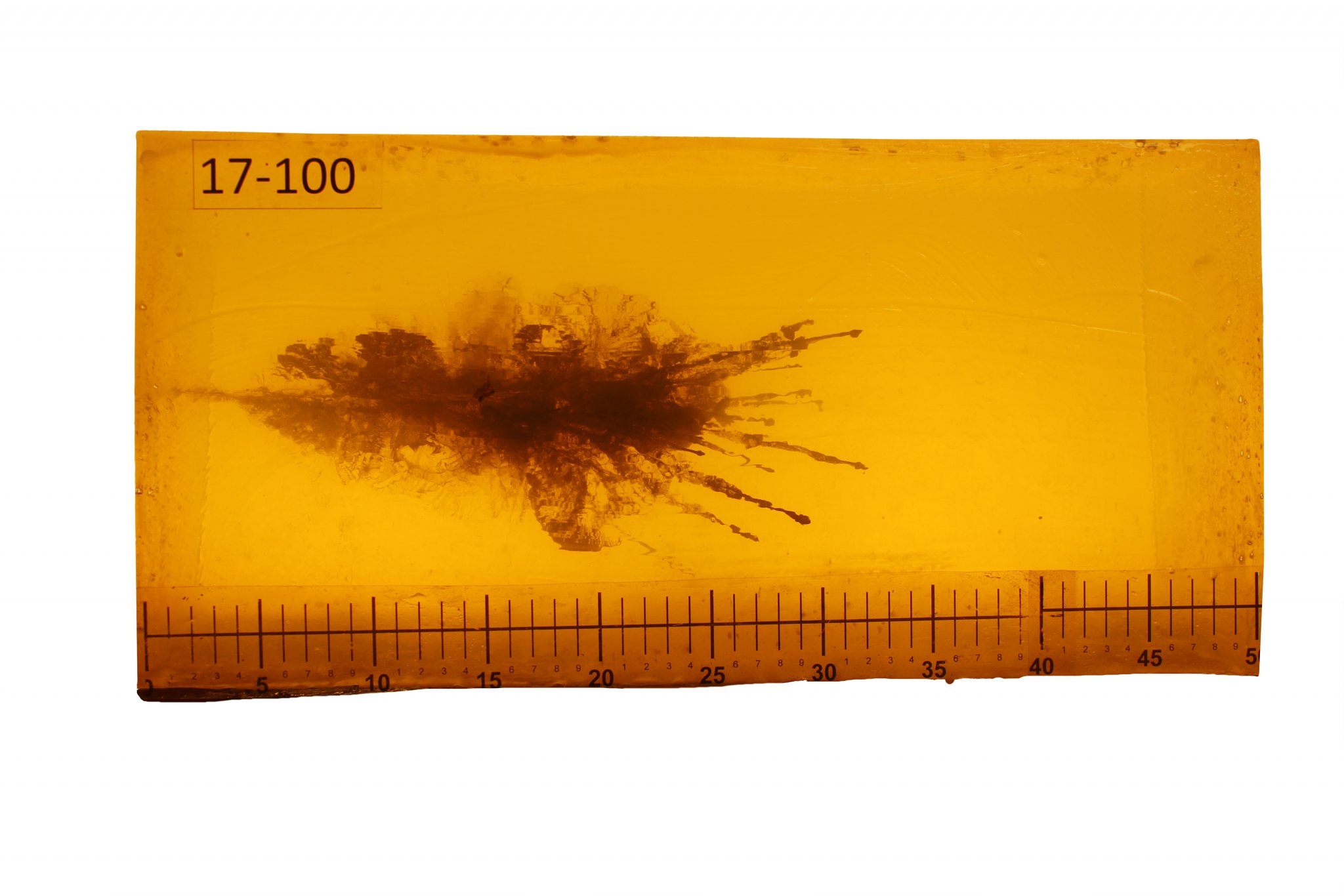

I'm sort of leaning up against the DRT test results that the Danish Army and Danish Hunting association did a few years back. It's close to the 2100 FPS statement, with the possibility of slightly lower minimum expansion speed.
Measurements are in cm.
I guess I would have to to make a 10% gel block and test the MPG at the range at 300m just to be sure :) Could be fun.

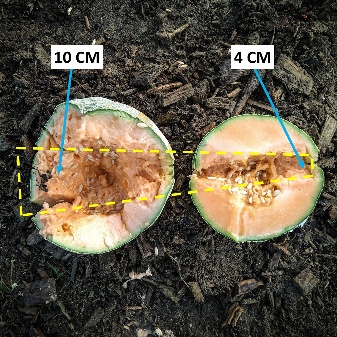

Using the less than precise cantaloupe medium at 100 meters did indicate effectiveness of the 140gr Barnes MPG.
