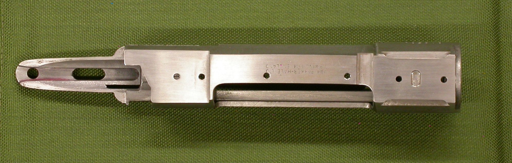

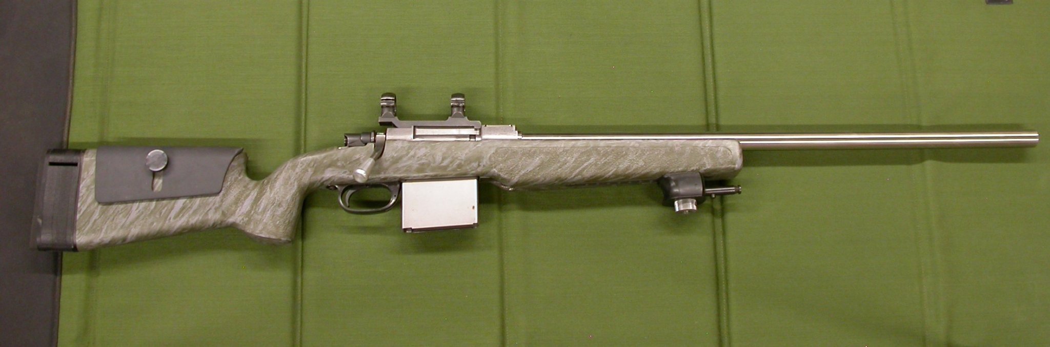

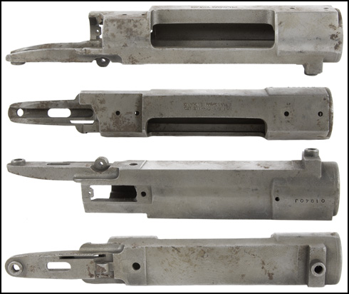

A while back I got the bug to build a C3A1 clone from one of the PH M84 single shot receivers floating around out there.
Well, that's when the search for parts started to get real interesting. At this point, all I had was the receiver in the condition you see above. After many months, I was able to locate a few parts from the US, UK, and Canada. The big challenge has been the bottom metal. I was only able to find a trigger bow, mag catch, and screw. Finally I got a big break on Ebay with finding 2 magazines that were unfinished. Basically the main mag body was formed and welded, 2 spacers, and the bottom metal. No springs or followers.

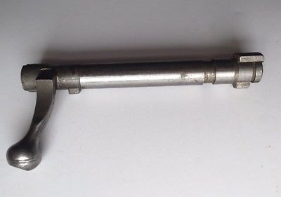

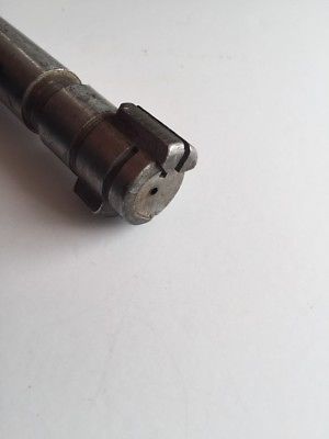

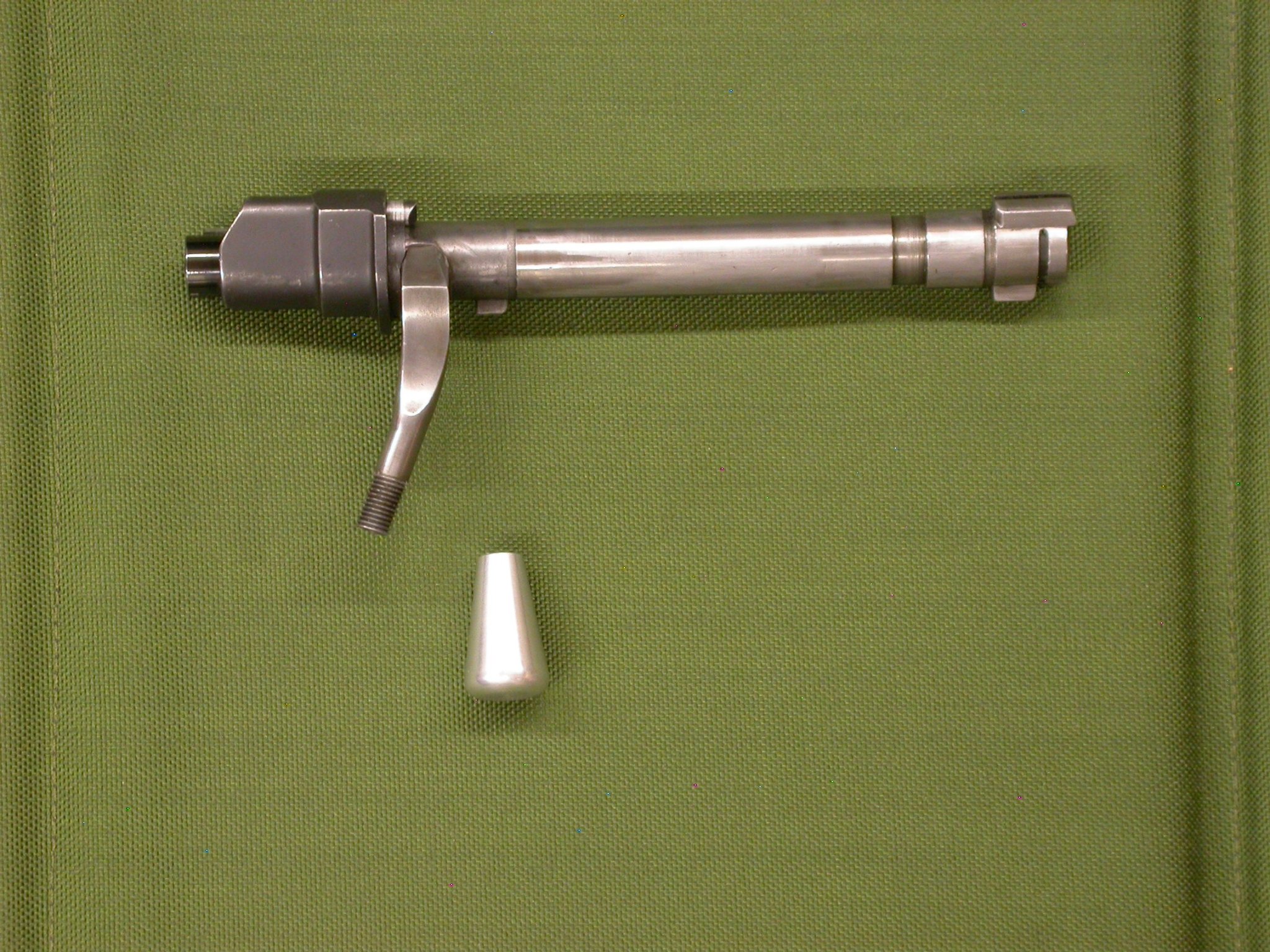

After what seems like a year or more I was able to locate a bolt!

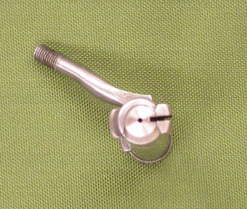

It took a while to find the correct bolt. Apparently one of the lugs is longer, which is different than your standard mauser-style. This is when my excitement turned to major cluster fuckage. This bolt was not finished at the factory and I soon found out why. It became clear that during the machining, the firing pin hole was not in line with the center axis of the bolt. I decided to move ahead and threaded the bolt handle to accept a C3A1 syle knob and bushed the firing pin hole to bring it into alignment.
That is an ambitious project here in the US. Good luck to you and glad you got the bolt fixed in the process. Keep us posted.
While working through each challenge and researching any information I could find, it became apparent that some of these receivers may not have been heat treated sufficiently. I could tell from working on the bolt that it certainly did not have the appropriate hardness. I connected with a local metallurgical testing company and they were kind enough the help me out. Good and bad news. The receiver tested out at 43 HRC, the bolt.....a whopping 8 HRC. No problem, just send the bolt for heat treating, right? Well for those that may not be aware, the heat treatment technicians need to know the exact composition of the alloy if you're going to have a shot at obtaining the hardness you need. I tried calling Parker Hale, but no answer ;) Once again, the metallurgical experts to the rescue! Enter the amazing world of XRF, or X-ray fluorescence spectroscopy. Using XRF, they were able to determine that the bolt was 4140 (I need to check my paperwork to verify). Off to heat treat, and it came back 43-45 HRC!

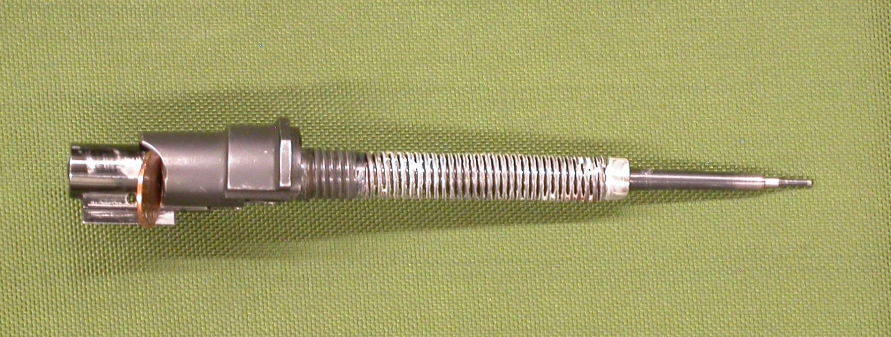

Bottom line. Everything is off on this mother $#)%(@! But, after many hours of struggling, head scratching, researching, we're getting somewhere. I fully admit that the juice may not be worth the squeeze. But, the whole point of this exercise is to learn, and there is a metric shit ton of learning being done.
Come to find out that the firing pin, mainspring, cocking piece assembly is off center as well due to the misalignment of the hole in the bolt body. I fiddled with the firing pin forever to get it to move without binding. It is something on the order of 0.050" eccentric from the base of the firing pin (where the spring stops) to the tip.

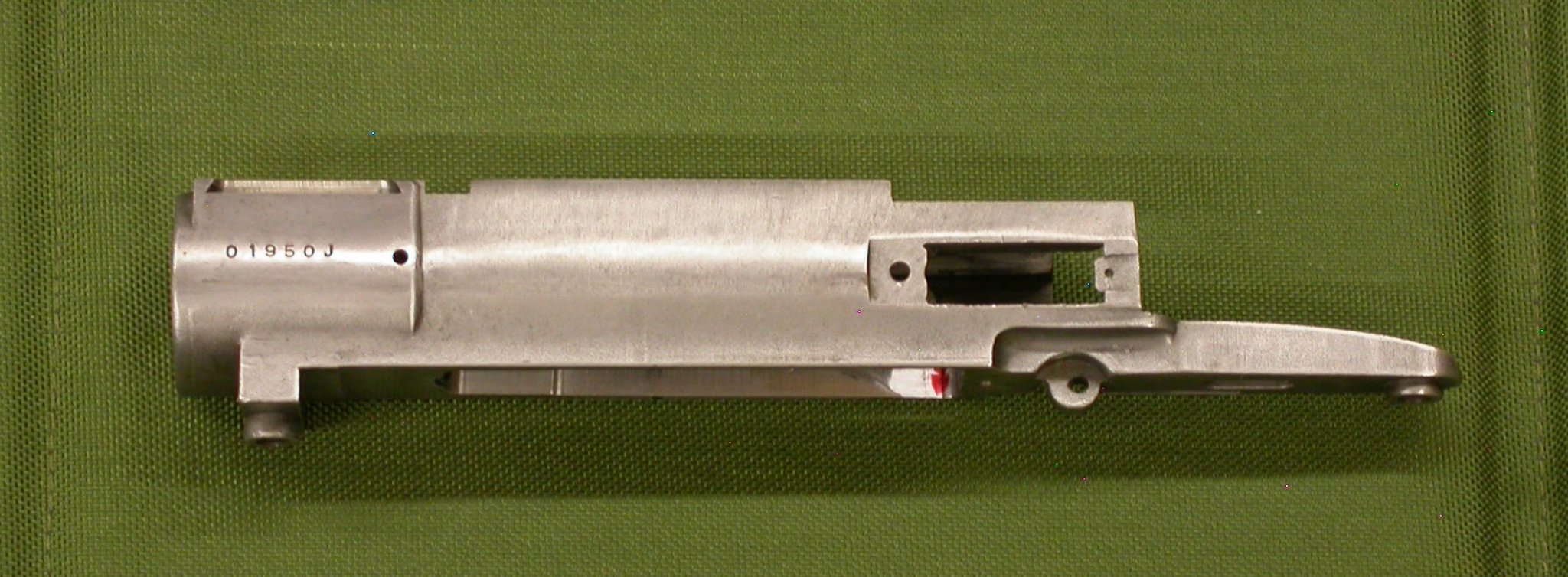

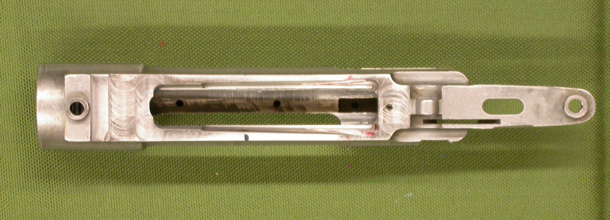

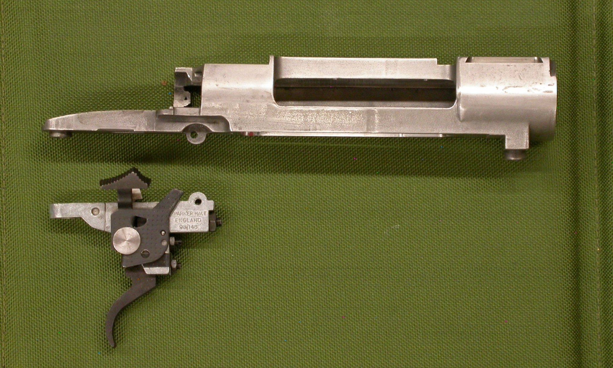

Trued up the top and bottom of the receiver, milled in the slot for the scope base, including the dovetails near the front of the receiver. Opened up the mag well. That geometry is a royal bitch!

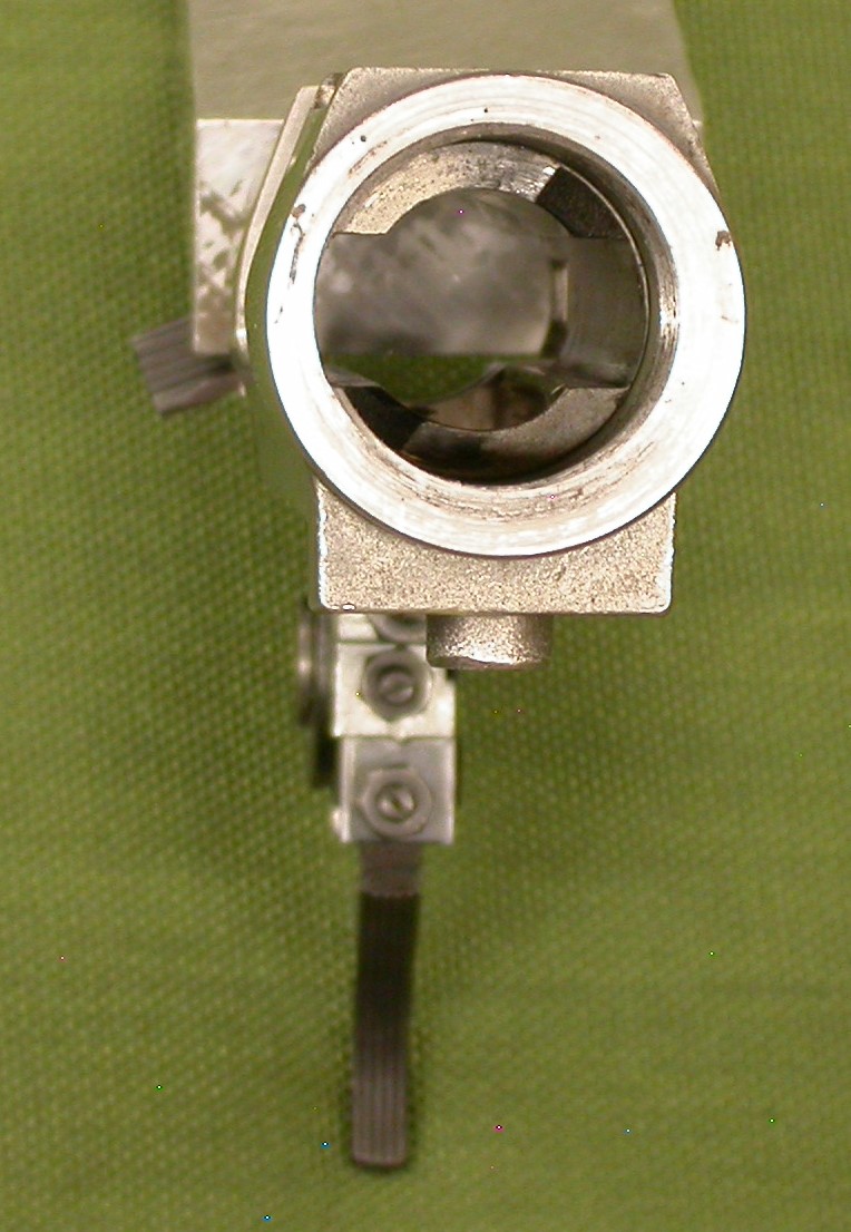

Trued up the threads and face of the receiver, best I could. You can appreciate how off center everything is. Hence why machinists with vastly more experience and knowledge decided to scrap this. And here I am trying to give this thing life. Idiot!

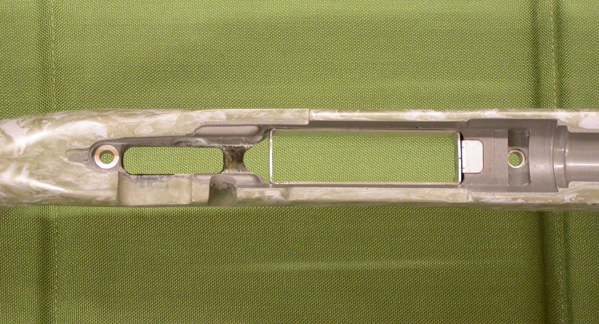

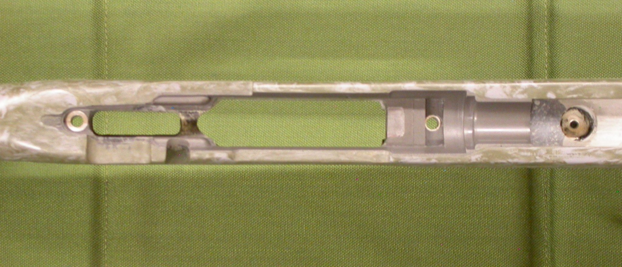

Got my barrel back from PacNor and proceeded to thread/chamber. Worked out some pillars and completed the bedding. Even the pillars were a pain in the ass. I had to keep in mind that the rear pillar does not contact the receiver directly because the rear portion of the trigger is between them. Yeah, my thoughts exactly. How the hell do you bed this ?! Decided to make the rear pillar with a sacrificial portion to hold the spacing while bedding and then milled off the exact amount for the trigger.

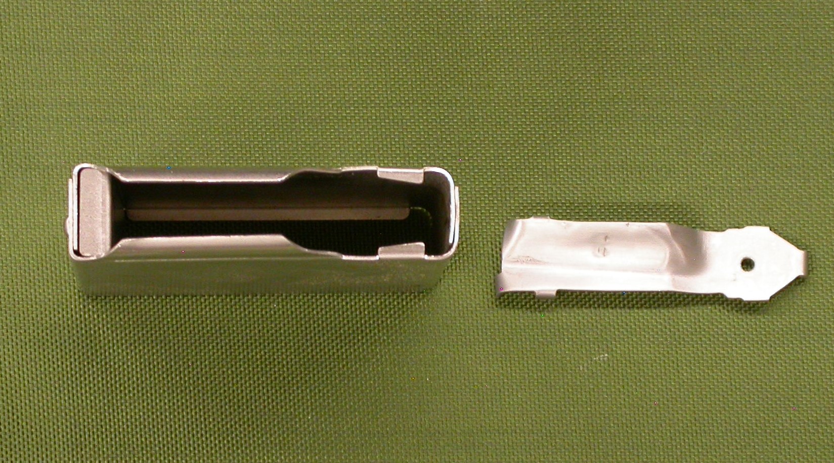

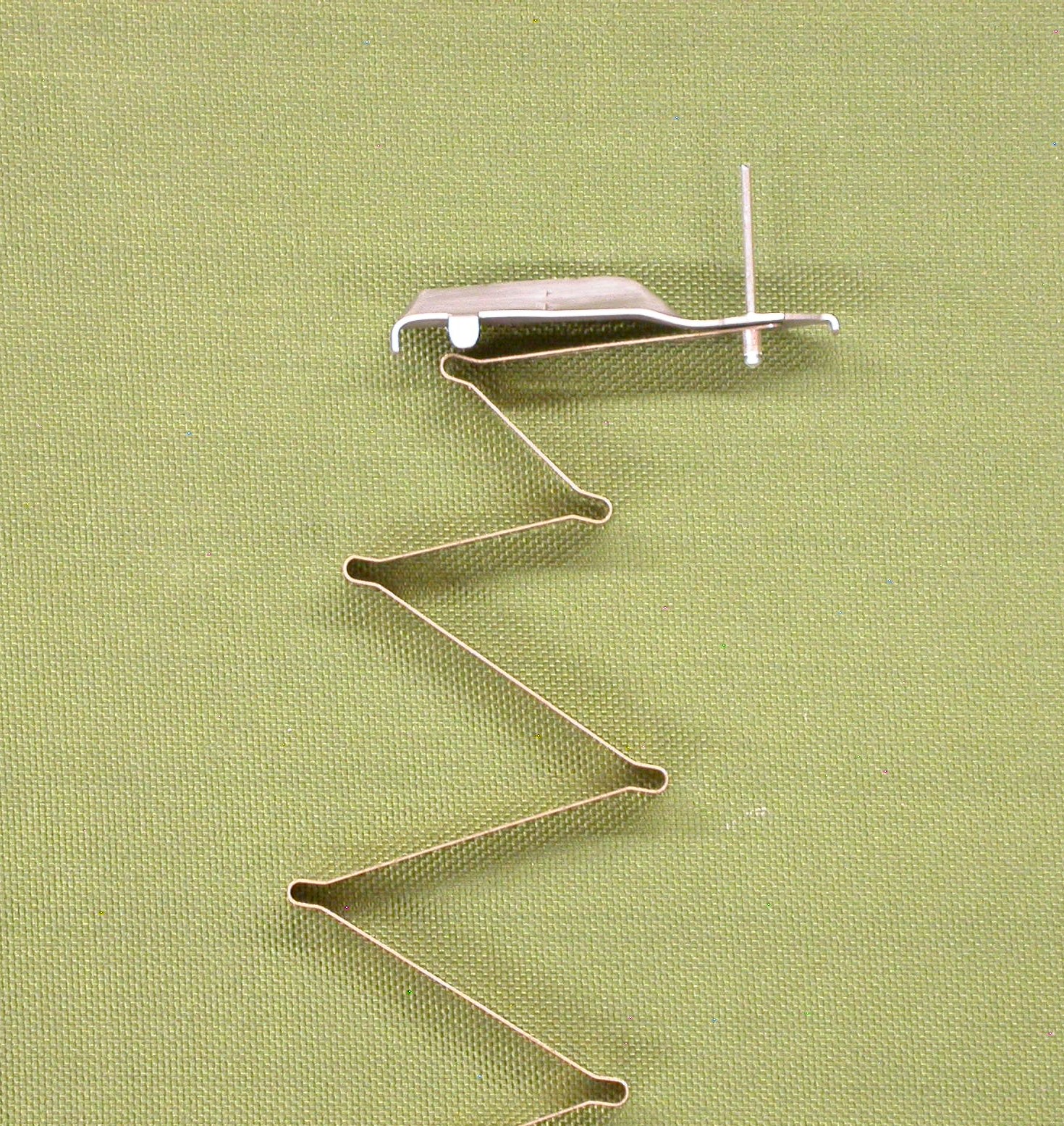

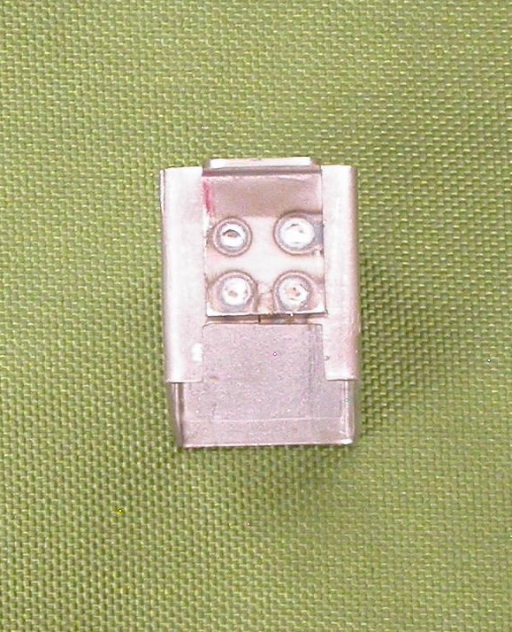

Made the mag box from scratch using photos. Also fabricated the front portion of the bottom metal that secures the receiver front. The real fun was trying to make a follower from scratch. I'm using a spring from another magazine that I will secure to the follower with a rivet once parkerizing is complete.

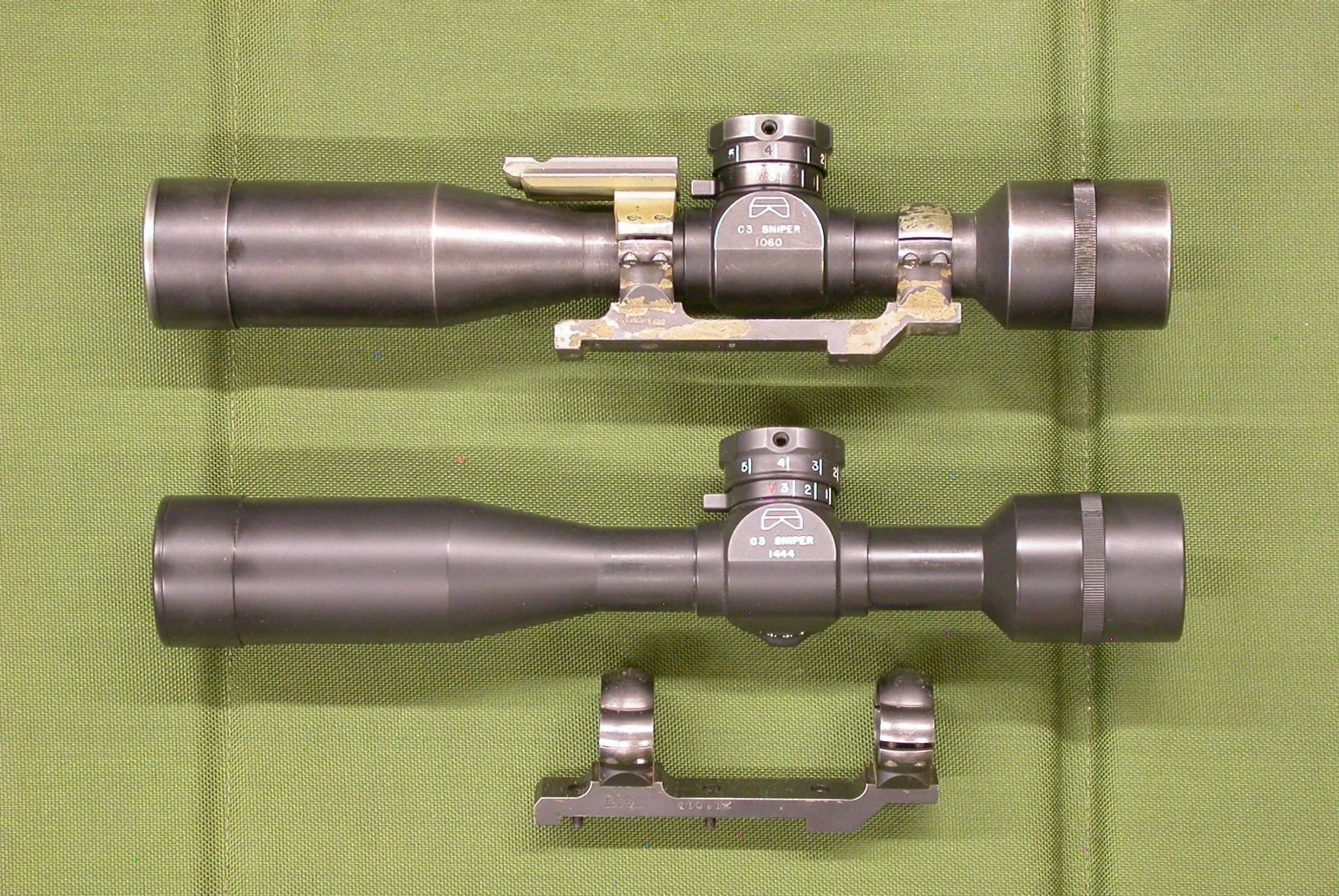

Those Canadian Unertl's are neat, I've never seen one in the US, and you have two of them(!)

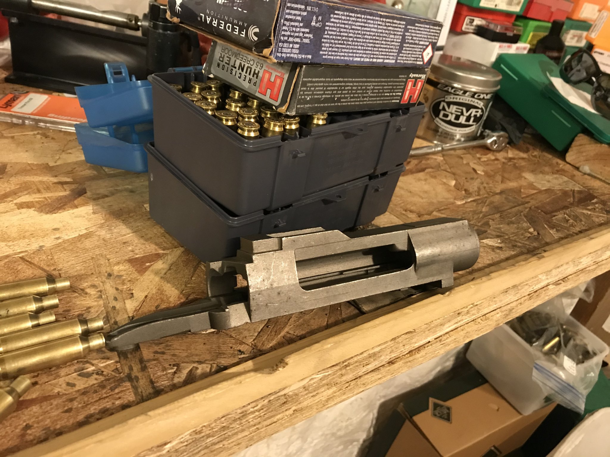

I just bought the casting for the M85. The next step after the C3A1. I have a feeling I'm going to be busting all the myths you did as well. I however, do not have immediate access to a metal shop.

I forgot to ask one question about the C3 scopes: How many meters out is the BDC marked on those Canadian Unertls? (Does it go to 8, 9 or 10 on the dial? Just curious, as the USMC scopes went to 1000 yards, but that's only 914 meters, hence the question.)
