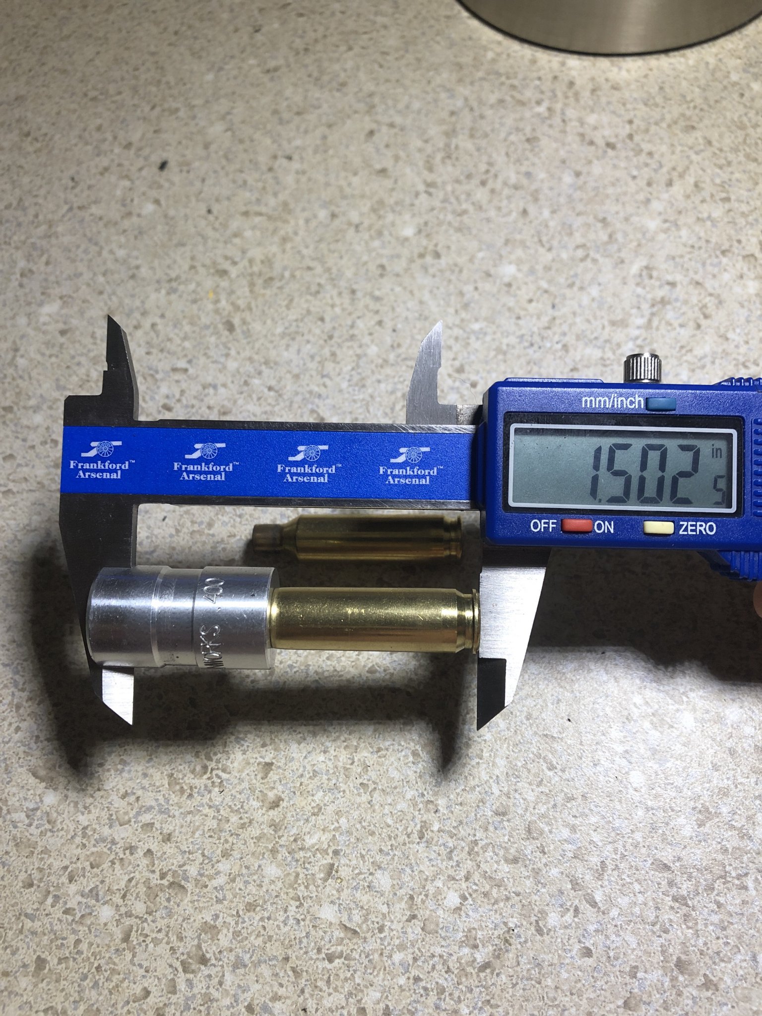

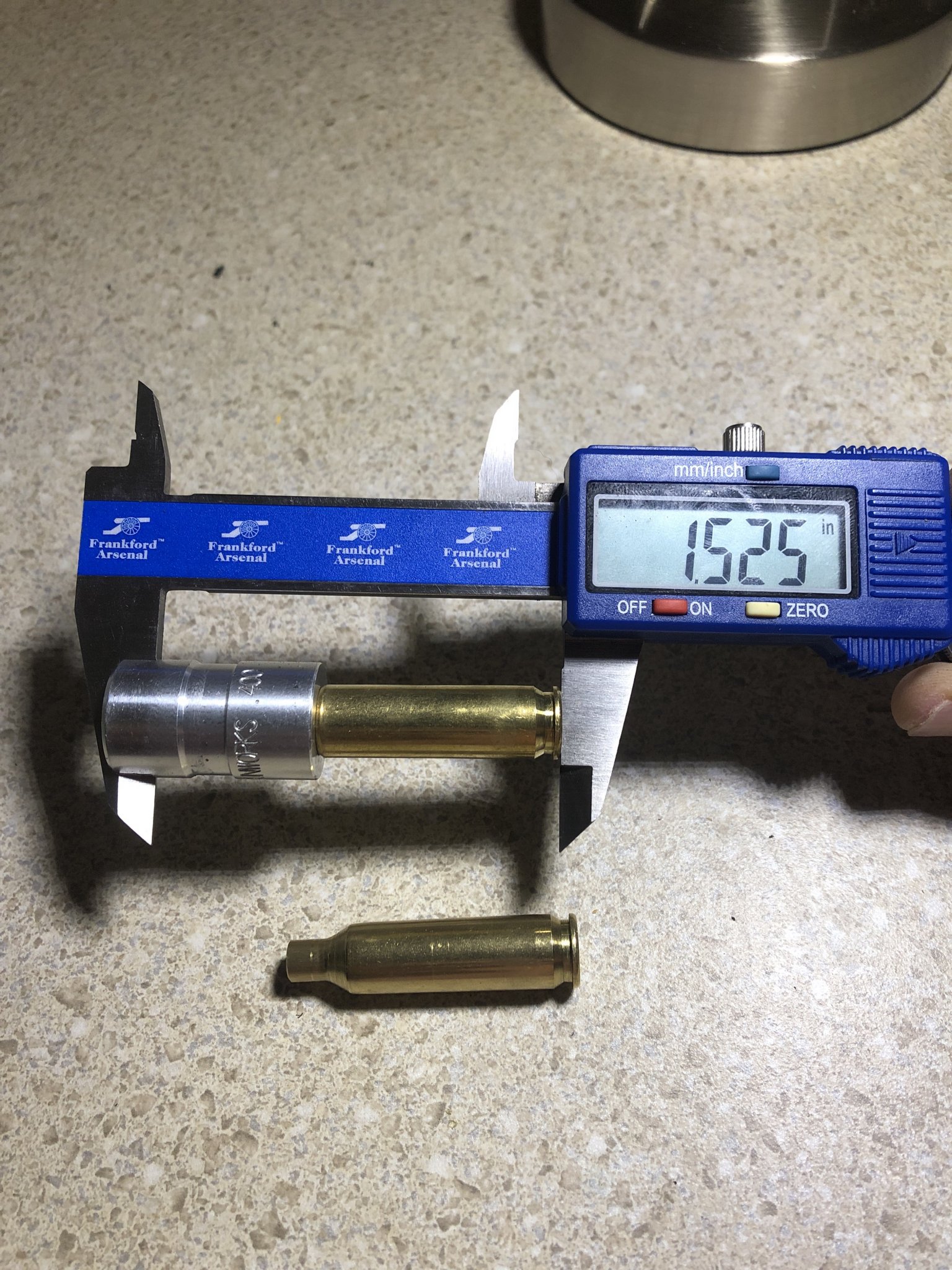

I am pretty new to reloading and very new to precision dies. When I was setting my die I set the shoulder back by hundredths instead of thousandths. I trimmed and primed but when powdering I saw my original notes and the measurements didn’t match. I pulled an unfired case measured then measure one of my sized cases. Sure enough I’m a moron.
Question is now what? Chunk the brass and start over?

You are basically going to need to fireform your brass - it’s a common thing with “improved” chamberings like AIs, Dashers, etc.
Probably still OK, but as stated above you’ll either need to load them long into the lands or utilize another FF method (COW or false shoulder).
Bottom line is, brass can still be salvaged with a little work. Then again if it’s Hornady or something cheap/easily replaced... probably not worth the hassle.

Thank you for the replies. It is 6 creed hornady brass and if I need to fireform it and jam the lands I would rather pitch it and save the barrel another 100 rds.

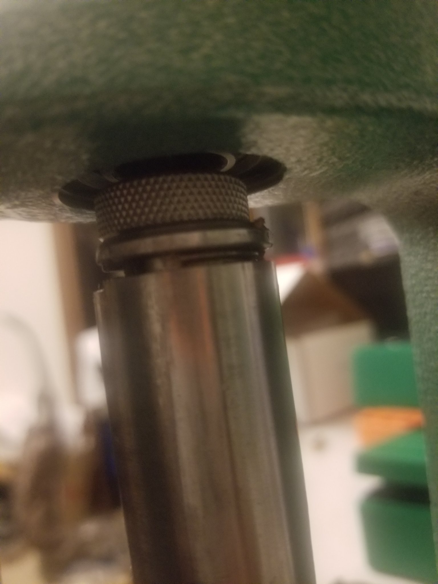

I have been reloading for 25 years and have used dies by nearly every manufacturer and have yet to run into one that will bump a shoulder .020”
When I did something similar ('cept I think mine were .040 short) it was a bit of... uhhhh... well, let's just say "stupidity," in regard to a Lee FCD that was the culprit. YMMV.

I have one that would easily do what he's describing. It has a pretty good gap between the shell holder and the die with a .002" bump.
You only want about .002” of bump so if your fired dimension is 1.525” then ideally when you size it the shoulder will be 1.523”.. when i go through this process i check at least 5-6 fired cases and get a average measurement and then set the die up for about .0015” setback. That leaves me a little wiggle room for lube variance and what not. If for some reason i dont bump the shoulder as much as i want because of running the press differently or whatever then the brass will still be bumped .0005” or close to it... the worst you will notice is a little tightness in the bolt when closing it in most cases... the important thing is to lube the brass the same way every time and run the press the same way every time. Consistency is the key to both LR shooting and reloading.

I doubt he’ll have problems with a die like that. I have a couple that are similar. Everything above the web is still supported by the die.
Guys, including myself, have sized brx with br does for years. That’s .100” difference.
