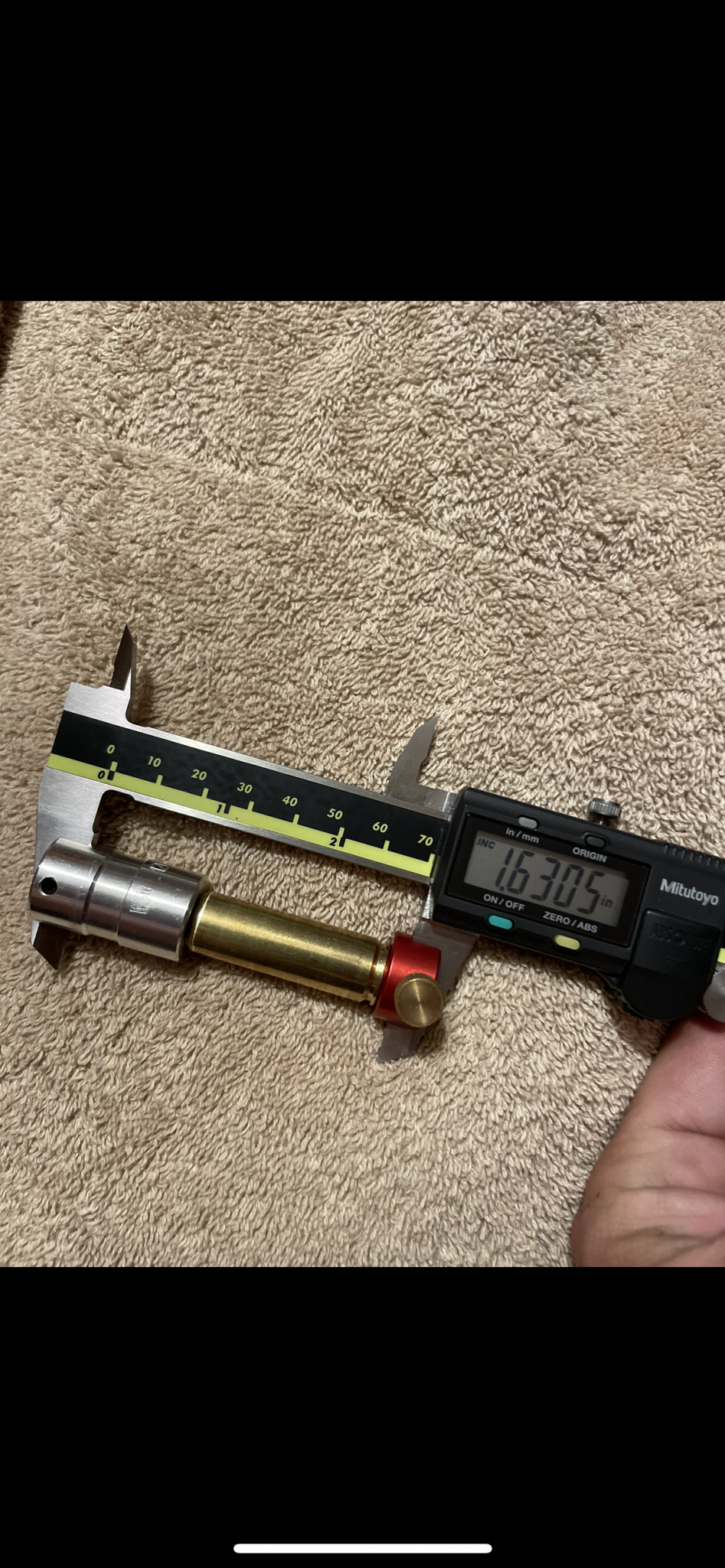

    Been running the Toyos and anvil base for a good while. Easy, smooth, and consistently accurate to the half-thou. When I first got them I’d occasionally double check my measurements with my Starrett micrometer… until I learned I didn’t need to. Yes… they’re worth every penny.
    Edit- Like someone mentioned above don’t look for a “great deal” unless you want a pos counterfeit tool. All authentic Mitutoyo calipers come with a real-deal Japanese SR44 battery. I still haven’t seen a fake that didn’t have some Ching Shinn or equivalent trash battery. I get my measuring tools from MSIViking.

    5. I use a Hornady anvil and for me, it works great!
